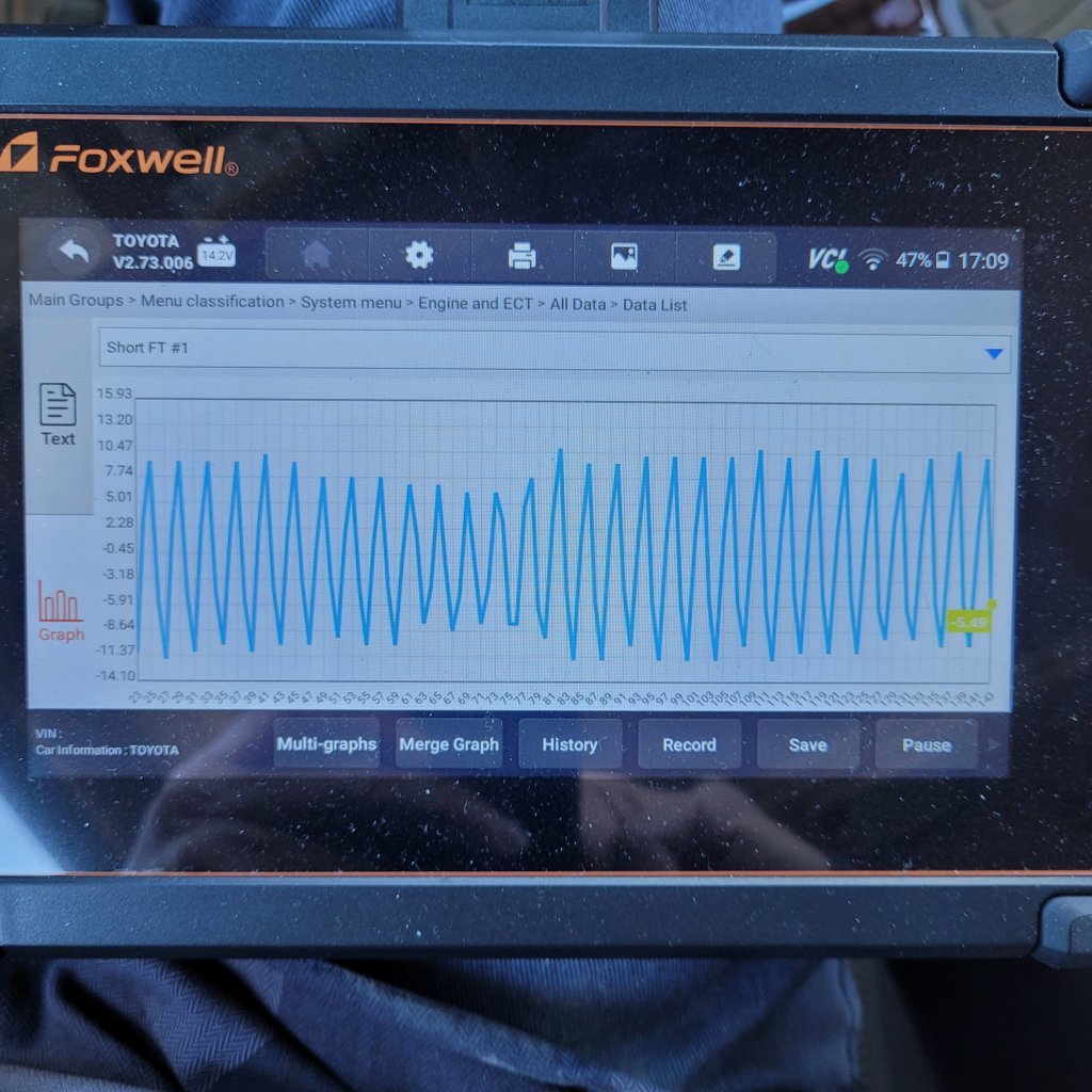

    These are some of the numbers and I will try to attach a screenshot of the short term:
    Long FT -1.59
    Short FT fluctuate -9.5 to +8.7
    MAF idle 4.6
    MAF 2500 17.5
    ECT 180°
    O2S B1 S2 .740
    CygnusX-4 likes this.
  10. Mar 2, 2025 at 9:36 AM
    CygnusX-4
    CygnusX-4 Member
    Feb 26, 2023
    #31476
    191
    21 TRD OR
    That looks like you might have a dirty MAF. Remove it and look at the sensing wires closely. That can easily be cleaned if so. The MAF should be approximately 3.5-4 g/sec idle and about 12.5-13 at 2500. Those short terms fuel trims should be steady and close to zero at idle. Is that graph at idle?
  11. Mar 2, 2025 at 9:49 AM
    Chander
    Chander [OP] New Member
    Aug 25, 2024
    #42402
    12
    Chris
    New Jersey
    2000 Siver limited 4Runner
    I did clean the MAF sensor when the intake was off. Yes that graph was at idle. The long term fuel trim was steady at that value.
    Did you mean to say long term fuel trim should be steady and close to zero?
    If you need a graph at rpm, let me know.
    I will take another look at the MAF sensor to see if something didn't get on it during reassembly.
  12. Mar 2, 2025 at 10:02 AM
    CygnusX-4
    CygnusX-4 Member
    Feb 26, 2023
    #31476
    191
    21 TRD OR
    They both should be close to zero, but the short term is what's happening now, the long term is cumulative. Make sure you clean the little sensing wires deep in the cavity. Those are the ones that are going to cause erratic fuel trims, not the big bulb looking thing that's easy to see.

  13. Mar 2, 2025 at 10:57 AM
    Chander
    Aug 25, 2024
    #42402
    12
    Chris
    New Jersey
    I pulled the MAF sensor out of the air box and cleaned, didn't visibly look dirty.
    Idle numbers are 4.1 to 4.3.
    2500 rpm numbers are 16.7 to 16.2
    Fuel trim numbers stayed similar to before.
