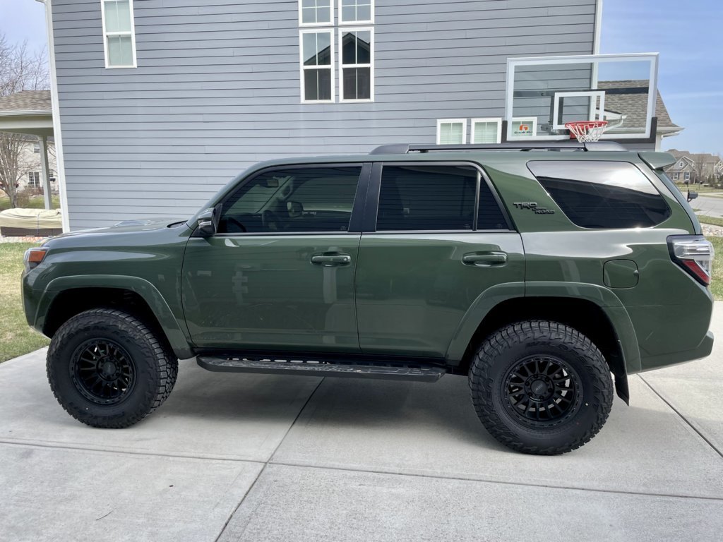

    Even though my Limited is a pavement princes it got 285/70R17. I didn't have much trouble putting them. I have the 285s on TRD offroad wheels. I only got a 2.5in lift and push the fender liner forwards. (Sway bar relocation thing included in the lift kit)
    For my TRD ORP I got 285s on TRD offroad wheels. I only got a 2.5in lift. I needed to cut the lower part of the front bumper and push the fender liner forward. I still kept the mud flaps. (Sway bar relocation thing included in the lift kit)
    I put 285/70R17 on my TRD Pro on stock TRD Pro wheels. Front side of the wheel well clears after cutting the lower part of the bumper and pushing the fender liner forward. But has rubbing on the mud flap in back of the front wheel well at a certain angle. At an angle just before a full lock. I think a mild lift with sway bar relocation thing should clear it.
    Edit -
    Adding a pic to temp you to drain your wallet in mods.
    BTW, I try to buy light weight tires so I don't get hit in mpg. Also buy Load C or Standard Load to keep the comfort level on pavement.

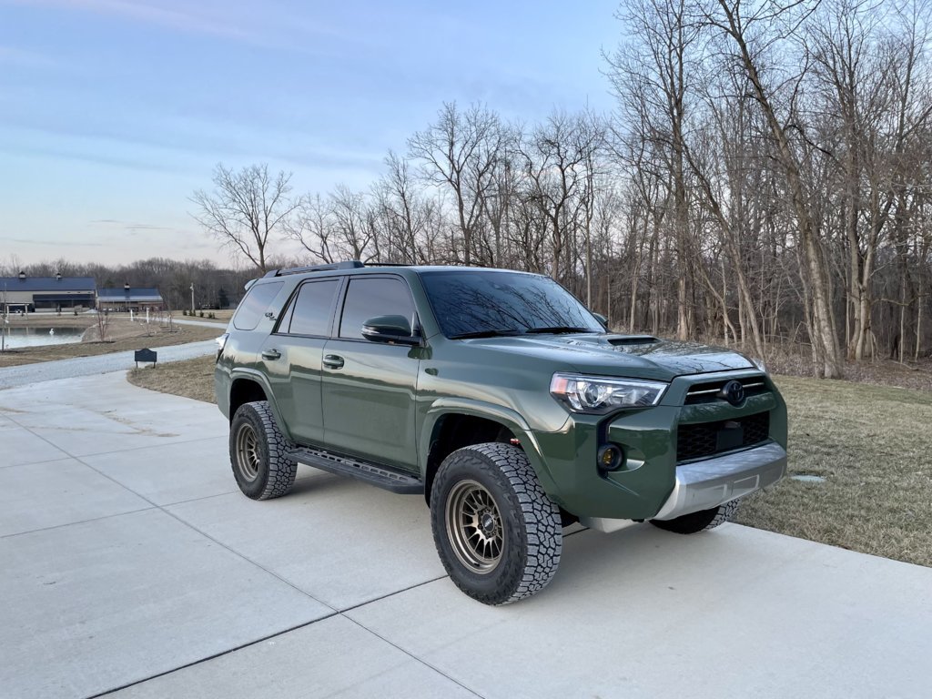

    Unless you offroad often and really need that small amount of extra clearance you get, then they are not IMO. With that being said, I am currently on 285s. lol
    I ran 265s for quite a while before I went to the 285. Both tires I ran are Wildpeak At3s in SL rating. The 265s, weighed a lot less (better handling & MPG) and required basically no trimming even with a -25 offset. The 285 does look a little better, thats about it unless you are off the road a lot.
    The first picture is the 265 with a 17x9 -25 wheel.
    The second one is a 17x8.5 wheel -25 offset.
    Suspension set up is Eibach 2.0 kit w/ JBA UCAs.

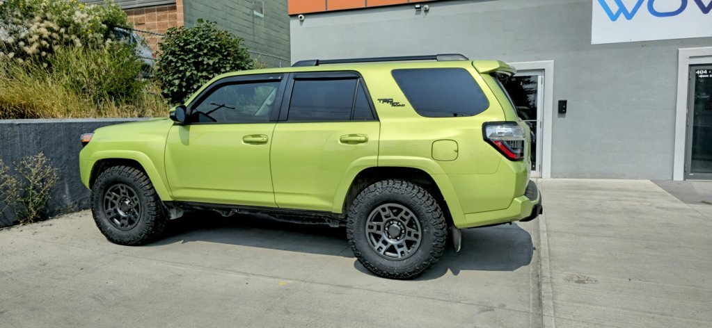

    I have 285/70r17 tires and I suppose the decision to go with this size depends on where you’re driving. I’m primarily on pavement, but I play in the Owyhee region of Idaho and Oregon. This area is very rocky and while the extra clearance gained is minimal, the ability of the larger tires to roll over obstacles was the reason I went the larger tire direction. I didn’t have to do a body mount chop, but I did shave about a half inch from the plastic fender on the driver side. I also get rubbing on the plastic mud flap when at full lock turn, but I just ignore it and haven’t bothered to do anything about it.
    If you want a visual comparison of stock size vs 285, the pic is new from the sales lot and built with a 2.7” lift.
    Also for comparison, this pic is with the 2.7” lift and 265/70r17 KO2s.
