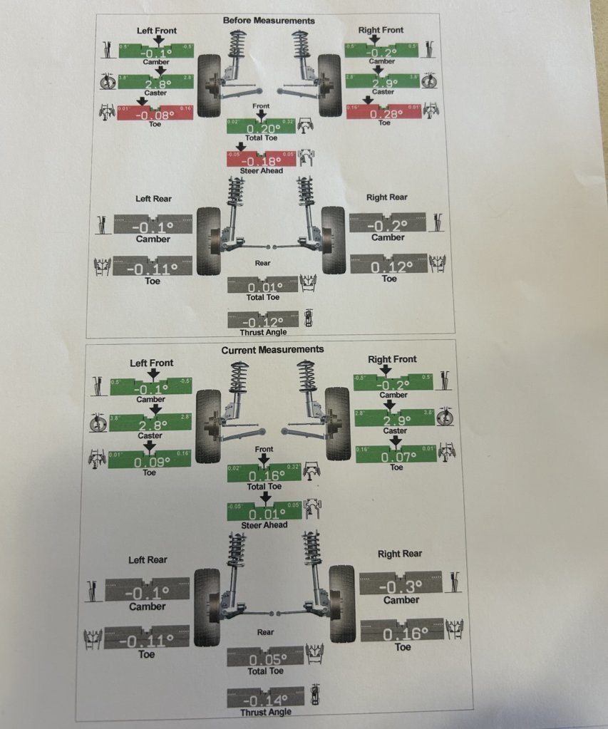

    Still haven’t driven it myself, the service manager is test driving again before giving it to me. However, the alignment they did yesterday was out of spec. I’ll be honest, I don’t fully understand the alignment numbers. Here is the printout that I specifically asked for beforehand. How do the new numbers look?

  18. Sep 11, 2025 at 7:04 AM
    2,019
    I wouldn’t expect misalignment like that to result in tough steering.
    RUNNER4DAN likes this.
  19. Sep 11, 2025 at 8:34 AM
    6,373
    That looks like a good solid alignment. I’d expect it to track slightly better because the toe numbers are more symmetrical. However, I would not expect any change in steering lightness while moving (because caster was not changed).
    If the steering seems to have consistent effort through its range, I wouldnt worry about it. Especially if you cant obviously feel a difference with the other 4runner you drove.
