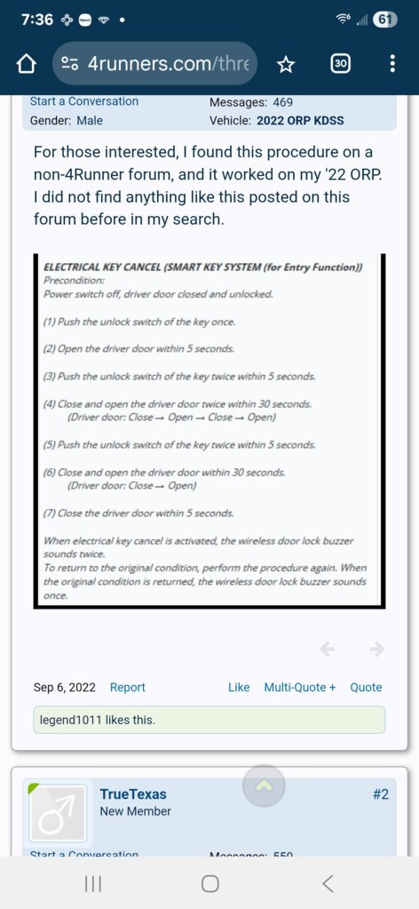

    Okay so we did find a solution to our issue where the remote still unlocks the doors but the proximity sensors when you approach and touch the 4runner doors does not work and the push start does not work unless you place the fob right on the push to start button. I found these on another forum and we did them twice first the double beep then the single beep at then end. Now everything works as it should again.Screenshot_20250615_193653_Chrome.jpg

    7,279
    Nice find. Hopefully the OP will check back in and give that a try.
