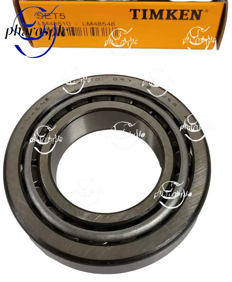

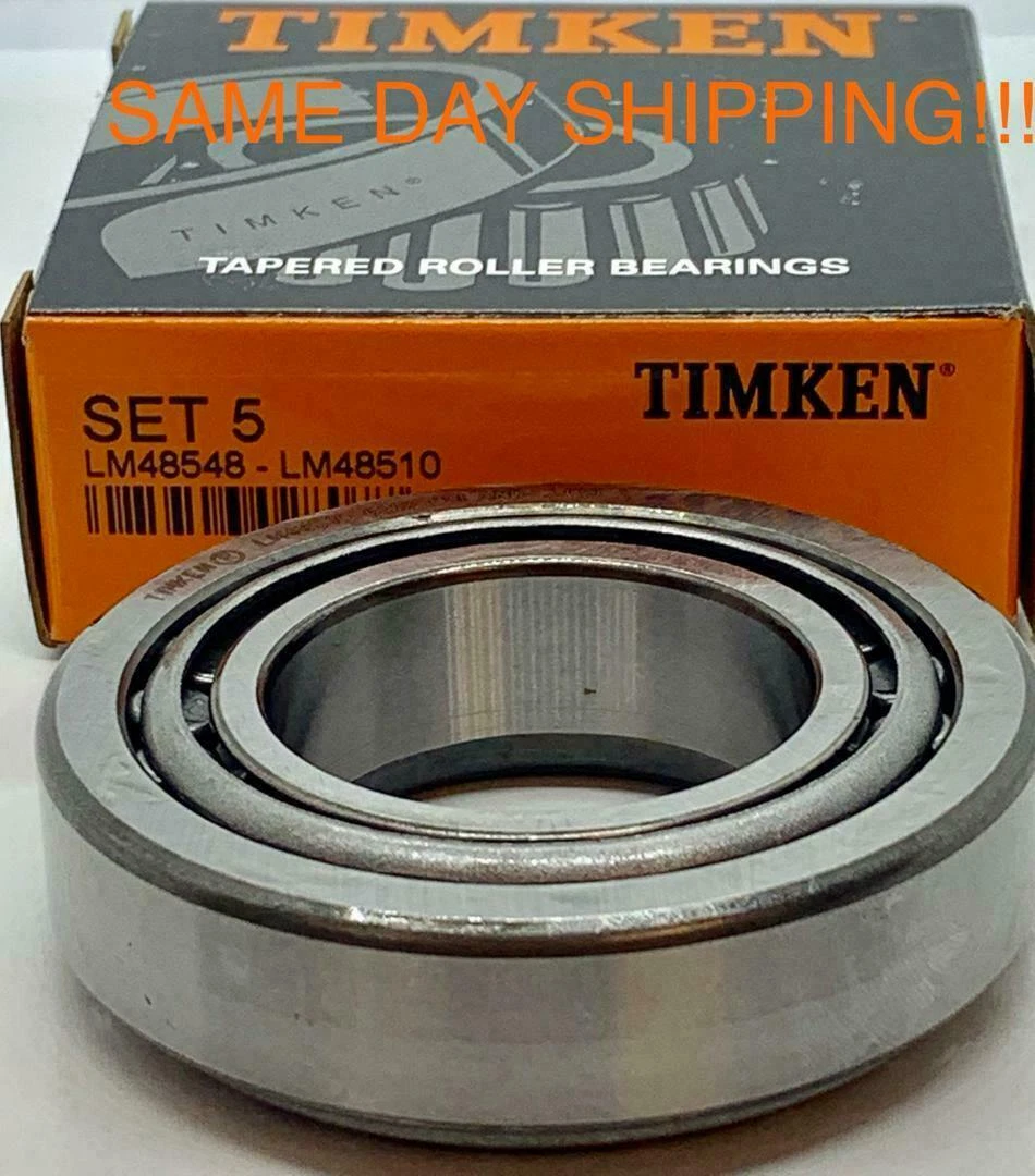

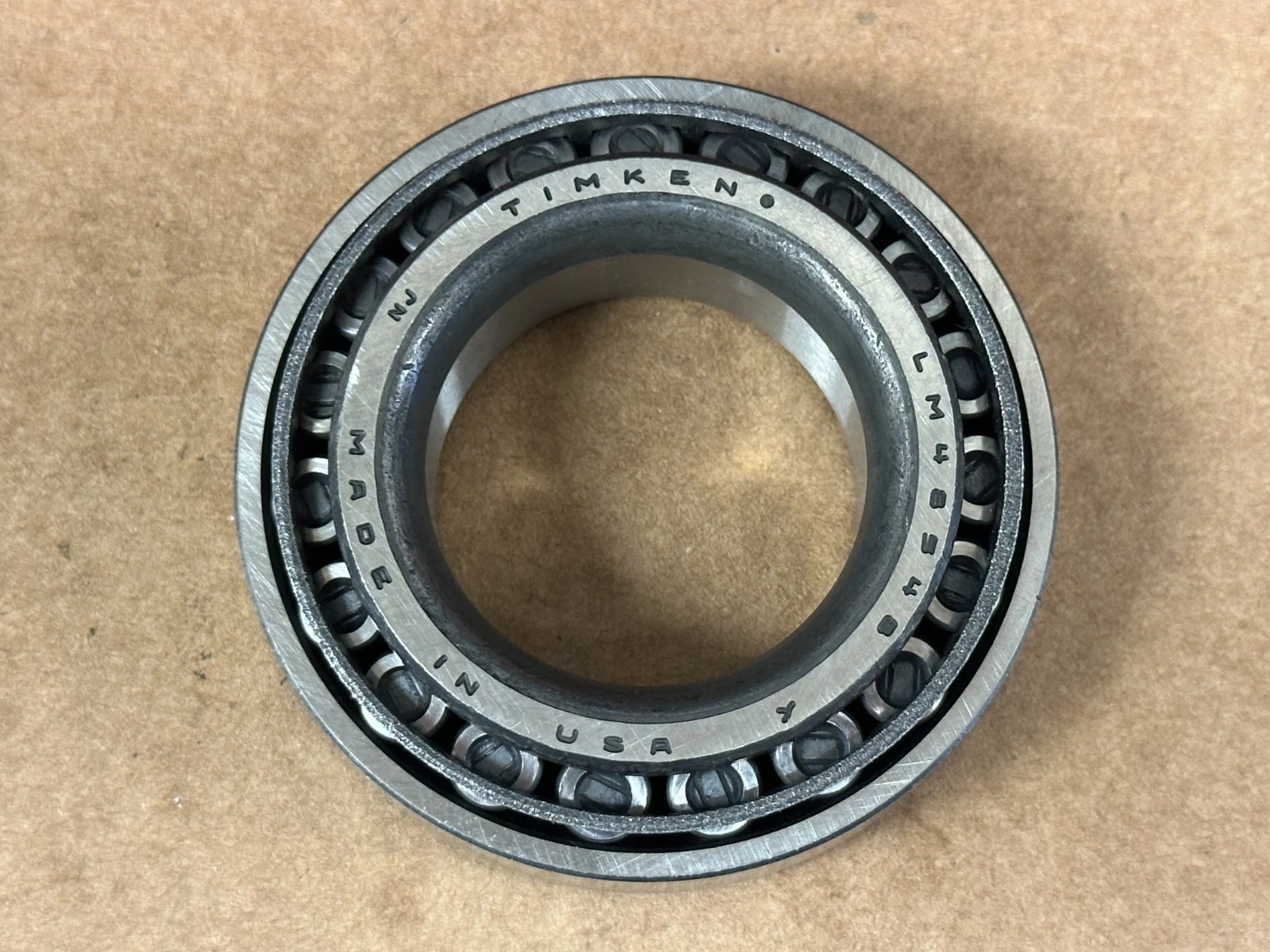

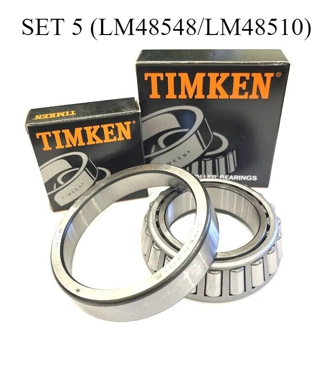

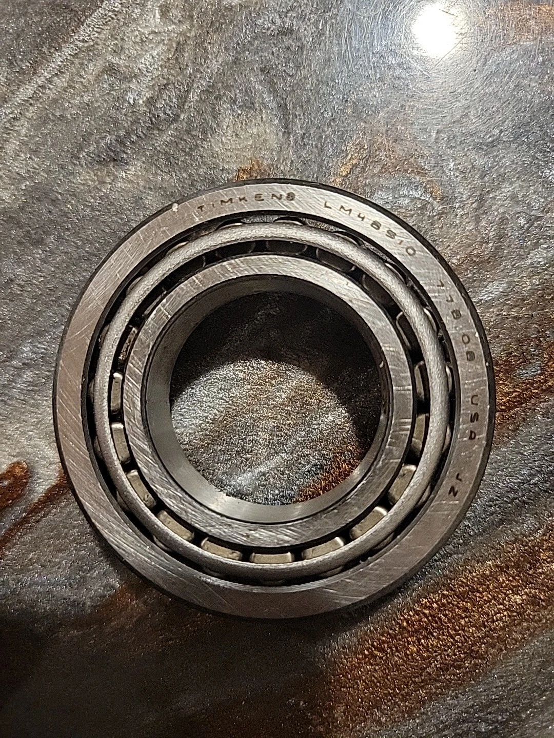

    I only use Timken bearings for my trailers, i haul trailers a LOT of miles and have found Timken bearings to be the best. Twenty years ago good auto parts stores kept good bearings but now you cant find Timken bearings anywhere except online. Timken stamps their part number into the race of the bearing AND laser etches the stamped letters. It makes a very distinct look that is easy to recognize. Go on Ebay and look at Timken bearings and you can easily use this to see the real Timken bearings vs the fakes. You CAN find REAL Timken bearings on Ebay but i would venture to say 80+% of the listings are the fakes. The laser etching they do on the fake Timken bearings looks "close" to the same laser etching Timken does but the fakes are only laser etched. The real Timken also have an indention where they stamp the part number before the etching. A REAL Timken bearing is tighter when its wore out, than brand new auto parts store bearings are right out of the box. I've been using them close to 30 years and learned how to spot the real vs fakes. There are HUNDREDS of listings on ebay of fakes. Why would they fake a $12 bearing? I dunno, maybe because they make it in tajikistan in a cave for $0.03 each so selling them on Ebay for $11.99 is making major profits for them.
    Legit Timken bearing: look at the depth of the letters
    https://www.ebay.com/itm/357619703025
    https://www.ebay.com/itm/267375696138
    All of the fakes are laser etched, but dont have the depth of any of the letters like the real authentic. The boxes are identical, the wrapping is identical, the prices are close, but you gotta look thru hundreds of listings of fakes to find a few real Timken bearings.
