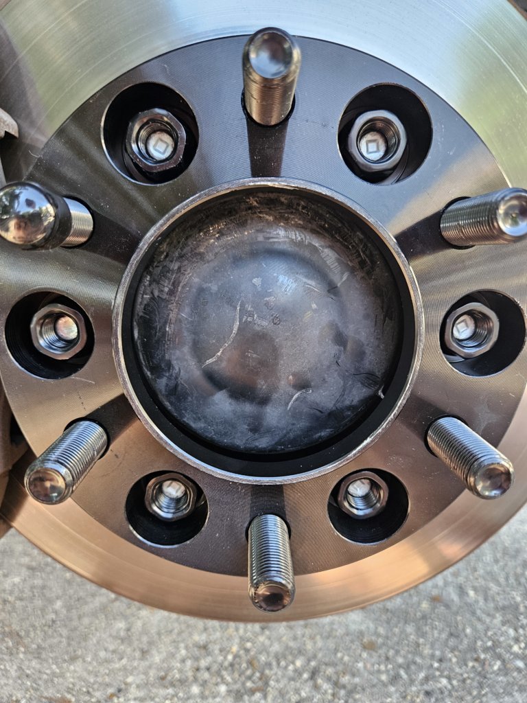

    I currently own a 2020 4runner SR5 4wd. I bought these 106mm to 95mm adapaters/1.5in spacers to go on my 4runner but noticed the OEM wheels studs are a little short for me to get the open ended lug nut on all the way. Does anyone know a good extended wheel stud i should buy to make this work?

    What kind of spacers are they?
    I didn't have this problem with 1.25" Spidertrax or 1.5" Trail Gears.

    Is there a reason to change the hub bore size?
    With a 1.5" spacer, there should be plenty of room to bore enough space for the open ended nuts to thread on the entire stud. Something seems weird with that design.

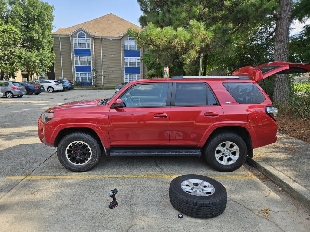

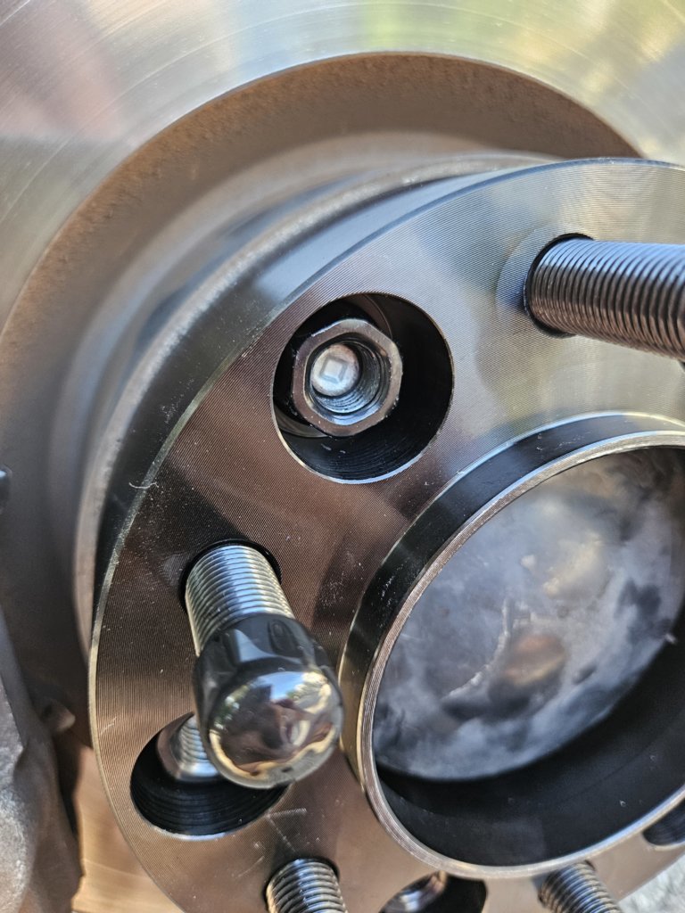

    This is what im trying to do. I got 12 full turns on the open ended lug nuts and had a 5 threads left with the spacer. It fits just right but im thinking I might need extended wheel studs. What do you all think?
    Edit: I also took off these and put the originals back on.

    IIRC, once the nut is screwed onto the stud and is equal to the diameter of the stud, you will not get any more holding power between the stud and nut even with more engagement.
    Sounds like that was achieved with 12 full turns.
    Check the data, I think I’m correct.

    Yeah that's what I thought. I got 7/8in of the open ended lug nut on there. All I needed to do was get to the .47in mark so im near double that technically. I also asked chat gpt and it said the same thing lol

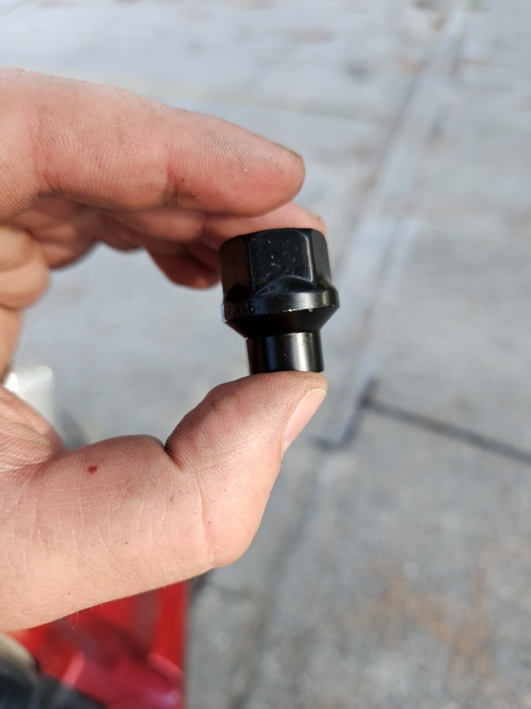

    Do you have a photo of one of the lug nuts holding the spacer, not installed? I'm just curious, as most using spacers have issues with the oem studs being too long, not too short. I'm also curious why the hub bore needs to be adapted...

    The hub bore size has to be changed due to the wheels I bought being off the new Tacoma. Also I get nearly 11 to 12 full turns on the threads but it seems the open ended lug nut I got is too long for the wheel stud. But that shouldn't matter because I have enough thred compared to the diameter of the stud

    The company sells extended thread open ended conical lugnuts e.g. https://spacerexperts.com/products/...toyota-trucks-and-cars?variant=37807205351603
    It isn't clear from the spacer listing if these were already included with the spacer. If you aren't already running these, they provide additional thread engagement.

    That explains the twelve turns. At 1.5mm thread pitch, that's 18mm of thread engagement. You're good as-is. No Loctite or long studs necessary.

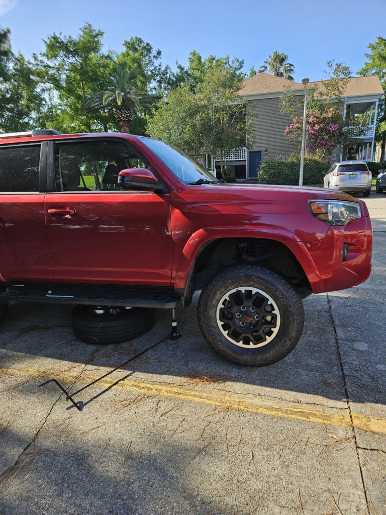

    Seems like a lot of effort just to stick the tires out a bit?
  24. Jun 1, 2025 at 5:06 PM
    3,016
    ^6th gen wheels need spacers, or tires hit the UCA. Since when was wheel spacers considered a lot of effort? :laugh:

    So it actually doesn't really make the tires stick out much at all due to the offset of the wheels themselves.
