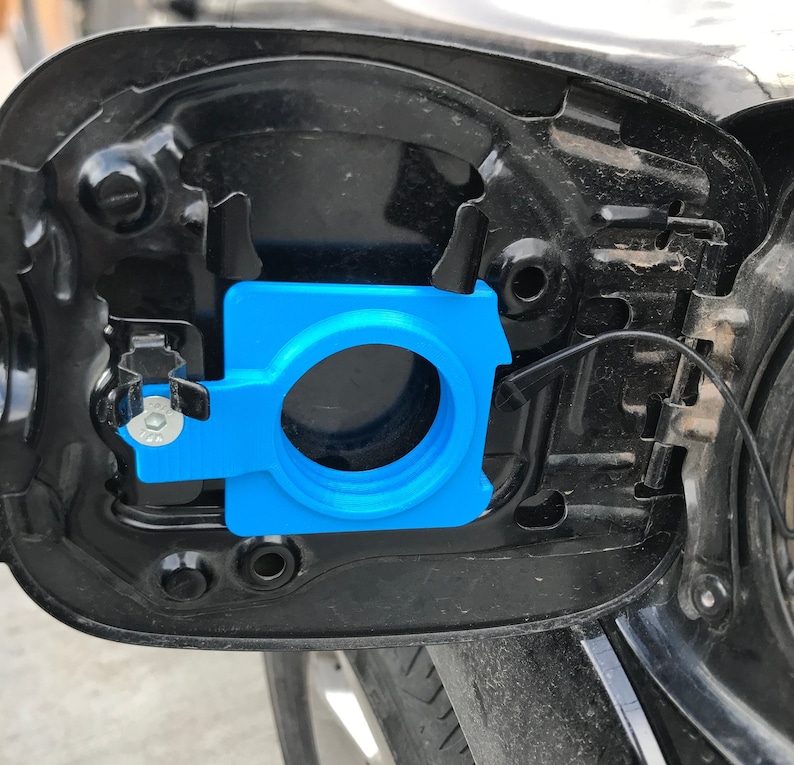

    How do I remove the screw, highlighted with the arrow, that hold the clip on the fuel door?
    I've tried a P3 screwdriver, as recommended, and other phillips drivers...
    can get vice grips on it, but too tight to turn...
    I briefly thought of grinding it off, but still would have the threads in the hole to deal with. I do not see any loctite on it
    its a new truck, has not been rusted in place

    Try spraying some penetrating oil on it and let it set for a few minutes. They have a 2000 pound gorilla that puts that screw in at the factory.

    I agree with using penetrating oil. If that doesn't help, it might be a rare case of needing an impact driver. If so, I wouldn't count on the screw surviving the extraction.

    I'd probably try an electric heat gun before graduating to impact.

    I tried PB Blaster...
    I tried a DeWalt drill driver
    I tried vice grips
    And the screw will not even begin to turn...
    I wonder about a torch, but don't want to ruin the paint on the door
    I dont care about the screw being toast, the head is already a little worn, and the device Im installing has its own screw

    Yeah, I wouldn't use a torch, only an electric heat gun, and even that very carefully.

    Known issue reported in the Tacoma circles. Need a JIS screwdriver tip, e.g. https://www.amazon.com/gp/product/B00E55DL4I/ I had a similar problem removing the fog light screws and the JIS bit made all the difference.

    I agree with the JIS screwdriver recommendation, but those don't always work. You may also want to look into an Impact Screwdriver (https://www.youtube.com/watch?v=i0JFWBntAVA&ab_channel=MotorcycleShows). It uses the force of a hammer to push the bit into the screw while also applying a rotation to loosen the screw. You will likely need to support the fuel door from the backside with something soft while hitting but it's an option if the JIS bit doesn't work.

    Since you're gonna replace the screw anyway, Dremel the head off & drill it out.

    I got the JIS screwdriver today, and it didn't slip, but the screw didn't budge
    The JIS is something I needed anyway...
    I started to get the Dremel, with a small bit to drill the center, but then decided to drill the head...
    twist it off broken and use vice grips on the remaining stud
    Got the head drilled partway, and it was hot to the touch...
    used vice grips and the screw just twisted out really easy
    A little heat was the key, but not sure how I could have gotten enough heat just on the screw with a heat gun
    thanks for the good advice...

    I was looking at that holder as well but I saw the issues removing the screw. It must have threadlocker.

    Maybe a soldering iron?

    The screw doesn't have any thread locker, after the heat broke the screw loose...it came out easy, but I couldn't budge it before
    just try your screw to see how hard it is...
    I destroyed the head of the original screw, I already found the toyota replacement screw and its in my cart for next order I make
