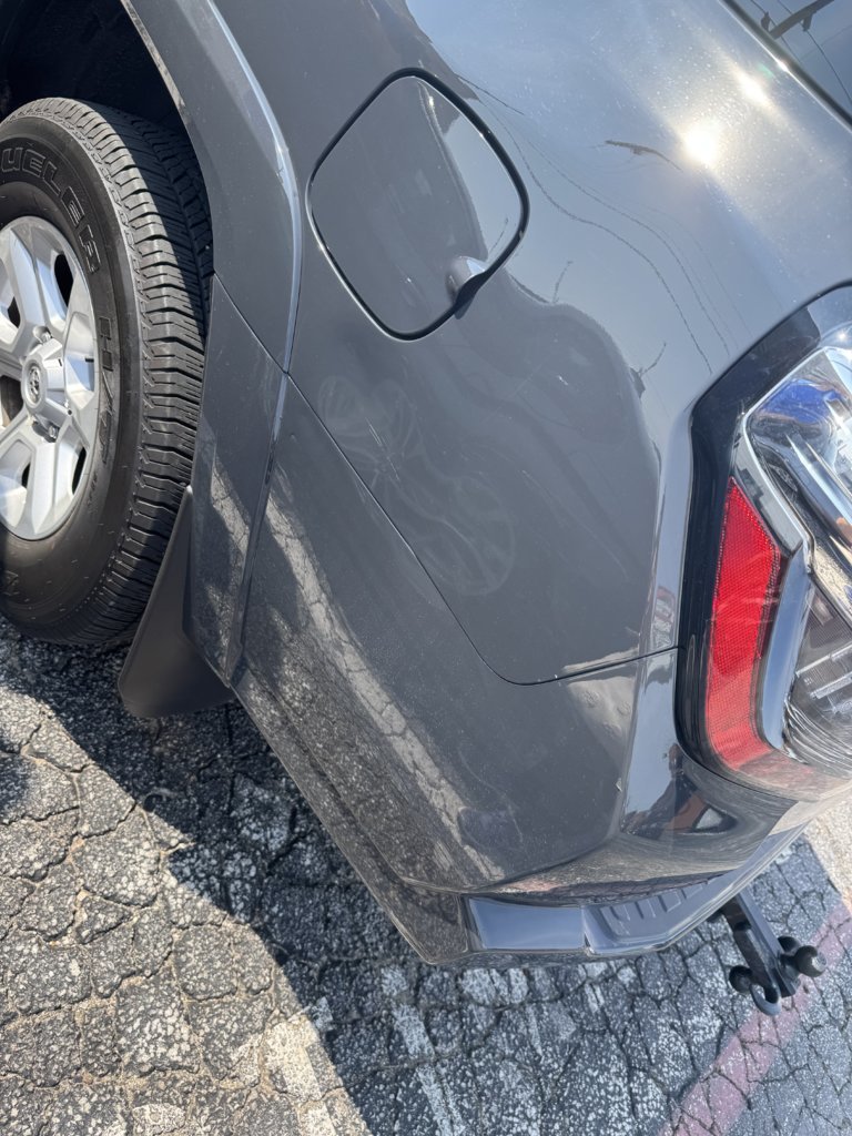

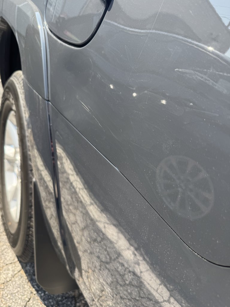

    Hello, I have a 2024 4 runner sr5p and I’ve received several estimates from auto body shops and just want to make sure to make the best choice for her. I plan on keeping her for 300k miles. Hopefully she’ll be the last vehicle I ever own. I got some minor scratches and a slight dent. Please see photos. I would prefer not to use bondo but that what’s I am hearing. In my understanding bondo is not a long lasting fix. Would replacing the entire panel be the answer? Thoughts? It’s hard to see in the pic but the dent is near the white scratches. I just hate the it’s only a year old with this damage IMG_1757.jpg

    Hi Denae and welcome. It’s hard to tell from the photos because of all the reflections but to me that dent looks like a good candidate for paintless dent removal techniques. Even if the scratch needs some paint it doesn’t look to me like bondo would be required. But even if it were, Bondo, properly applied, is a legitimate long lasting repair. You shouldn’t be afraid of it..

    A PDR technician should be able to hammer this out from the inside.
    Panel replacement is invasive because it's part of the welded cab structure, so it'll involve grinding off welds, removing rear quarter window glass, etc.

    Take to a PDR shop. They can most likely get most if not all that out if they can get access to that area.
    As for the paint a detailer might be able to buff some of it out to where it’s much harder to notice. Also some PDA shops can help with paint buffing to minimize scratches.

    Agreed - perfect candidate for paintless dent removal.

    My buddy does pdr work and that should be an easy fix
    bodyshop and bondo not needed. Find a dent removal company and save time and money.

    Get a PDR kit from Amazon and give DIY a try. We did this with a small door ding and it worked well.
    If you can't get to it from the inside to push it out, you could also try a plunger and see if you could suction/ pull it out.

    Welcome from Wisconsin! The P D R is the way to go.

    I agree with trying a paintless dent removal first. I would find some shops in your area and see how they are rated by the BBB. I had an Acura fixed with PDR and what they can do is amazing. I am not sure how much they can or cannot do for the paint. But having the dent taken out by PDR is much better in the long run than a panel replacement.

    Personally, I would rather have a PDR job that's less than perfect than having the invasive work done to replace a panel. It always seems like there's some kind of an issue with it, and depending on how they do the work it can lead to issues later on down the line.

    This should be pretty simple fix if you don’t want to spend much money. People saying paintless dent removal are on the right track. Kits are $35 on Amazon, I just pulled a similar dent out of mine. I’d say you can expect 80-90% fix with a slide hammer and the hot glue anchors, and cleanup is really easy with soap and water. Good luck!
