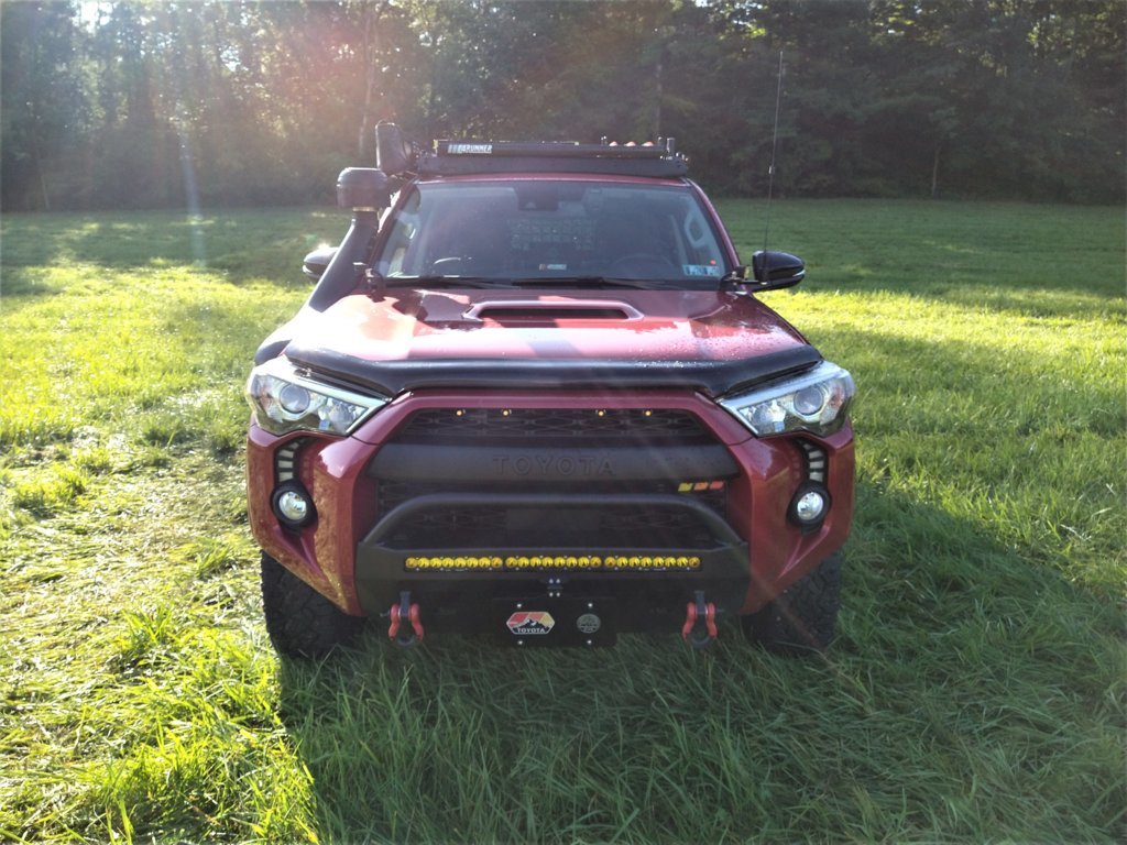

    Best placement for an antenna mount (Midland magnetic mount that came with radio and there ghost antenna (for my 70cm GMRS radio i use the most):

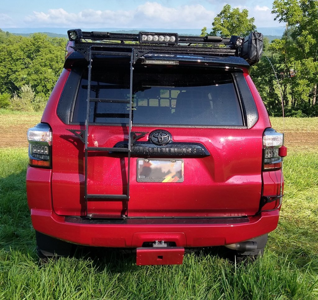

    Comet SBB-1 NMO & Comet CP-5NMO mount. Not the best placement but is for 70cm and 2m. Also fits in my garage.

    The GMRS was easy since the radio came with the antenna and it was the magnetic mount on the center front of my roof (1st photo noted in post #3). The other one i had to mount in a different spot on the back of my 4R (2nd-3rd photo noted in post #3) and needed a special mount. No mounts I'm aware of that do both CB/GMRS in one. The frequency's they use are wildly different and need different antennas.

    Some radio antennas reflect off their mounting surface, so to get maximum broadcase distance the center of roof is ideal. But not ideal for mounting options. So find the best location for your needs.
