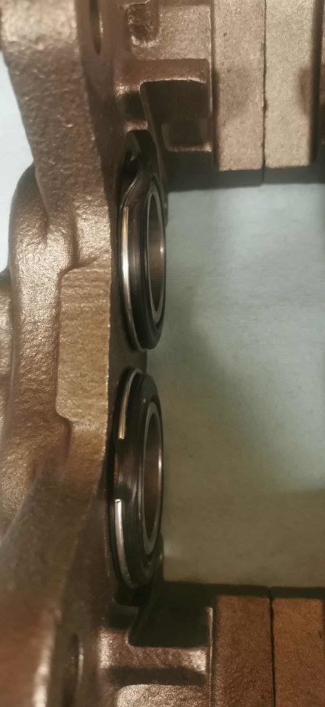

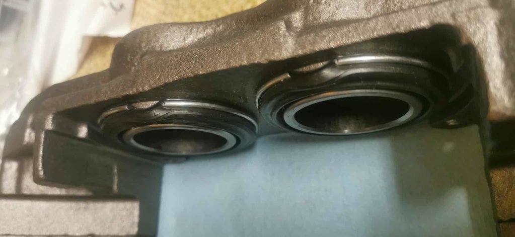

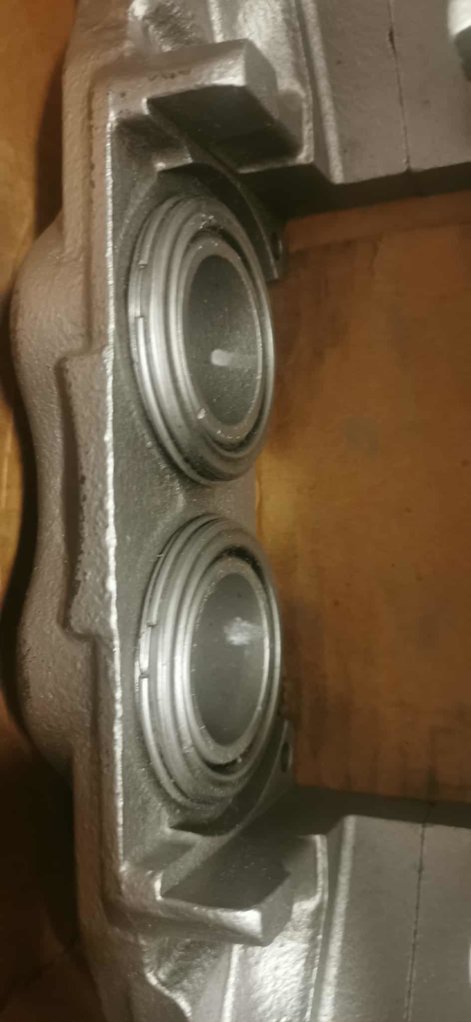

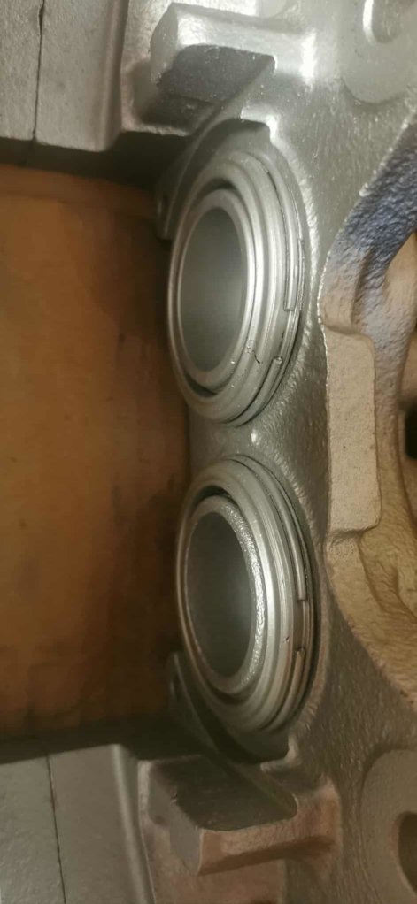

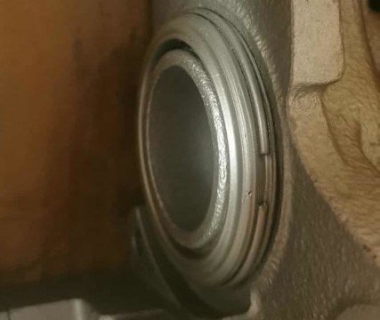

    Hello!
    Just received two rebuilt front calipers I ordered and they look like this. I don't know enough mechanically to judge if they're crap or if they just looks like crap.
    One has pinched seals and (looks like they put some seal a bit larger than needed)
    The other has painted seals.
    Can I install them anyway? I'm afraid the paint may dry/use the seal and the pinched one may leak brake fluid..

  6. Sep 16, 2025 at 5:39 AM
    3,503
    Those are dust boots. The seals responsible for keeping fluid in are further inside and sit in a groove in the bore.
    The dust boot pinched under the wire clip is easy enough to re-seat with a pocket screwdriver. I had to do this with Powerstop calipers I installed two years ago.
    What brand are the rebuilt calipers?

    They're from BBB Industries (now Terrepower).
  8. Sep 16, 2025 at 8:19 AM
    3,503
    ^Return/exchange the over-painted caliper because they re-used the old pistons. Pistons should have been replaced during reman:
    I would fix the dust boots on the other caliper and run it. Pro-tip: hand check with a short wrench or ratchet all the bolts on the caliper are tight.
    Djordhan[QUOTED][OP] likes this.

    So, decided to send both of them back and just put some more sweat into replacing the 2 stuck pistons in my old calipers. Was trying to go the easy way with rebuilt/cheap calipers but hey, if you want something done right, do it yourself.
    Thanks all!
