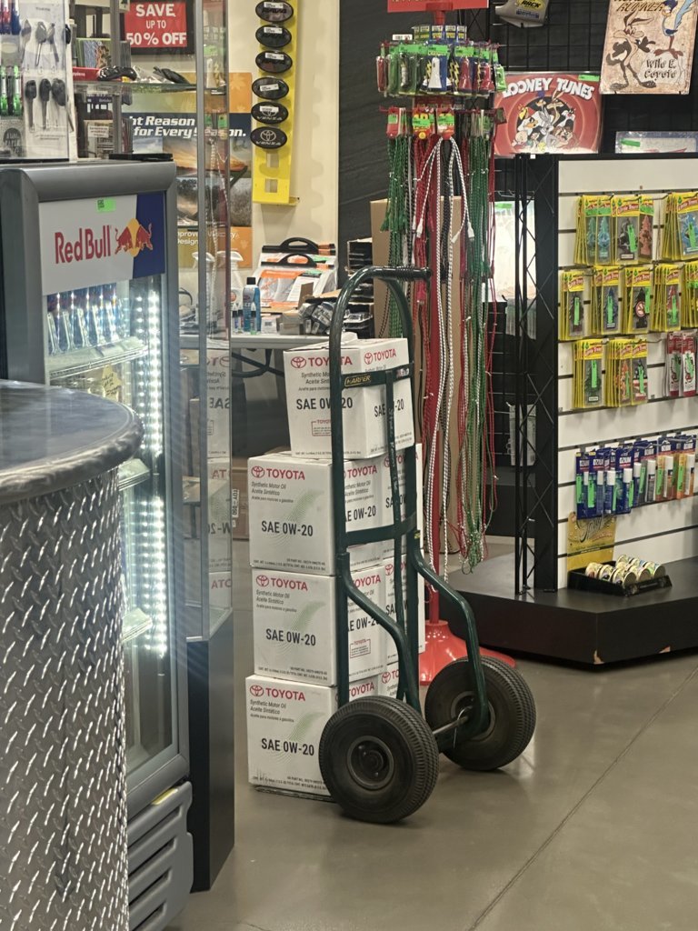

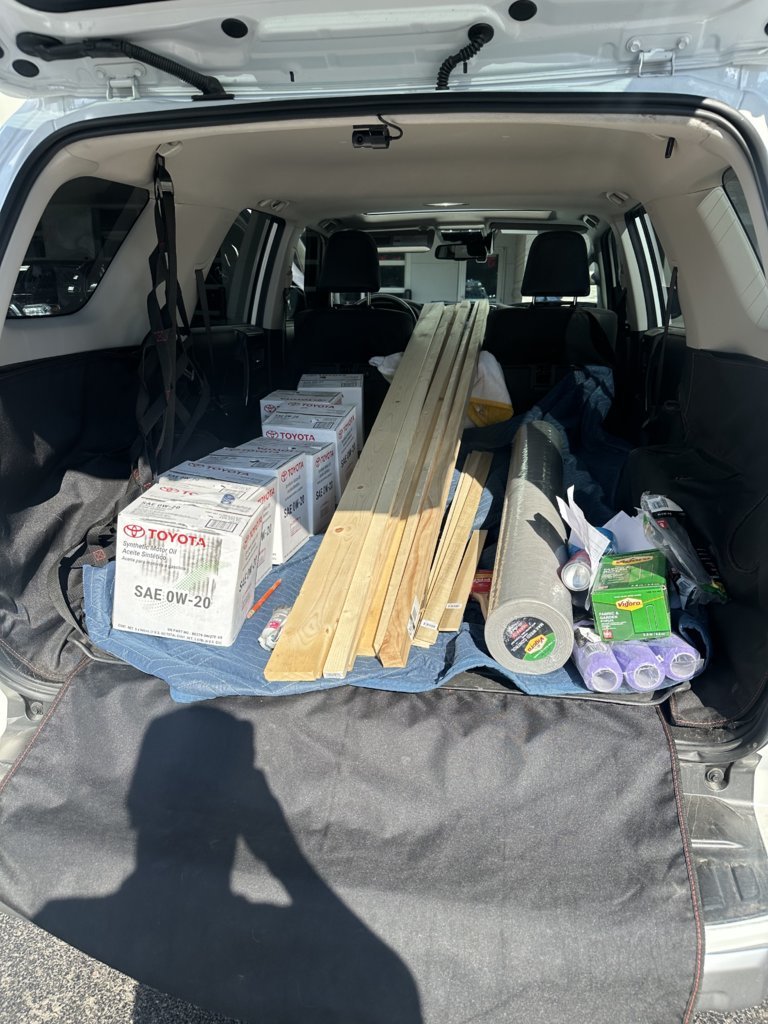

    Went to dealer and stocked up on oil and it got me thinking…
    I have about 8 oil filters and 7 cases of 6qt Toyota Oil. My wife’s Lexus and the 4Runner both use the same oil and oil filters.
    Her Lexus is due and I’m changing next week. The 4Runner is due in about 2000 miles. This accounts for about 13 of 42 qts which leaves 29 quarts remaining.
    My garage is unheated and no AC. Will this degrade the oil and oil filters, or will they be fine until use them all up?
    I’ve been keeping the air filters, oil filters in the house, but would prefer the garage. Just curious how long the shelf life is in this environment.
    -5 degrees up to 100 degrees in Denver area throughout the year.
    How much does everyone stock up on advance or do you buy as needed. I’d hate to put a degraded filter and bad oil in if it took me a couple years with these elements. I’d be a little less paranoid if my 4Runner didn't have only 8000 miles on it.
    Thanks!
