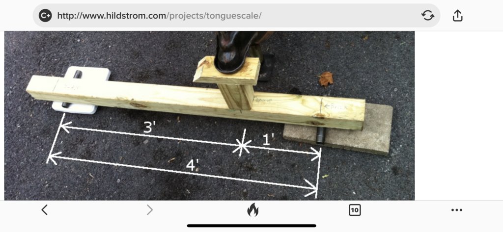

    If taking it to the scale do this.
    https://www.curtmfg.com/trailer-parts/couplers/learn-more

    Great article (thanks) on how to figure out the Tongue weight. I will do that when I weight it in the next few days.
