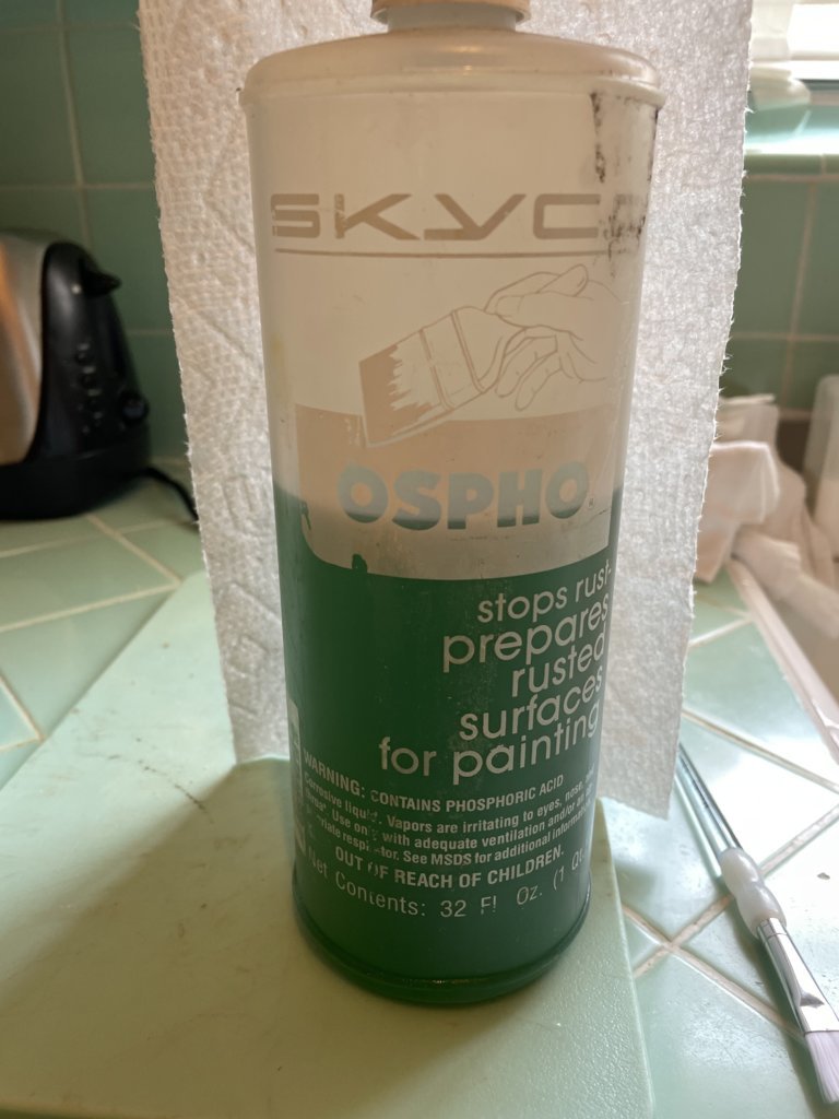

    Do you have rust and corrosion now?
    Are you wanting to stop rust that is looking bad?
    Or, is your underneath vehicle needing preventative coatings?
    There are chemicals that actually convert rust (brown color) to a grey stable compound (grey color) that once coated with a sealer/paint will last years and prevent its spread. Best used on selected parts like brackets, mounts etc.
    I use Ospho. Wally sells it. Marine stores sell it.
    I have used it with excellent results on rusty steel on many vehicles for decades.IMG_9253.jpg
    jgalt likes this.
