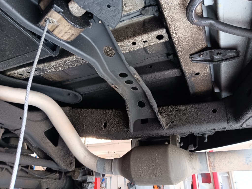

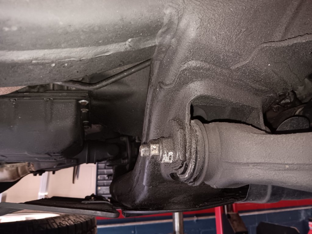

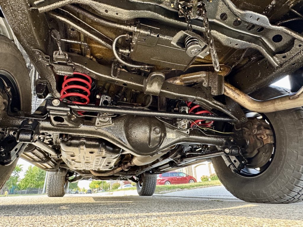

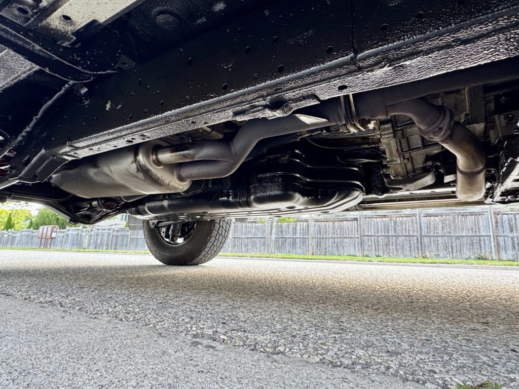

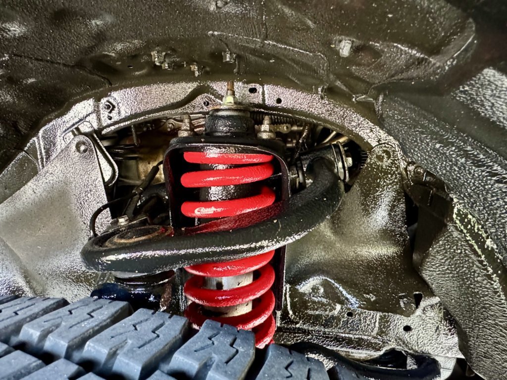

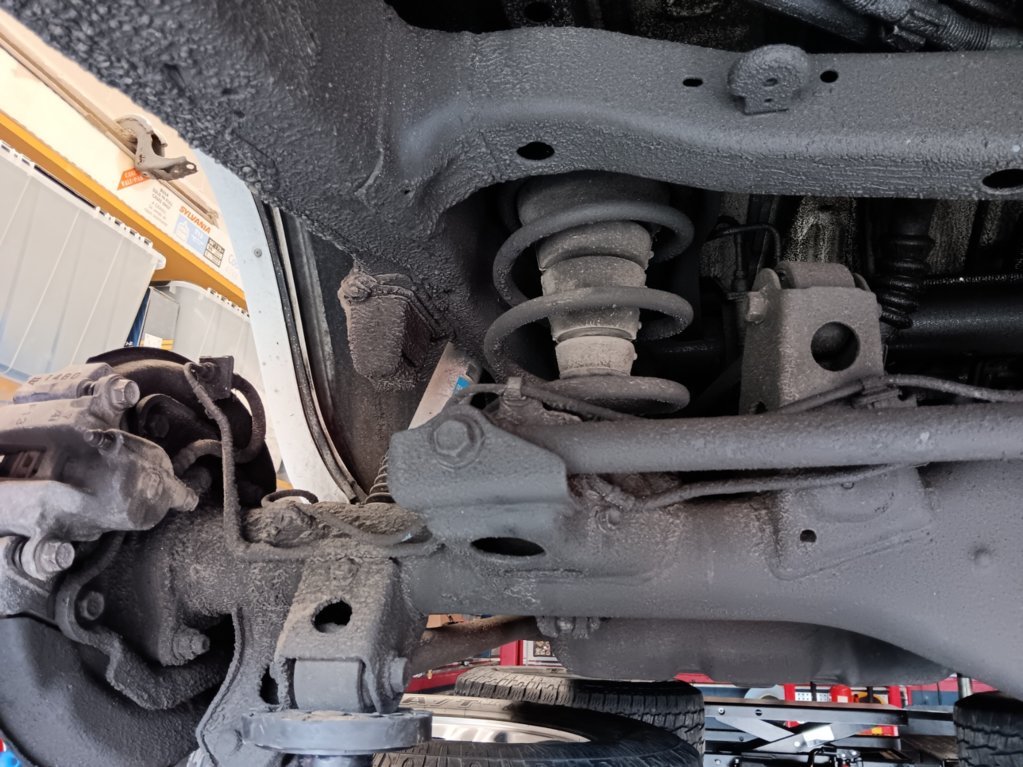

    Just got it rust proofed, removed the spare tire for better access, bring on the snow and salt!! Had it exactly for 4 years now, frame is like new condition still and plan to have it this way for as long as I can.

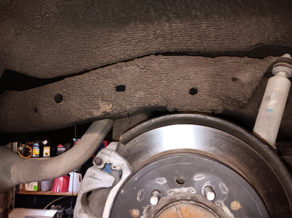

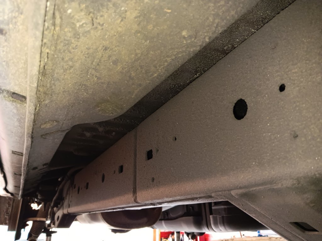

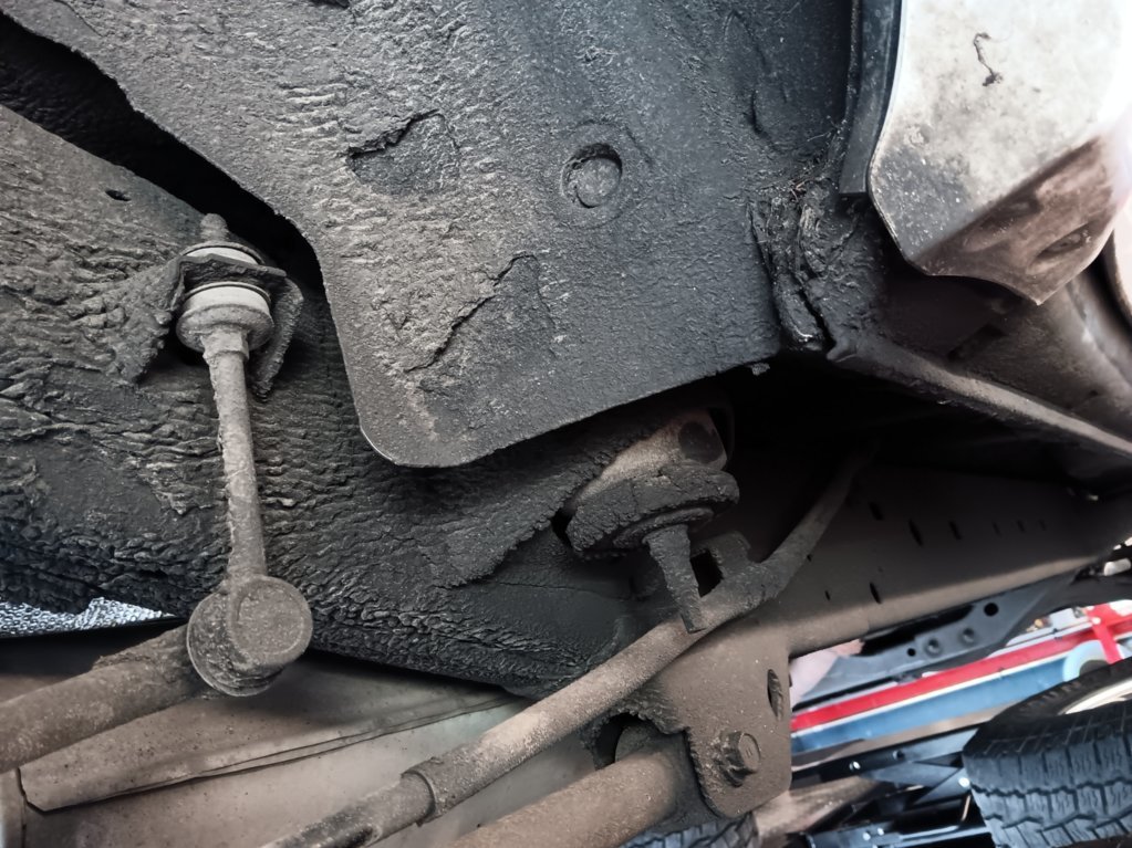

    I've posted these photos before, but here's as good as anywhere to post them again. Fifteen years of rustproofing (Rust Check and Krown), driven through every winter and kept outside. Thankfully, the rustproofers spray up through the spare tire so I've never lowered it for them:
  7. Sep 9, 2025 at 7:26 PM
    1,067
    You have done good
    While its not aesthetically pleasing, it absolutely works and saves your chassis and suspension from rust. Definitely recommend if you are in the rust belt, its a MUST.

    And body structure. I can't show pictures of the engine bay, door jams or rear hatch because I feel the dark filth would traumatize a few members but it's mandatory for the long haul in these parts.

    Nah there's no real smell, especially after the first day.
    It's similar to Krown, its a local guy here, he does great work for me, being going to him for decades now with previous vehicles as well.
    This is true!
    This stuff works great and pretty much no smell at all once it burns off the exhaust where it was oversprayed.
    Looks amazing for 15 years.
    Yea, pretty much everywhere this stuff gets sprayed, all the holes in the doors, hatch, engine bay, etc.
