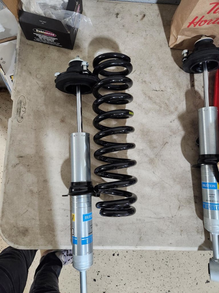

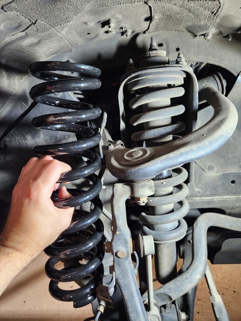

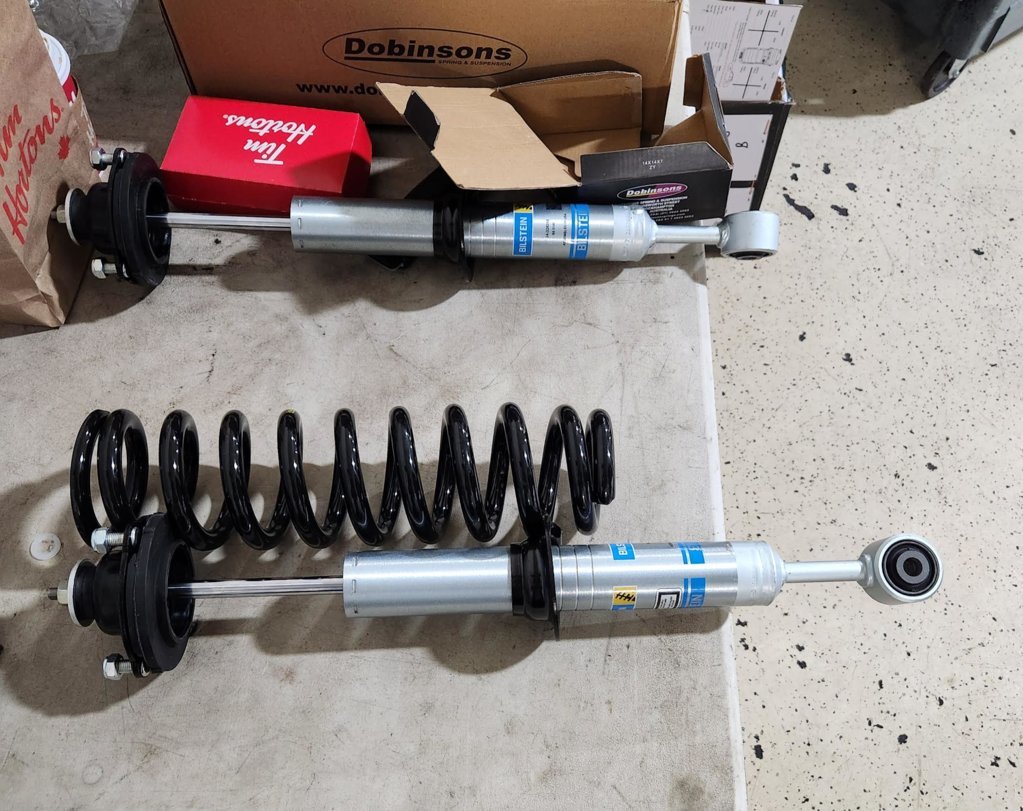

    Im running some problems and I had a horrible day today. I ordered all the parts last week and was super excited to put it together today then I realized my Dobinson (C59-302) front springs didn't like compressing them too much. I do not know if I did it wrong or not but I will try to explain this better with pictures.
    0-2.jpg what you see here is my Bilstein5100 at the highest groove setting and when I tried to compress it to fit, it is technically impossible because it doesnt compress enough. even if it did, there wouldn't be any room for it to bounce.
    1)if I go to the lowest groove setting on Bilstein 5100, would Dobinson spring (C59-302) fit and still give 2.5" lift in the front?
    2)or should I go at the highest groove setting (like it is in the picture) on Bilstein 5100 and use the stock springs since it is much shorter than the Dobinsons?
    3)or maybe you tell me where did I make the mistake?
    I really don't want to send return the parts to them and wait for a refund or change with something else etc. if I absolutely have to. Do you think there are ways I can make this setup work?
    Kindly appreciate your help

    Contact @Crikeymike (here on the forum). He's a dobinsons rep. He'll probably know what's going on.

    Those are lift coils......as in they are longer than stock and their purpose is to do the lifting of your vehicle. I can't tell exactly, but it looks like they are supposed to provide you with somewhere around 2" - 2.5" of lift.....and that's with the Bilstein spring perch on the lowest setting.
    So yes, that spring perch needs to be on the lowest setting.

    Use the lowest perch. You're not thinking about it properly. You either preload stock coils or use lifted coils with no preload

    According to the horse's mouth, it'll give 2.0" lift in the front: https://dobinsonusa.com/products/do...rings-for-toyota-4x4-trucks-and-suvs-c59-302/
    You can try running on the 2nd lowest circlip setting. Driver's side may benefit from being one notch higher because of "taco lean".
    What spring compressor are you using? Hope it's beefy or this may be your last day with all ten fingers :eek:
