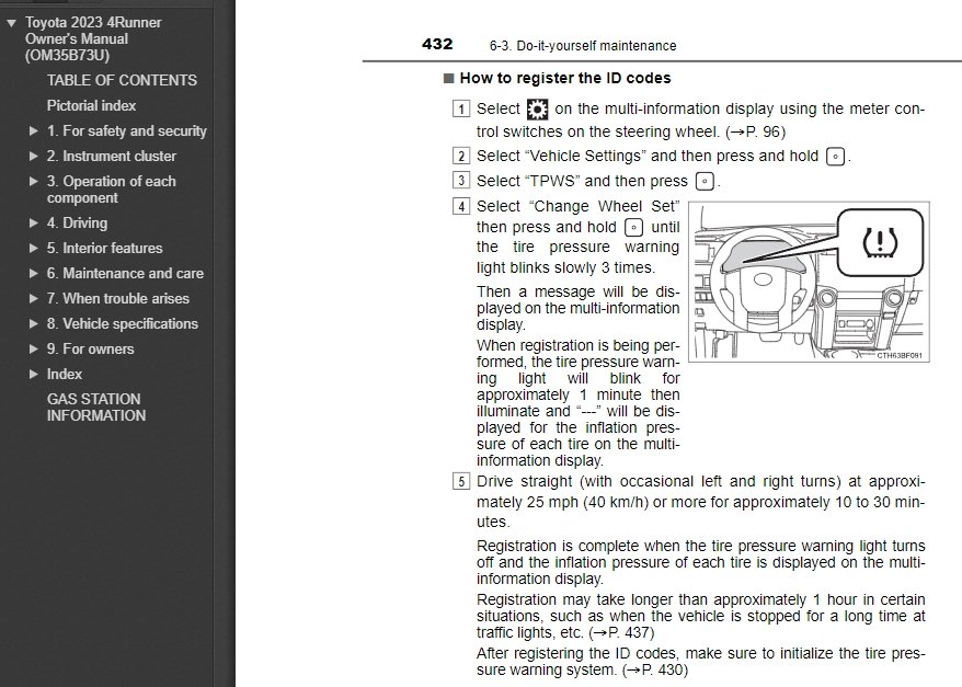

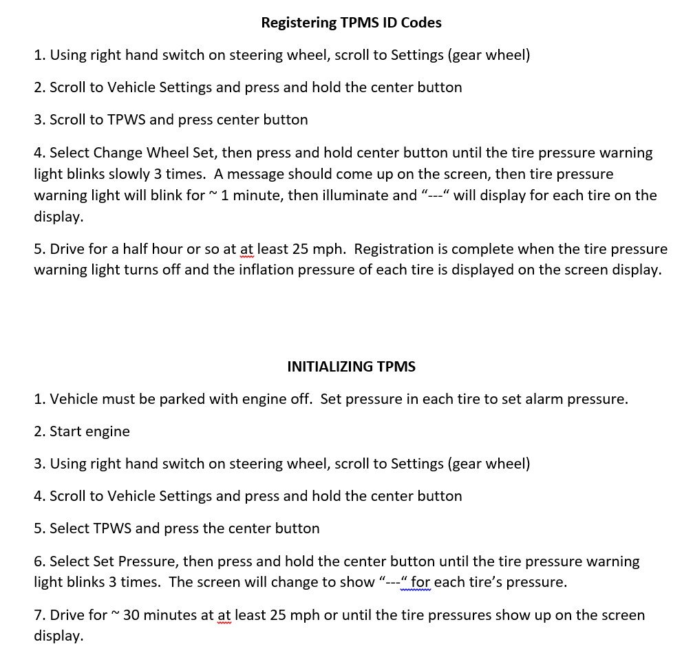

    Look in your owner's manual! I also have a 2022 and followed the instructions in the manual to "Register" and then "Initialize" new TPMS sensors when I got another set of wheels with new sensors and it worked well.

    What pressure do you use “Set pressure in each tire to set alarm pressure.”

    The great thing about this model of 4R is that it allows YOU to pick the pressure that will set off the alarm. Me, I'm aired down - I drive a lot of dirt roads so I set my 4R to not set off the TPMS alarm unless the pressure drops below 25 psi. If your normal pressure is ~ 34 psi then I'd set the TPMS system to alarm at 28 psi. It's up to you.
