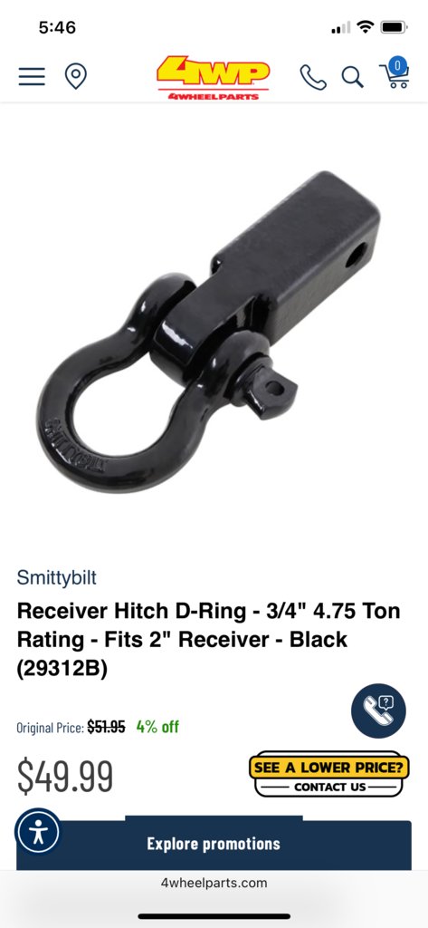

    I know snatch recovery is popular, but a non-kinetic slow steady pull can also recover a truck and be much safer to people and truck components.
    If you get stuck by lack of traction getting pulled backward is likely a viable recovery. Placing a solid (aluminum or steel) hitch plug into your receiver is a good anchor for a non-kinetic pull out. I like the ones drilled for hitch pin both vertical and horizontal. That way you can have D-shackle move side to side or up and down as required.
    I have no concerns using the stock steel hoops designed for transport tie down for a forward steady pull of modest force.

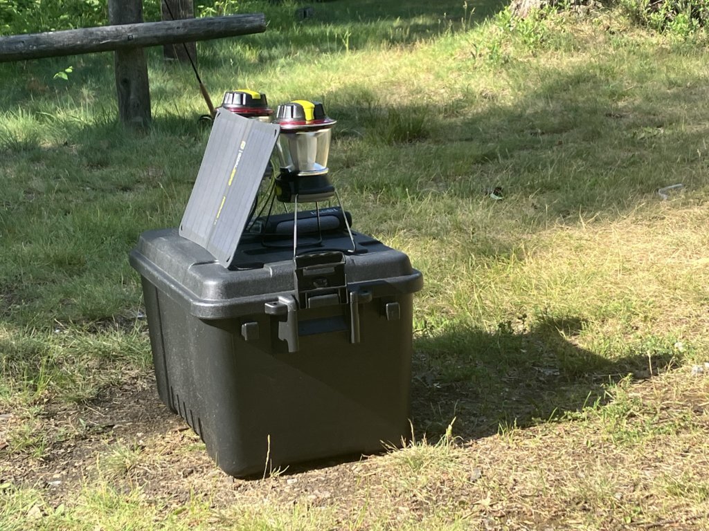

    Get a good plastic box , I have a Plano , stores a bunch of recovery gear and keep the mess in the box, makes a nice seat as well

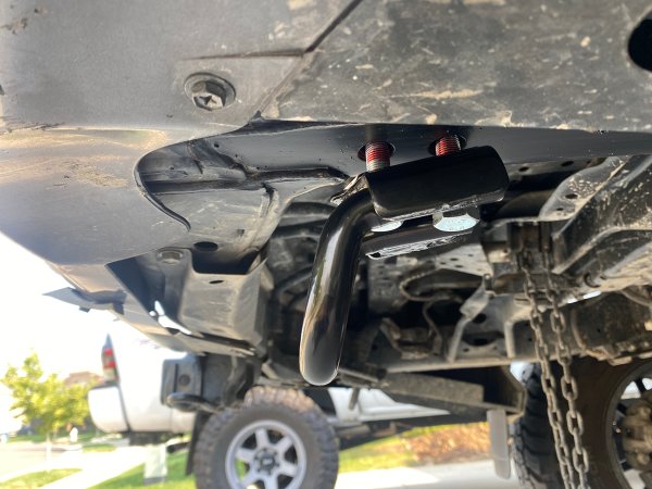

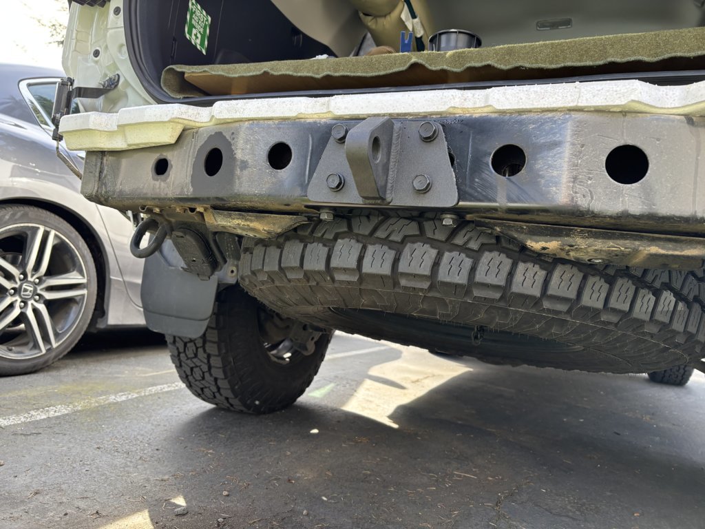

    Is it hanging on to the frame with just that one bolt??

    If you dont need towing, this is great for the rear, saves a hitch block, pins etc. All you need is a shackle.
    And the rest of the stuff goes on the roof in that Eylar case.

    No. There are 4 total.

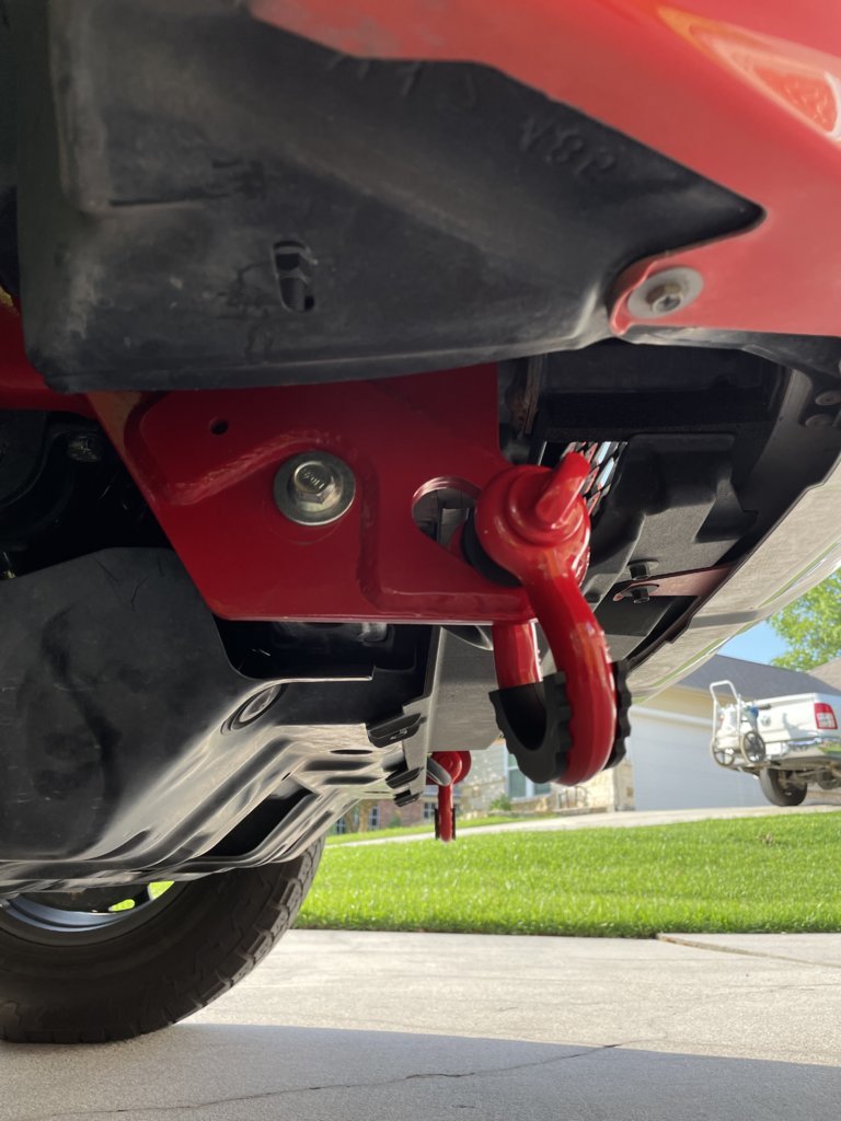

    Should I always add d-ring shackles on my apex’s for recovery?
    And, is that/do you have rubber on the shackle pin?
    Thanks

    IMHO the rear loop, while perfectly serviceable for vehicle tie down during transport, is not suitable for recovery. The hitch adapter and shackle are a better option.
    For the front, the existing loops are more than up to the task.
    See a lengthy discussion here.

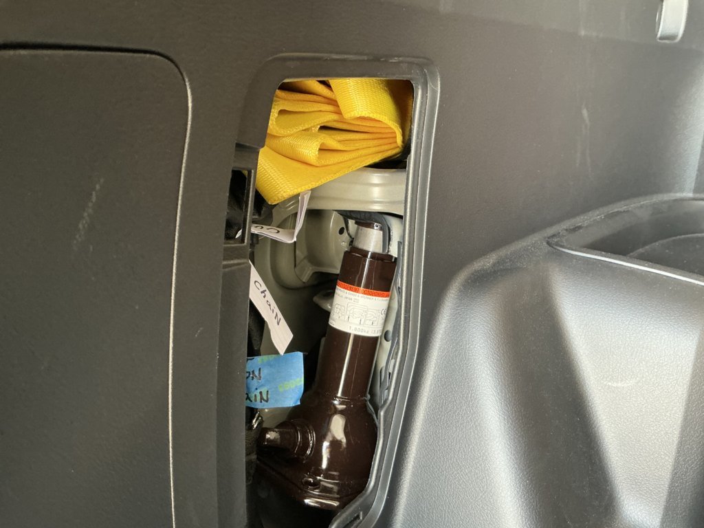

    Plenty of room in the top of the jack storage for a rope or strap .

    You don’t have to add them. Whatever you like. There’s no rubber on the pin but there is a rubber washer on each side. You can see one in the picture.

    As was said, it’s multiple bolts. If you click the link and scroll down there’s an installation video. Install took me about 45 minutes without lifting at all.
