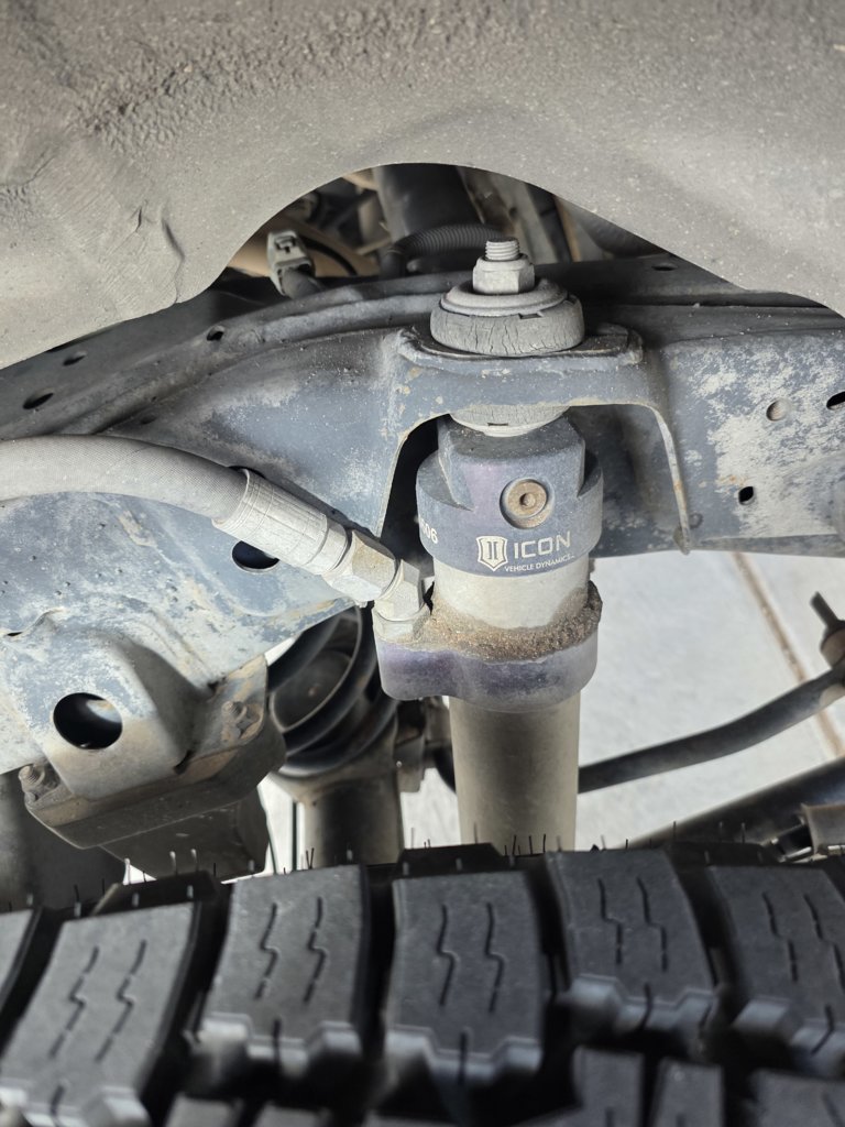

    Rebuilt my Icon front coilovers a while ago. I've been putting off the rears because they have reservoirs with adjusters and I can't find a good video or instructions anywhere. Anyone got any suggestions or videos?
    Mostly wondering how the hoses come off the body to replace seals as one of mine is leaking. Thanks!

    Remove the shock and everything unscrews as it looks...the hose fittings are just compression fittings...just need a couple wrenches and a vise is always nice to use...swap out your o-rings and recharge and away you go!
