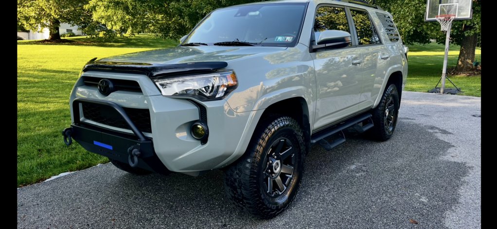

    3,402
    i have Eibach T13 coils in the rear at 1.5”. Loaded with vaca stuff and 2-3 people it might drop 1/2”.
    this is loaded. Its rides beautiful loaded and unloaded and perfect for my needs
