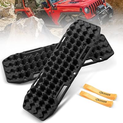

    I have a nice portable air compressor and a folding shovel. Any recommendations on recovery boards?

    You can't go wrong with Maxxtrax or ActionTrax. There are cheaper alternatives, but in general they won't be as durable.

    Get a cheap set like these and see how often you need them / how effective they are on your terrain: https://www.amazon.com/BUNKER-INDUST-Traction-Ramp-Orange-Emergency/dp/B09JZBN8QH/
    If you end up using them often, buy more expensive ones like Maxtrax or US Actiontrax. They don't work any better, but the plastic is several times thicker so they're more durable. Alternatively buy two sets of the cheap ones because they're very compact when stacked:

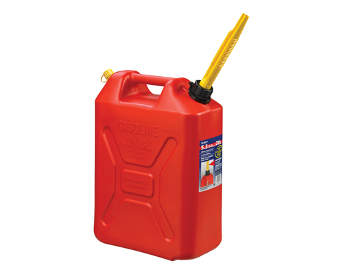

    For fuel, two 5-gallon Sceptre jugs secured upright with rubber straps is fine. They have a small footprint. Try to find these ones with a simple nozzle if still available in your state, or import from Canada :)
