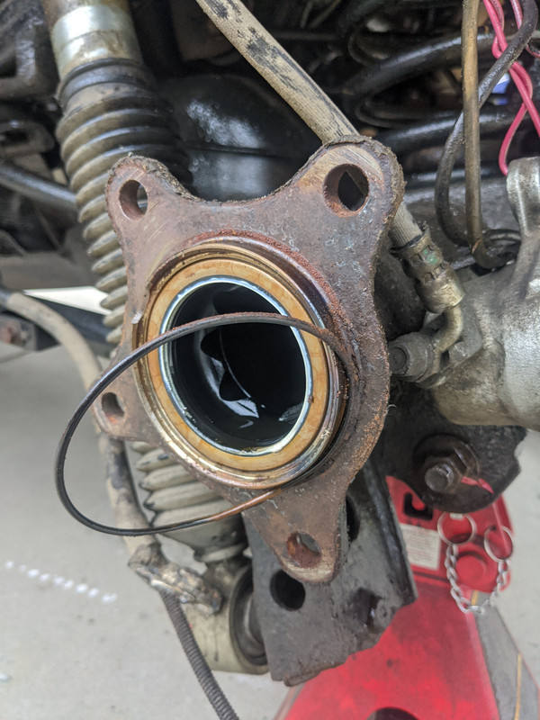

    After doing some research, I finally figured out what caused the axle seal to blow out.
    Water in the rear differential fluid
    • If you ever drive through deep water that may submerge the entirely axle, it doesn't hurt to go ahead and do a drain/check unless you are sure your axle seals are good and you've extended the differential breather to a higher drier location.
      • When you put a hot axle into cold water the temperature change creates a sudden vacuum inside the axle assembly.
      • If there are leaks or the breather itself is under water, it will draw water into the axle.
      • The gears will turn the water/oil mix into a gnarly sludge.
      • Also, once the axle gets hot from the poor lubrication the water will boil and the steam can potentially blow out seals.
    https://www.reddit.com/r/4Runner/comments/ujvqtf/how\_often\_does\_differential\_fluid\_need\_changed/
    I discovered rear axle seal leak the first time after a long road trip that involved many water crossings. I never did rear differential breather mod. That is probably another thing that I should do as well as replacing the seal.

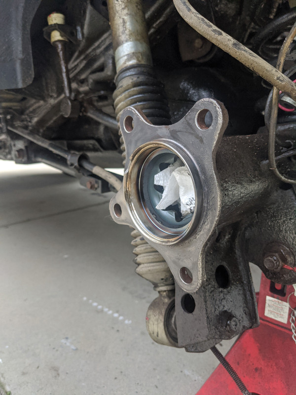

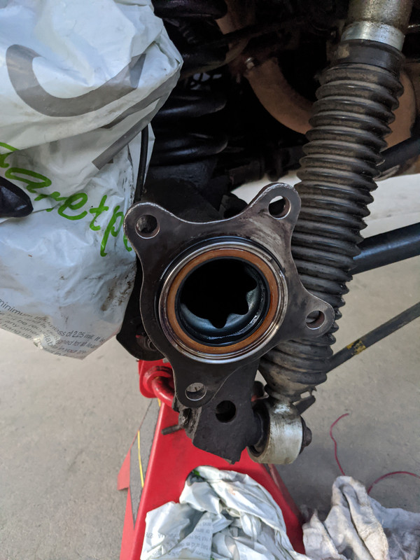

    Rear Axle Overhaul
    Rust has slowly made its way to mating surfaces of the hub and rear axle housing.
    I cleaned it up a bit the best I could with angle grinder and wire brush attachment. The pitting is very minimal.

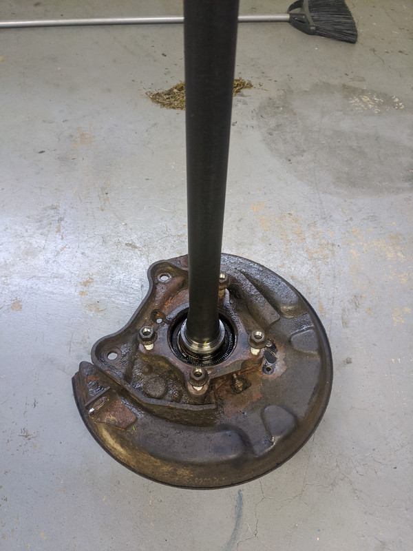

    Wheel bearing and the axle have seen better days. ABS sensor was completely stuck inside of the hub, and ABS sensor stud nut was seized onto the stud. All of these components were far beyond repair and would need to be replaced.
    Parking brake bracket bolts broke off.
    I had to drill out through holes to secure it in place.

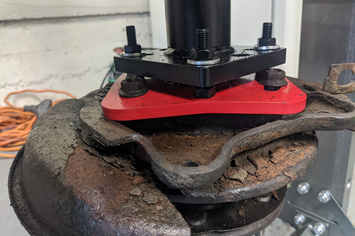

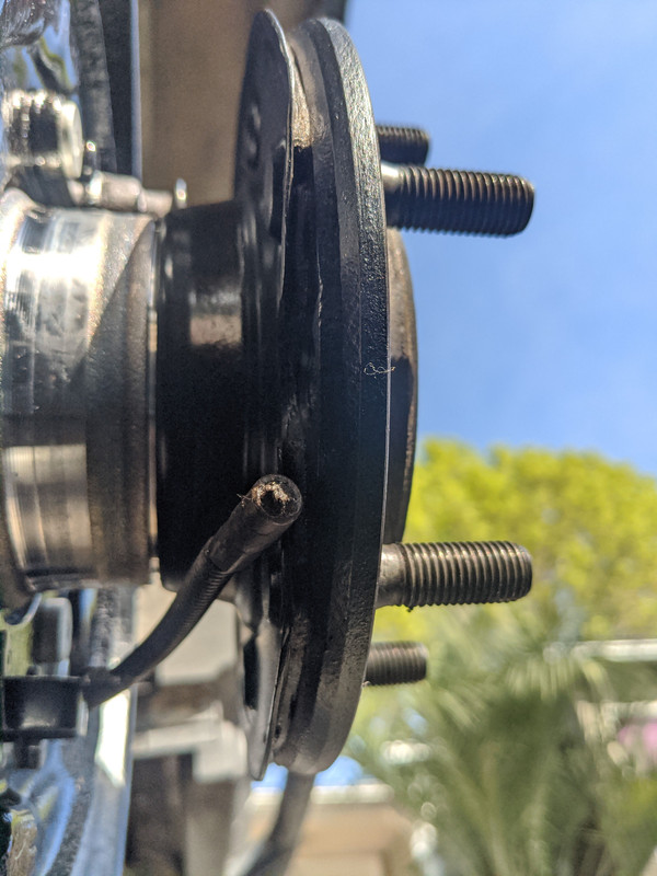

    Trying to get a stuck ABS sensor, I managed to damage ABS sensor ring. Initially, I was hoping to just change out axle seal that was leaking, but once that damage was done I had no other choice but to do a complete overhaul of both sides.
    It was a difficult decision to make. I understood that no matter what, I will have to bite the bullet and get it done.

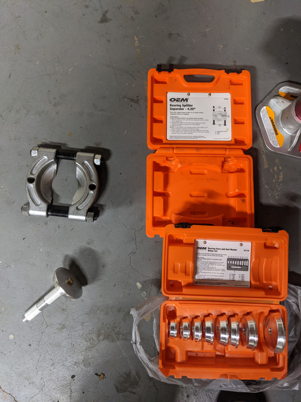

    Using wheel bearing puller turned out the easiest one for me. AutoZone is just around the corner, and you can't beat their loaner tool program. I loaned wheel bearing puller and bearing race.
    I didn't like using bearing race as a race to install the axle seal. Instead I used the part of the wheel bearing that was left on the axle shaft after wheel bearing was pressed off. It seems to be the tool of choice for many, as Instead of hitting in the center, it allows you to hit along side of the seal. It makes it easier to make corrections, plus you can see exactly where you are hitting.

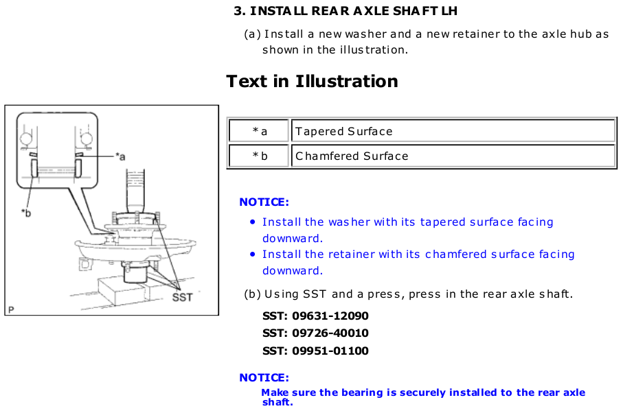

    Notes from the Repair Manual
    Rear Axle Shaft Removal: pg 1325
    Orientation of the Washer and Spacer: pg 1331
    • Install the washer with its tapered surface facing downward.
    • Install the retainer with its chamfered surface facing downward.
    • Torque for 4 Wheel Hub Nuts: 44 ft-lbs (pg 1332)

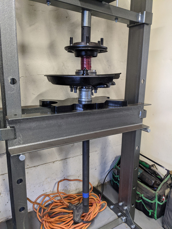

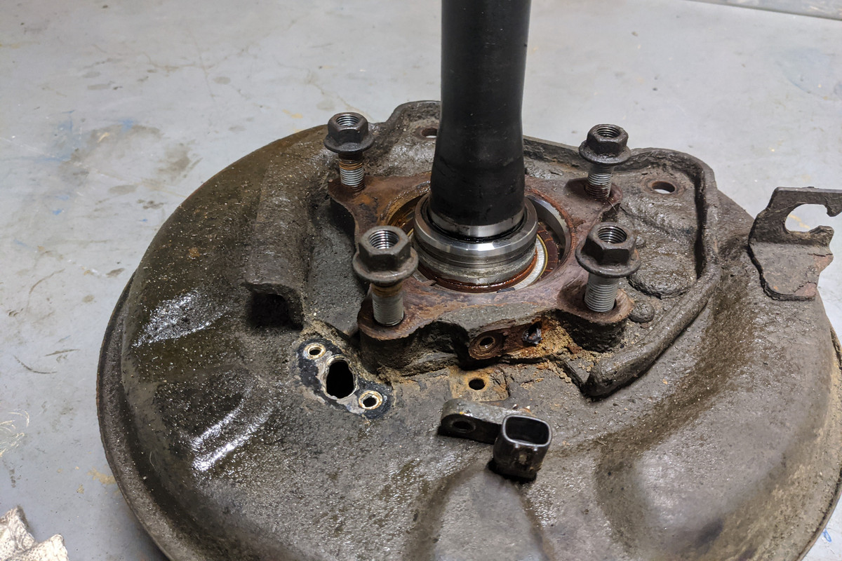

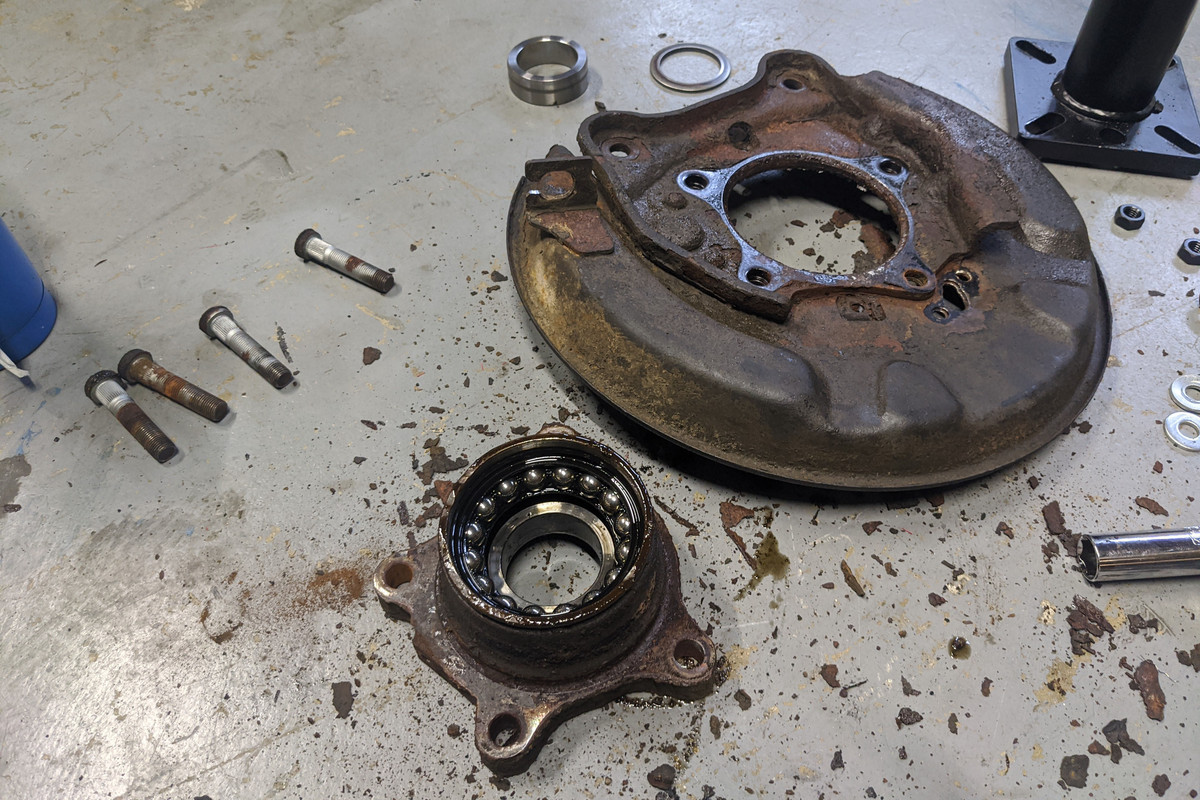

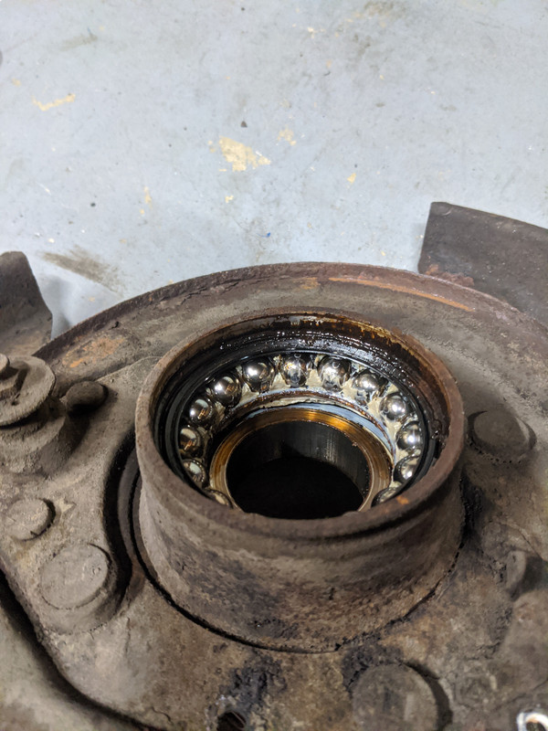

    Pressing the wheel bearing off with 20 ton press was not as easy as I imagined. The harder I pressed, the more the red plate bent under tension. I ended up using torch to heat up the wheel bearing until it was red hot, and then pressing it off the axle. It worked like a charm.
    With a loud bang not only the wheel bearing, but also all the rust on the dust shield came off. The red plate on the specialty tool was bent, but still usable.
    Condition of the wheel bearing after 185k miles.
    All the parts, including hub studs were rusted and had to be replaced. I just hammered everything out without a second thought. The guy in the first video directly hits the studs with a mallet. I would not knock out hub studs by hitting them directly with a mallet. Upper threads may get compressed, making it impossible to screw on a flange nut. Ask me how I know.

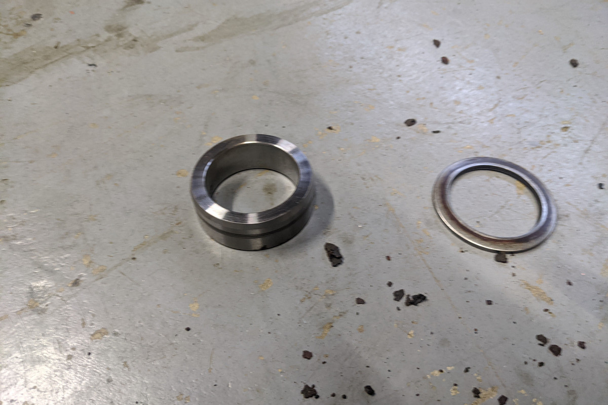

    Condition of the spacer and the washer. The spacer had a noticeable grove, and the washer was rusted. I replaced both of the parts with new ones.

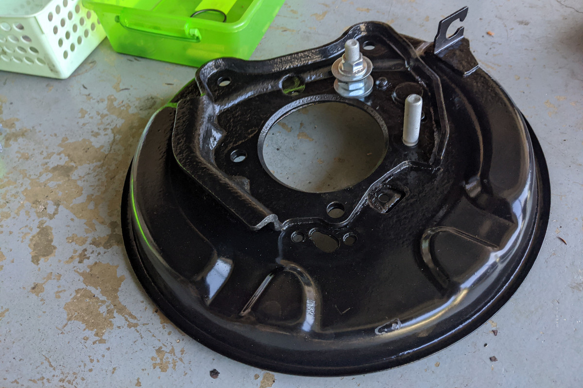

    After a few hours of work, I managed to clean up all the rust from the axles and brake shields using angle grinder with wire wheel attachment.
    I decided to paint all the parts with several layers of paint. Wheel bearings have been ordered through NAPA, whereas other parts through Toyota dealer. I went with aftermarket ABS sensors from RockAuto. All the parts should arrive next week, and will be time for assembly.
    I already purchased 1-1/2" pipe coupling from Home Depot to drive the new wheel bearing onto the axle shaft, just like shown in the first video. It fits great over the hole on the metal support plates, and is also an exact fit over the spacer.

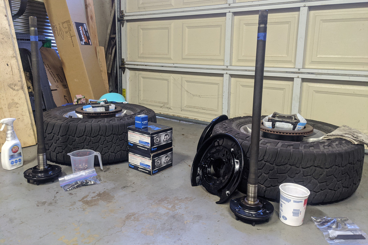

    What was supposed to be an axle seal replacement slowly turned into complete drivetrain rebuild.
    It took a while to get all the hardware for rear axles. Someone on their side read number 8 as 3 and I ended up recieving only 3 nuts to secure the hub to the axle housing. I ended up reusing the old one, which were still in good condition.

    Wheel bearings pressed in very smoothly. There seems to be a debate regarding using the grease to press new wheel bearing onto the axle or press them on dry. I decided that I will be using grease on everything that gets pressed.

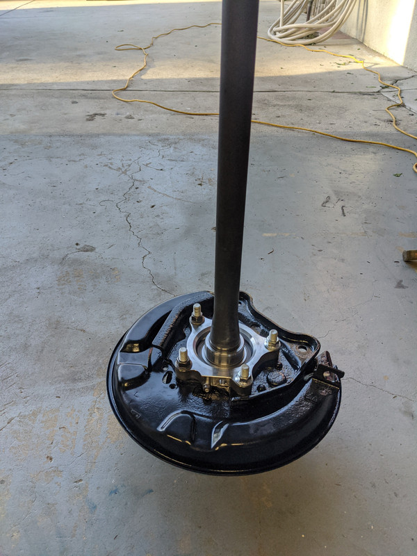

    Completely rebuilt rear axle assembly.
    New axle seal in place. That is where it all started.

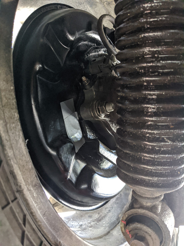

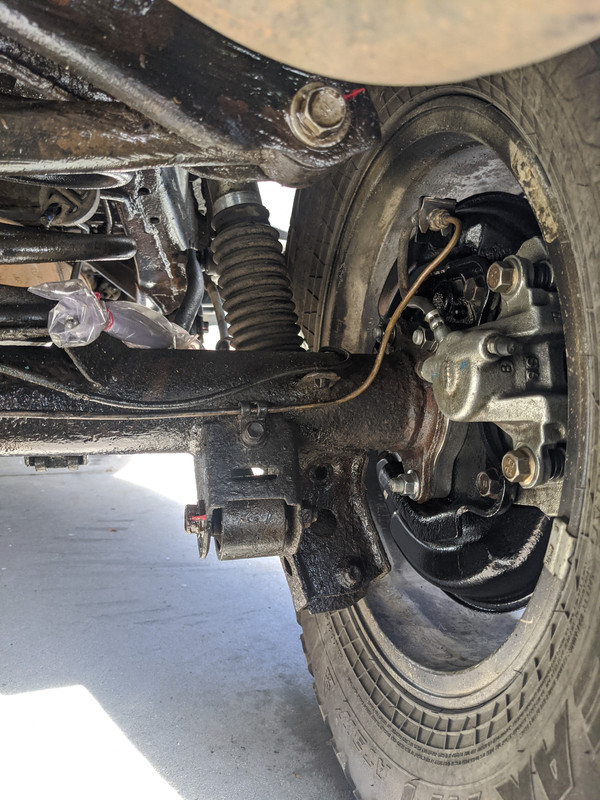

    Rebuilt rear axle assembly installed into the rear axle housing. The thing that is wrapped in a plastic bag is the parking brake cable.

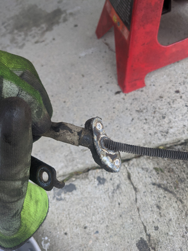

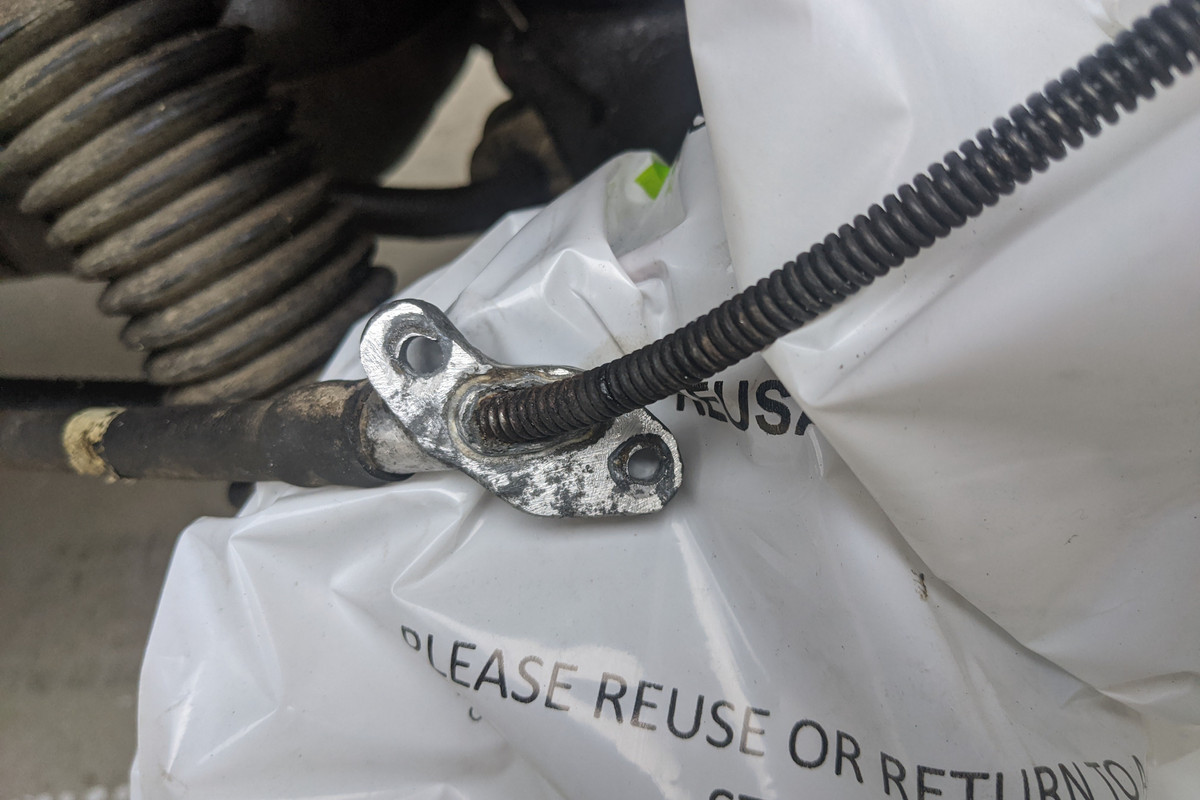

    I ended up removing parking brake cable completely because of my previous experience of driving around with it loose. It eventually gets caught by the spinning axle and stretched beyond its limits. I also decided to hold off on installation of the parking brake assembly because of another issue that I discovered when axles were already in place. There is cardboard material that is sandwiched between the part of the axle into which studs are inserted and a thin metal sheet. I am not sure what the name of it is and why it is there. Anyway, it got soaked in gear oil so the extent that gear oil is still slowly dripping down into the rotor where the parking brake assembly is located. I decided to let all the oil drip down as the axle spins, otherwise I will ruin another parking brake assembly by coating it in gear oil.
    I just removed the cable, wrapped it in ziploc bag, and secured it with a zip tie. The next time I do an oil change, I will install new parking brake assembly.
    I taped up the hole with duck tape to prevent dust from entering the parking brake assembly housing.

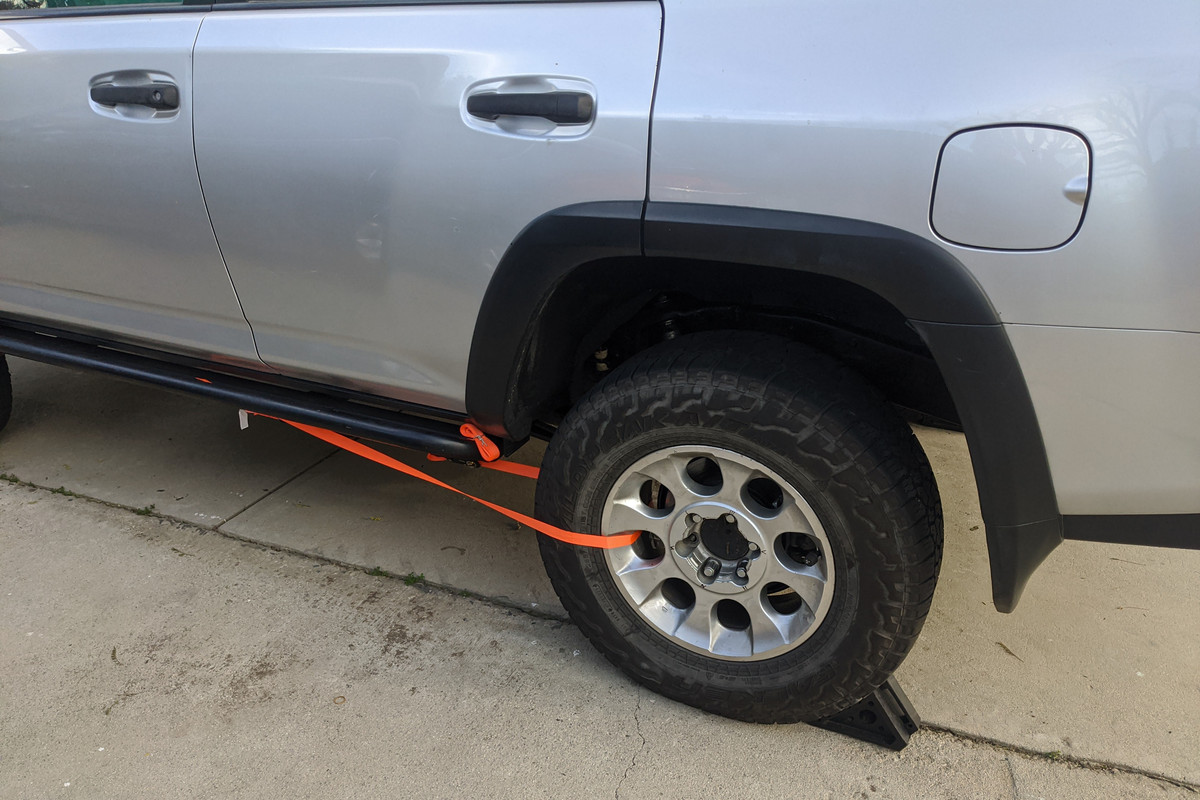

    For now I am using ratchet straps wrapped around the wheel and secured to the rock sliders. Seems to work better like a charm along with wheel chocks.
