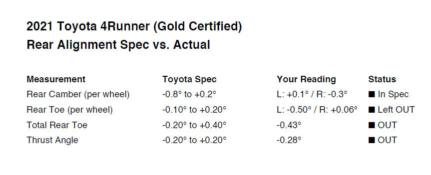

    I purchased a Gold Certified 2021 4Runner sr5 Premium. I put new tires on immediately with an alignment.
    The rear toe on the driver is .5 ... which seems very off to me. Attaching the alignment report. Should I be concerned about this and fight the dealer to correct that? All I can think of is a bent suspension component or bent axle. Just seems way off to me. Toyota spec I think is .1 - .2 max.
  2. Sep 5, 2025 at 10:01 AM
    1,048
    a half a degree is an awful small amount
    no its not supposed to be there so yes i would start fishing for more info and data
    check everything under the body, look for signs of repair, damage, body shop work, see if it appears to have been in a wreck, fixed, then traded in.

    It’s a non-adjustable spec that is actually out of spec, so it’s definitely not right.

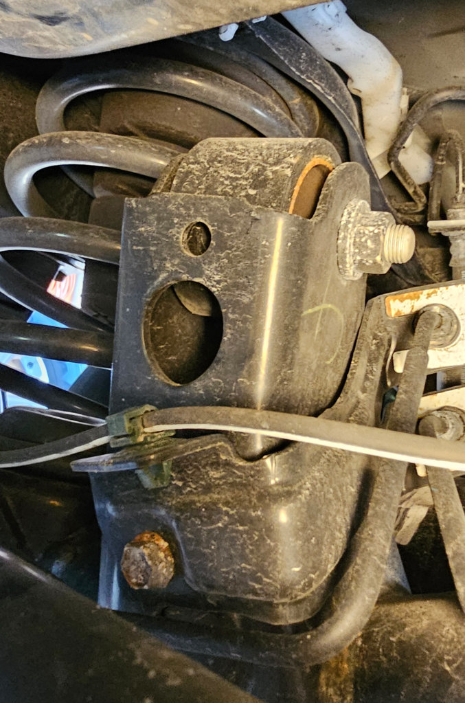

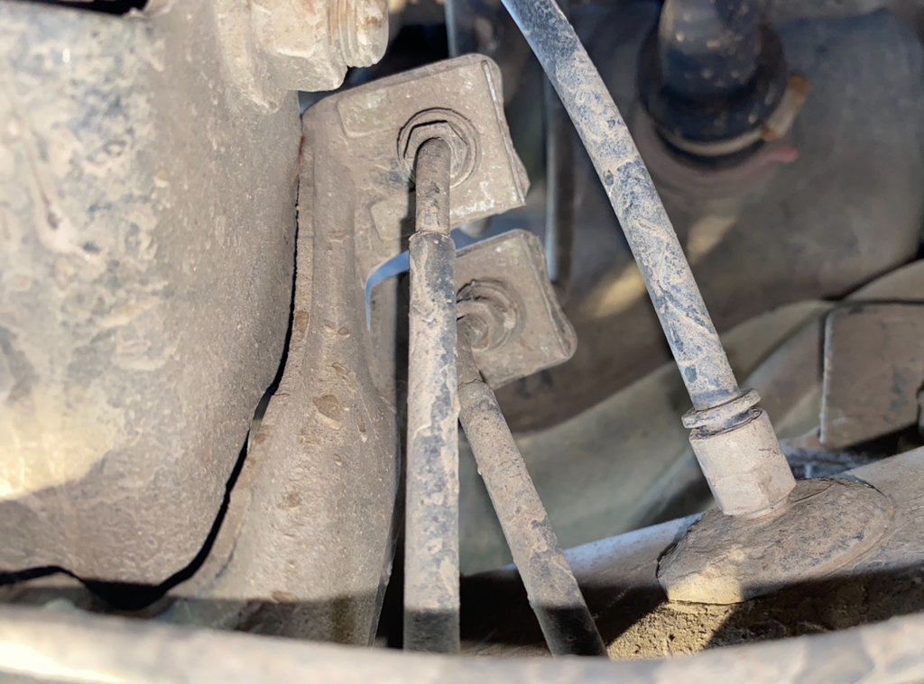

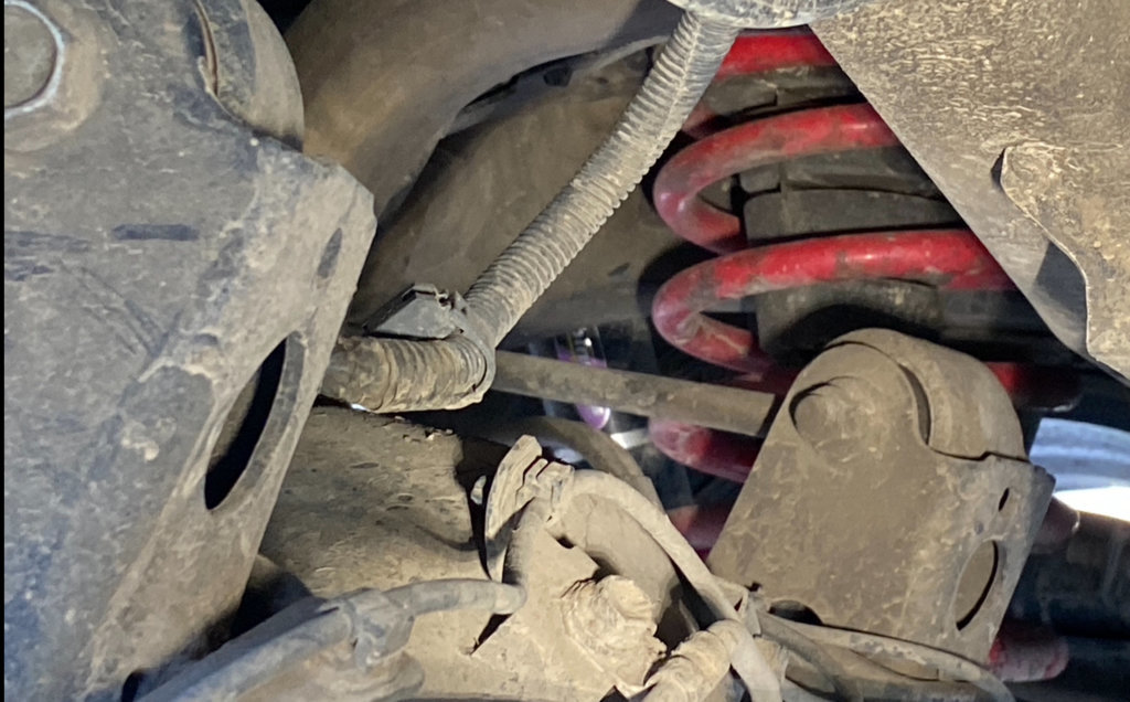

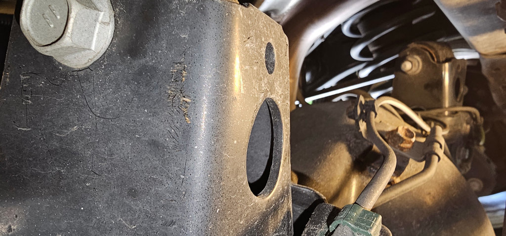

    Is there anywhere you can find out what they meant by “right rear axle”? The rear is one “solid axle” housing, that has the differential in the center, with a left and right drive axle shafts that run inside the axle housing. It would be weird that an accident would damage an axle shaft inside the axle housing without the entire solid axle housing to get damaged/bent. Although I doubt you could bend the axle housing without damaging everything connecting it to the frame, and maybe the frame itself.
    In any case, if an accident was the reason for replacing the right axle driven shaft (or whatever they truly replaced), there are other things that may have been damaged/bent as well. One of the two drag links that connect the axle housing to the frame could be bent, or the mounting brackets that are part of the frame that hold the drag links could be bent. Or the bracket mounts on the axle housing. Or the bolts that hold it together are bent.
    Do you have any pictures of the drag links and the brackets?

    Half a degree is like a difference of 1/8" across the rim diameter. It's quite a lot.

    Curb rash can be just an incompetent parking job. Considering the RH axle shaft was replaced and toe looks good, maybe it needs the LH axle shaft replaced too.

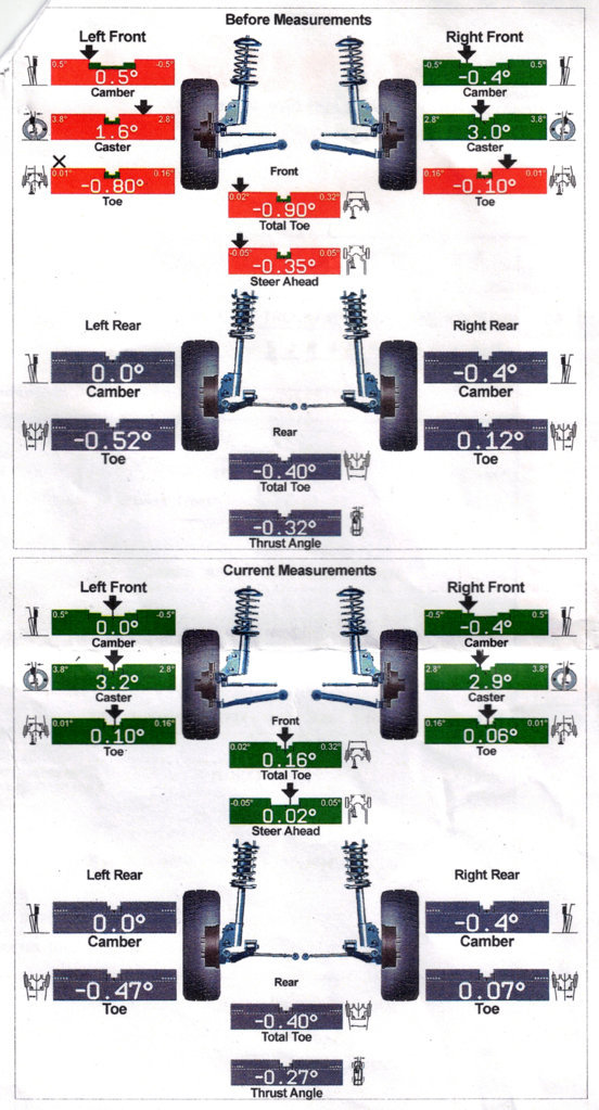

    This is the full alignment sheet. I picked the truck up and had to immediately bring it back because it was all over the place. The alignment I posted earlier was after I added two new rear tires a few weeks later. With the front alignment corrected now and 4 new tires. The rear toe is noticed and makes it pull to the right a little. Also feel a slight vibration in the wheel. But take a gander at how bad the front was when the dealer delivered it to me. Crazy work.

    Alignment machines measure and compensate for that during setup.

    Yes. Older machines you needed to mount the heads on each wheel, level and lock it and press the bottom for it to lean position 1, then rotate each wheel 120 degrees and do it again. Then 120 degrees and donut again. Then go back to where you started. The next generation you’d mount the heads and roll the car backwards a bit till it tells you to stop then forwards again. The newest machines you just set it up like a foot and half back from the correct location on the alignment rack and then roll it forward into position. It’s gotten faster and easier to physically perform but it compensates for variance in the sensor mounting and damaged wheels.
