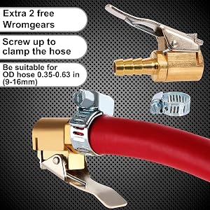

    I replaced the entire hose on mine, but I used a similar piece for clipping onto the valves.
    One thing to keep in mind is to not run the compressor while it's not attached to a tire as those types of valve attachments don't allow air to flow through when they're disconnected. This could cause damage to the compressor or the hose.

    The drawback is the compressor is now throttled by two shrader valves instead of one. For less restriction, remove the existing threaded air chuck and install a barbed one like this: https://www.amazon.com/Toolwiz-Inflator-Straight-Compressor-Connector/dp/B07YWWHCHN/ It secures to the hose with a worm clamp. The valve is normally open, so you can run the compressor without the hose attached to a tire.
    Of course, it's only worth doing to compressors that you frequently use to air up tires at the trail exit. Otherwise the threaded chuck is good enough.
