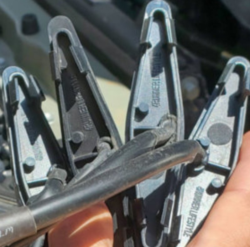

    I have mine tapped directly into front side running light. Only come on when running lights are on. I believe it's the green wire of the running light I tapped into. No more Janky fuse tap BS. Super happy with it. Got the idea from a video but can't remember which one. They only slightly and quickly mentioned it and I was immediately out in the garage. Works perfectly!

    Got mines from Lifestyles. Used Fuse Tap into INJ
    3 Years now. No wiring/fuse Issues.

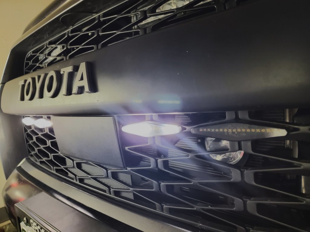

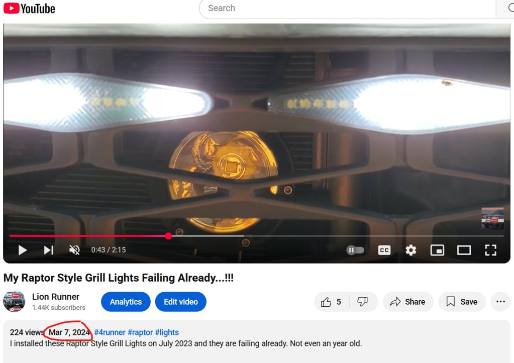

    Mine didn't have much luck. Installed July end 2023 -> put in trash on early March 2024.

    those grill lights are nice. What did you use for those (brand)
  12. May 29, 2025 at 1:51 PM
    5,641
    4runnerlifestyle . com

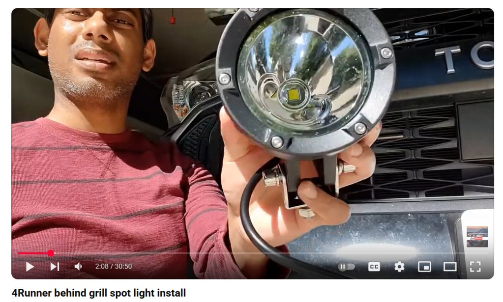

    no the other ones behind those by the radiator (yellow)
  14. May 29, 2025 at 5:38 PM
    5,641
    Oh, those are just Auxbeam 4in spot lights from Amazon. Its the yellow chip reflect as yellow. But they are really white lights.
    Here's the one I bought- https://amzn.to/43kqoeT

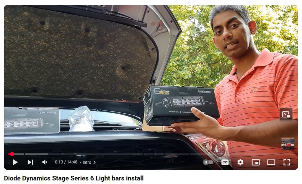

    The top row lights are Diode Dynamic SS6.
