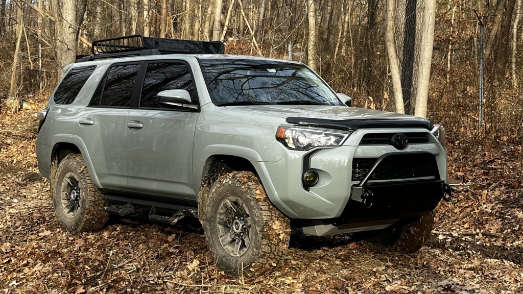

    if your 99% street, Id lean towards my set up. Check out the details in my info page. I looove my setup. Been on several 1000 mile family trip loaded for vacation and ride quality imo is amazing and i have stock ucas. No bmc, no trimming and kept all mudflaps in place.

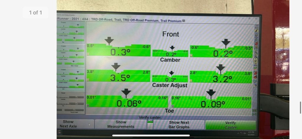

    +1 on stock UCAs. I have dobinsons IMS suspension with the 302s up front and 599s(a little shorter than what you’re going for) in the rear and this is how it sits on 275/70/17s. I ended up with about 2.5(maybe even a bit more) up front and was still able to get a good alignment. I’ll probably lower the front a smidge in the future to account for rear weight as I add it... Or put a bumper on:spending:
    tinkerer’s adventure has a great video on UCAs.

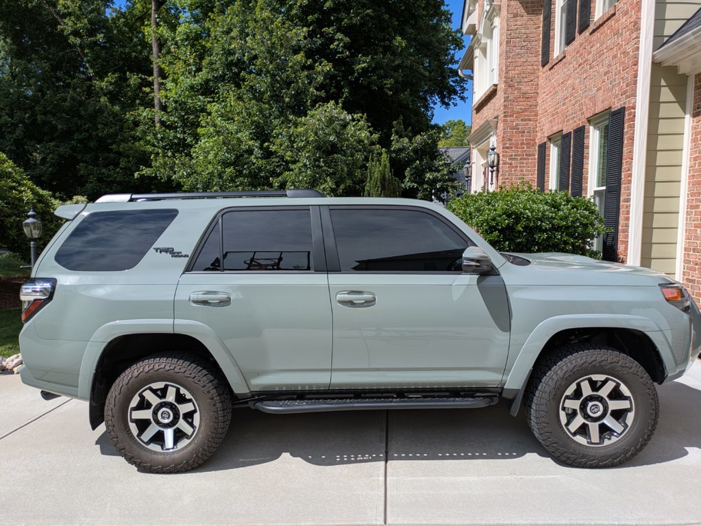

    Hey we both have Lunar Rock!:)
    Firstly, Thank you for the reply and posting the pictures to give me an idea!
    I went and took a look at your info page! I think the reason you're not rubbing and not having BMC with 2" and 1.5" in the rear is that you're using Stock TRD OFF ROAD wheels. I ordered Method MR305 17" 0 offset and I think it has more dish than the stock TRD off road wheels. And that is exactly why I want to lift mine .5" in the front and 1" in the rear more than yours so I can fit the Wildpeaks(285/70/r17) without rubbing after removing the mud flops and tiny bit of trimming in the front fascia!
    Thanks again

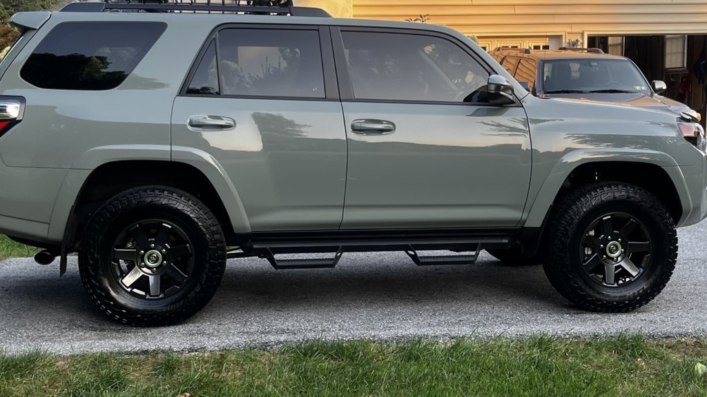

  13. Jun 18, 2025 at 9:42 PM
    4RUNNERHULK
    4RUNNERHULK [OP] New Member
    Jun 16, 2025
    #47615
    21
    2023 TRD Off Road Premium
    WOW It sits really good on those 275's! Love it!
    Thank you for the reply!

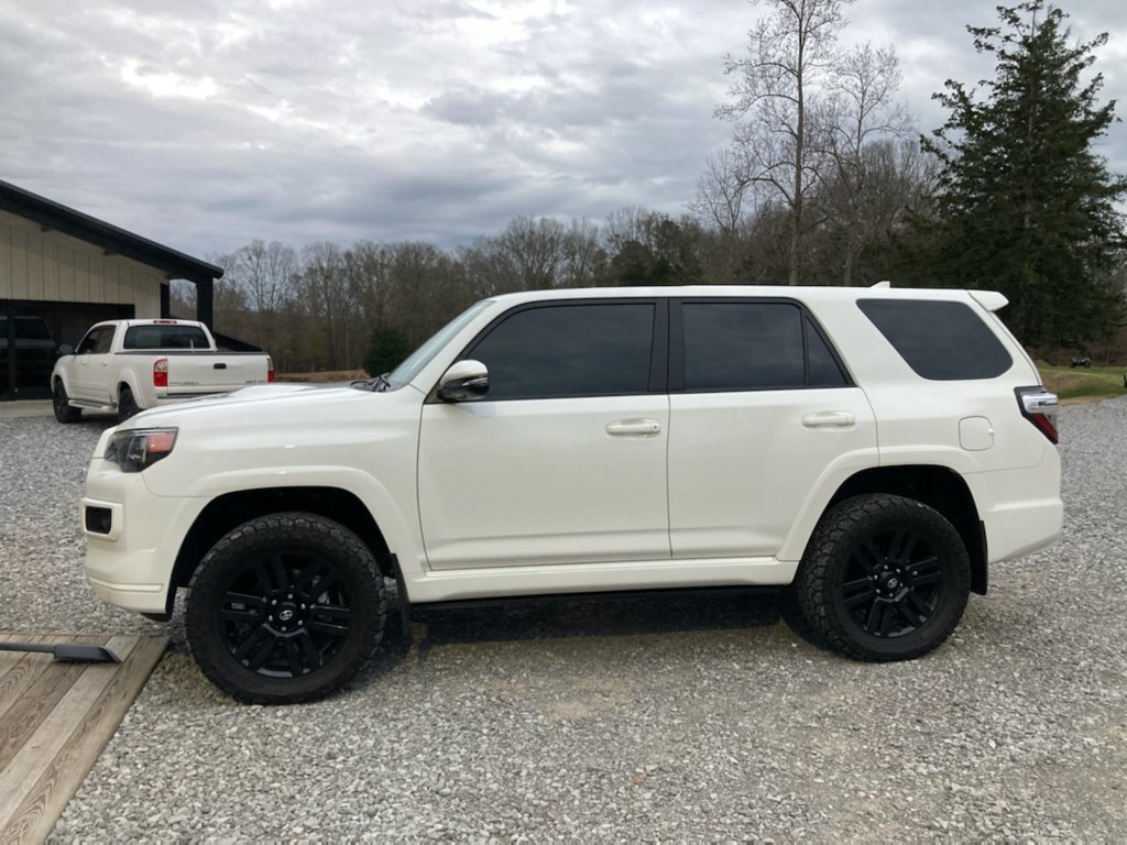

  15. Jun 19, 2025 at 6:31 AM
    884
    Maybe not the best picture in the world, but this is +2.55" up front and +0.875" in the rear on 305s
    This "APPEARS" that the rear fender has a bit more room than the front, and that is correct it does. There is about 0.5" extra gap on the rear fender vs front fenders. If you are looking at fender gap it looks like i'm +0.5" in the rear
    HOWEVER
    When you put this vehicle on concrete and put a 4ft level on the running board is is EXACTLY perfectly level. The lower window trim rakes upward slightly, but the bottom of the rear window is level with the running boards.
    This vehicle has weird physical lines, the lower window trim is not on the same plane as the lower rocker and the fender gaps dont mean level. This vehicle is absolutely dead nuts level on concrete, the running boards and lower rockers are dead on flat with the ground. The lower window trim rakes upward and the fender gaps make it appear rear high slightly. Dont go by fender gap alone use your measurements.
    +2.5" up front and +1" in the rear is basically dead on level on a 4wd even though the fender gaps wont match.

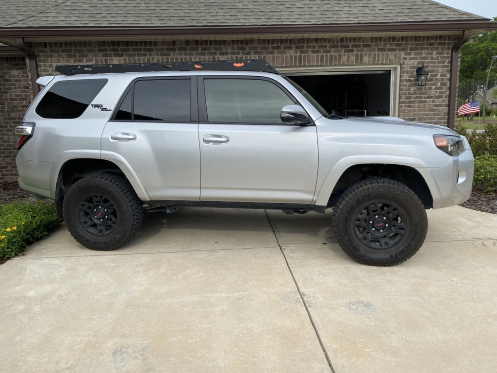

    94hokie
    94hokie New Member
    Mar 22, 2024
    #39296
    416
    23 TRD ORP Lunar Rock
    My driveway isn't perfectly flat, but here's a pic of mine with 2.7" up front and 1.5" in the back.

  21. Jun 19, 2025 at 8:14 AM
    94hokie
    94hokie New Member
    Mar 22, 2024
    #39296
    416
    6112's in the front (extra weight springs) with 5160's in the back. Rides great.

    This is PERFECT! Exactly what I want! Hey thank you for sharing the picture! I LOVE IT! I will go 2.5" Front/ 1.5" Rear!
    Do you mind sharing where you got the Running boards?

    94hokie
    94hokie New Member
    Mar 22, 2024
    #39296
    416
    Those are 5 degree with top plate RCI sliders.
