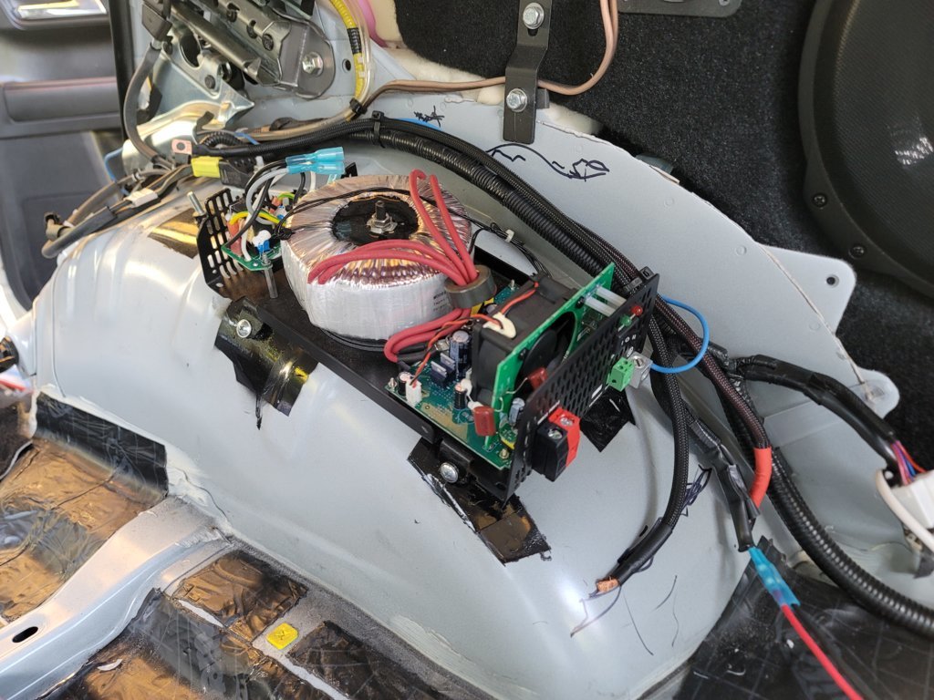

    I'm looking for ideas or thoughts on best placement of a 700-800 watt pure sine inverter that would need to be accessible in the cargo compartment.
    Not install instructions, but thoughts on what placement may have worked for you. It will mainly be used to charge a ecoflow and I'll be happy to get 300-400 watts out of it.
    I'm really not looking to replace the stock. Too much cutting.
    My initial thought is to simply mount it to the drivers side molle panel over the tire hump, (I have the caliraised molle set.)
    Thoughts? Anyone have any locations that might no be as obvious.

    Under a seat

    The Ecoflow can't charge fast enough on 12V DC?

    The 4runner rear 12v only puts out about 80-90 watts.
    the ecoflow will charge at 400 watts AC (if available), but not on a modified sine inverter
    Not a problem when I'm driving a lot each day, but if I only drive an hour or two between campsites 400 would be a lot better

    If you're just charging an ecoflow why not get their alternator charger or, if you have the knowledge, a DC power converter that will do the same thing? Going DC-AC-DC is gonna lose you 20-25% in the best of cases so getting 400W means you'll be drawing north of 40A. You could do a 12v to 36v converter with much better efficiency and charge via the solar/DC port. Tinker's Adventures on YT has a video and was the first to discuss but others have copied it in their own vids.

    The answer to the first (their alternator charge) is price/cost - the difference in that and a renogy 700 watt pure sine inverter is $400
    As for the second, I'll look into that. Thats something I had not thought about - I'll take a look. Thanks!

    As others noted, do not do the inverter to charge the EcoFlow. It’s an inefficient way to do it. I did what a few YouTubers did following the example of Tinker’s Adventure channel. Get a Victron 12/24V DC/DC converter, and then use its output to connect to the EcoFlow solar port (make sure it’s the right connector). I hid mine in the other rear wheel well, drilled a hole for the fan cooling on it, and 3D printed a vent for the hole. I put a gasket up top for the output solar wires, so everything almost looks stock.

    What gauge wire did you run from the battery?

    I used 6 awg multistranded pure copper. I probably could’ve used 8 awg and would’ve been fine, as the amp draw from the battery is just over 30A in real world use. I did initially try running the ground wire to the frame, but it didn’t play well (connection got really warm). So I just ran the ground wire right to the battery and it’s perfect.

    This is what I'm gonna do. Thanks!

    Forgot to note, the Victron 12/24 DC/DC Converter has pair of small wires to act as an on/off switch. You can loop the wire into itself with a physical switch, or run a signal wire to the right hole provide it is 12V. Currently I have that set up to my Switch Pro switch panel, which automatically powers off when the truck isn’t running. Otherwise you could end up pulling power from the battery when the vehicle is not running, so be sure not do that. One thing I’m looking to do is for the signal wire to be connected to our stock inverter to detect when the existing dash switch is on. That button switch only stays powered when vehicle is running.

    This is my favorite place I've seen this stashed! I'd worry about dog fur/debris under a seat. How does it hold up temperature-wise down there?
    Any cons you've found with your setup to date?

    You should join the ecoflow groups on FB. I've seen the alternator charger go as low as $199 when it was on sale. I personally have the alternator charger mounted on the driver side rear molle panel.

    Hopefully my response isn’t too late, but I fear it is (sorry haven’t been on here for a bit). Initially it did get warm in there so I did make 2 holes for airflow, and had 3D printed vent covers. But never had any issues once I ran both + / - cables back to the battery. I have since swapped it for the EcoFlow alternator charger, which at the time was $599 Cdn.
