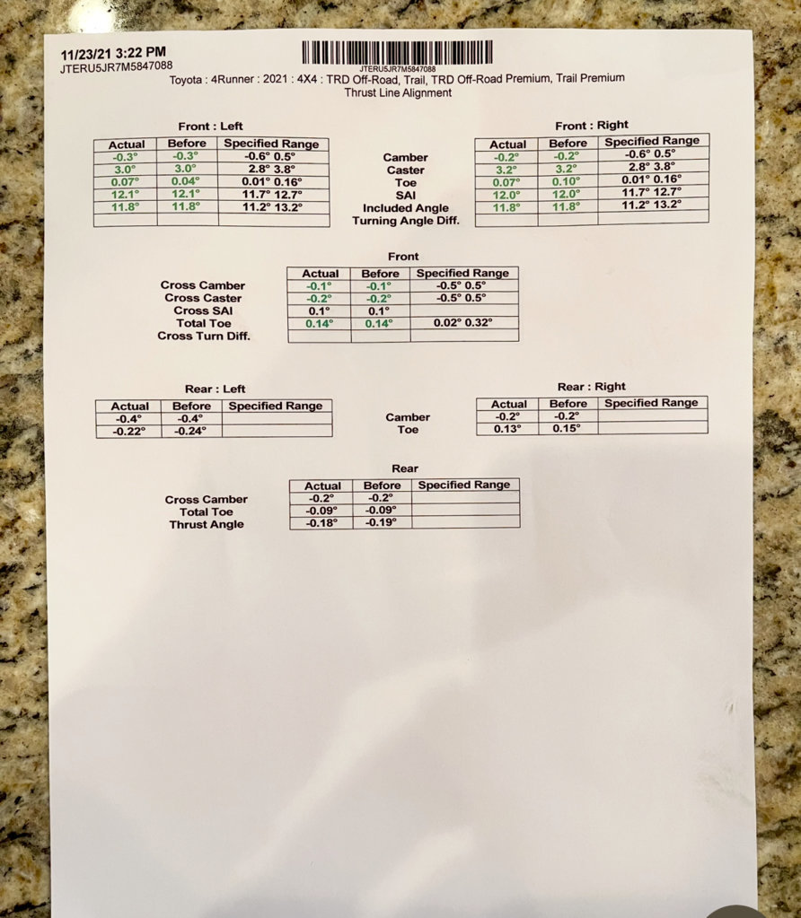

    Mine is leveled 1.6 - 2.0 (approximately at the time) lift. Here are my specs it drives great. Don’t know why 2 shops can’t get it right on your vehicle.
    EDITED: Removed incorrect photo, inserted correct photo.

  3. Jul 23, 2025 at 8:11 AM
    1,473
    Damn, that a great alignment report - everything green. Why did you take it in though, it seems like they didnt even touch anything in the before and after.

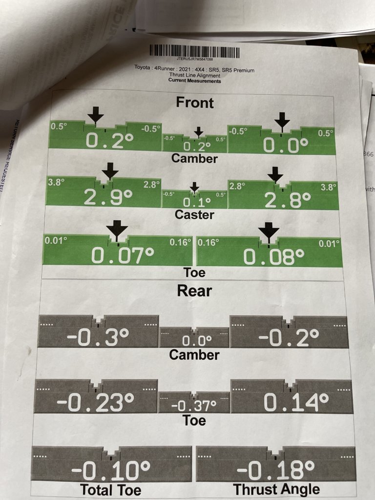

  4. Jul 23, 2025 at 8:28 AM
    835
    My mistake, wrong one. That was just a checkup of alignment.
    Here is a shot after 6112’s installed.
  5. Jul 23, 2025 at 8:39 AM
    1,473
    lol, you made me feel better. I too take my 4R in for an alignment check as well. Learned the hard way by having to replace two Toyo AT3s that sill had a lot of tread on them but were damaged because of it being out of alignment. Now every 6 months I take it in for a check. (the checks are free)

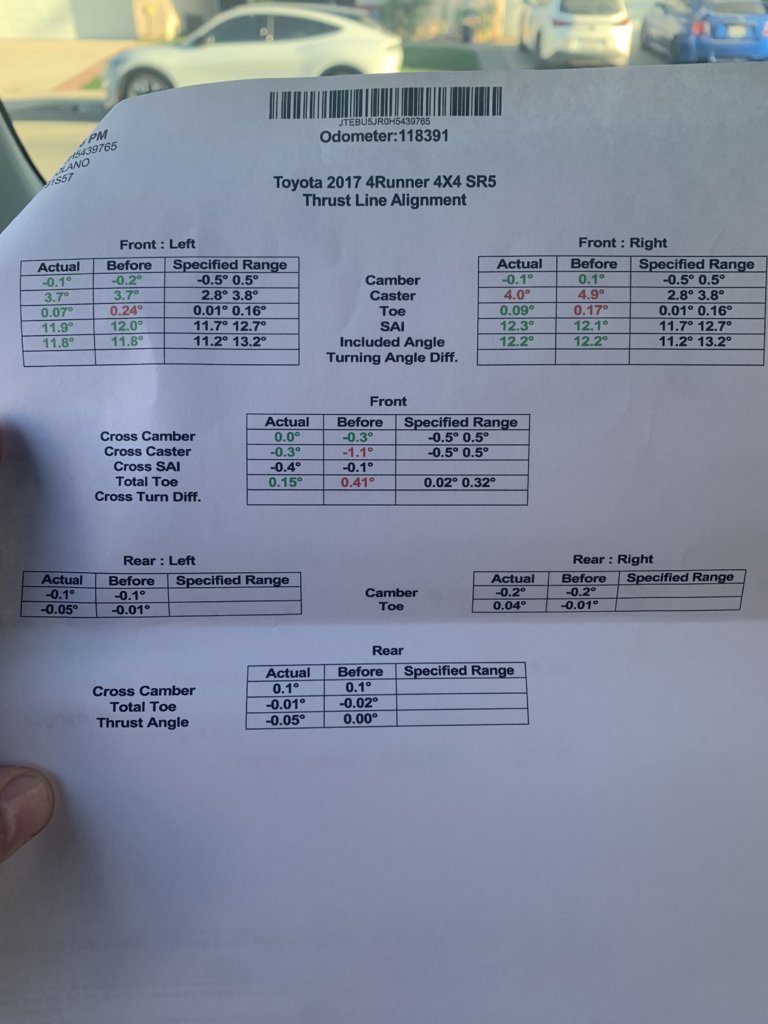

  9. Jul 28, 2025 at 6:43 PM

    Rizzle87 [OP] New Member
    Jul 22, 2025
    #48164
    8
    Israel
    2017 SR5 premium
    2” pre load collar lift Billstein 5100s all around 285/70/17s
    these are my specs before and after Toyota. Then I had to take it AGAIN for another one and it still feels like I have bump steer and I’m all over the place

  11. Jul 29, 2025 at 3:28 AM
    9,194
    Welcome from Wisconsin! These specs are all over the place! The guy that does my alignment is a outside the box thinker, and when the specs were where they were supposed to be, the mechanic and I went for a ride... pulled to right, steering wheel like yours. He drove it and said he had an idea. we went back to the shop, he applied his fix and it drove like a champ! Now both sides are slightly different, compensating for crown in the road etc. Tech is a stock car racer.. part time and does his own alignment on the car. Not saying you have to find a guy like this, but you need to find a tech with the outside the box attitude. Can't set the camber on these guys? You most certainly can, just because the tech works at Toyota doesn't mean he knows squat! Find a "real" alignment guy and you'll be happy... hopefully.

  18. Jul 29, 2025 at 4:26 PM
    835
    Maybe someone else can explain why the camber is so far out.
    Is it the " 2” spacers and Billstein 5100s on stock shocks (coils ?), and new freedom industry UCAs" ?
    OP... Are the spacers actually 2"?
    Wouldn't that lift your front 4"?
  19. Jul 29, 2025 at 5:23 PM
