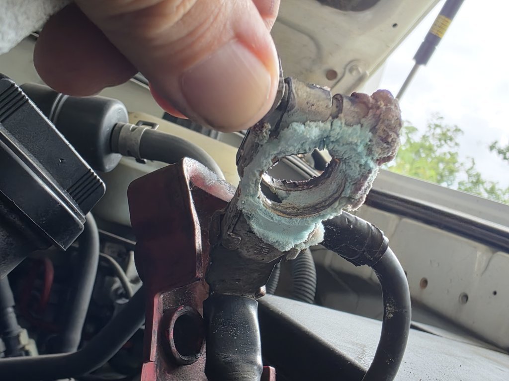

    I'm hoping and praying that this was a culprit. I got it all cleaned up back together. It is starting up on its own but the battery seems weak. Going to let it run for a while and then get the battery and alternator tested

    I clean this battery terminal up put it all back together jump started it and drove it for about 2 hours. Since then I have turned it on and off probably 15 times and it's running well. I'm taking it to AutoZone tomorrow to test the battery and alternator. Thanks again for all of your input and help on this. I love this community

    That post looks eaten up probably from being little loose and moving.
    If it were me I'd get a new battery.

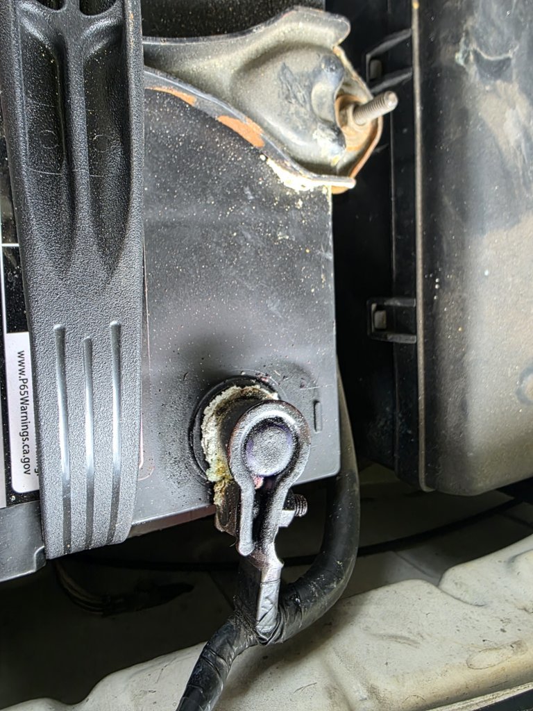

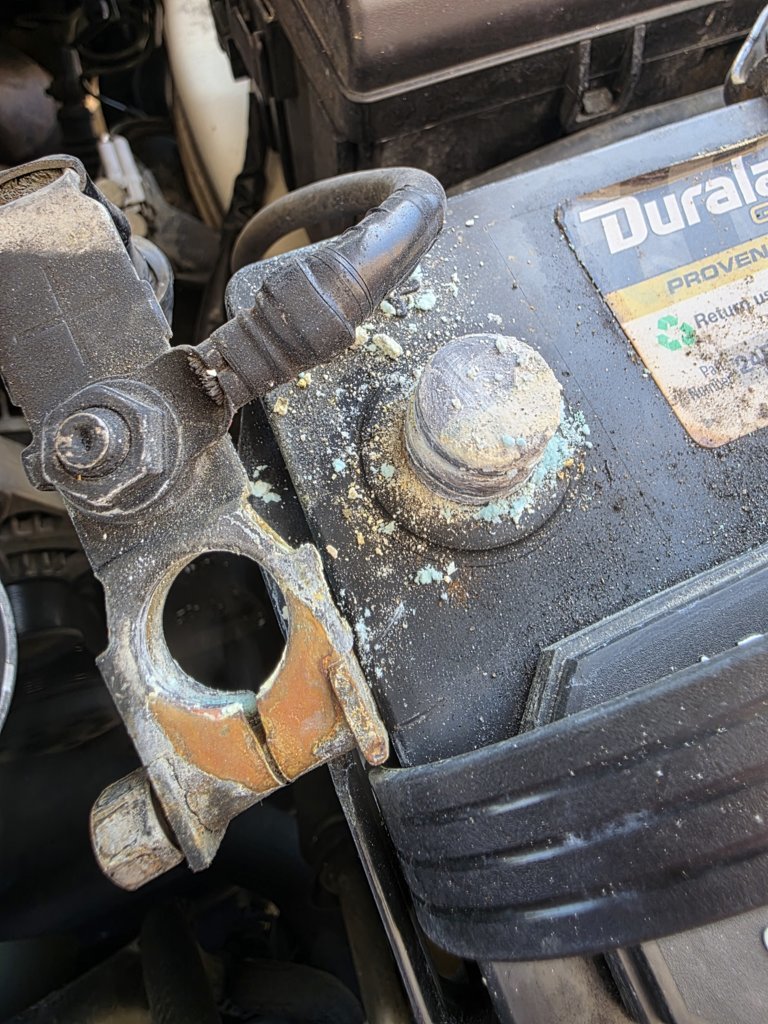

    If the battery is over 2 years old replace it. 2.5 to 3 years is the average life span. For the corrosion on the battery terminal, keep an eye on it. Once the terminals corrode, it etches the metal and it will never fully be gone even after cleaning it. A replacement terminal from Toyita runs about $30. We just had the same issue this week on our kids 2006 that had intermittent starting issues. It ended up being the starter but had corrosion and the battery was replaced a month ago. The battery was swapped too because it was most likely leaking since both terminals had corrosion.

    11.9V is essentially dead. That may be the voltage but your car will require high amps to crank the engine. Any ignition battery brought down that far has been "deep cycled" and it's life has either been severely shorted or ended.
    The battery is used to start the engine. Once the engine is started the alternator supplies all the power your engine requires. If the alternator is bad the engine will run off the battery until it's nearly drained.
    Keep the terminals clean. Always remove the negative terminal first and replace it last. Clean all the corrosion from the battery terminals and posts. Replace the terminals and coat them with grease to prevent air getting to them.

    To neutralize the corrosion so it can't do anymore harm, mix water with baking soda 3 to 1, pour it on the corrosion/battery acid, the baking soda will settle so agitate the mixture as you're using it, it will fizz until the corrosion/acid is neutralized so keep doing it until no more fizz with a fresh mixture, very important is to use a wire brush to help breakup the corrosion until it's all gone, I would do this with the battery removed so you can also do the battery tray, you can flush everything with fresh plain water, clean the battery if it's not new before installing it, and of course do as advised and coat the clamp liberally with a anti corrosion substance, I used Dielectric grease on my battery connections about 4 years ago and there's is still no corrosion on any of the connections.

    I agree with using Toyota brand batteries, but the corrosion will happen with any battery. It's a chemical reaction. Here's what Google says:
    "Car battery terminal corrosion is primarily caused by the chemical reaction between escaping battery acid vapors and the metal terminals, often exacerbated by moisture and loose connections. This reaction forms a white, blue, or greenish powdery substance (often copper sulfate) that disrupts the flow of electricity"
    Like Auseeker said, clean 'em up and cover 'em up. Make sure there's a tight connection before covering with grease.

    I totally agree, neither do I, but the reaction is a chemical one so just buying a Toyota battery and not performing maintenance is not going to prevent corrosion. The battery shown by the OP is definitely lacking any kind of maintenance. A loose terminal connection will cause that, among other things.
