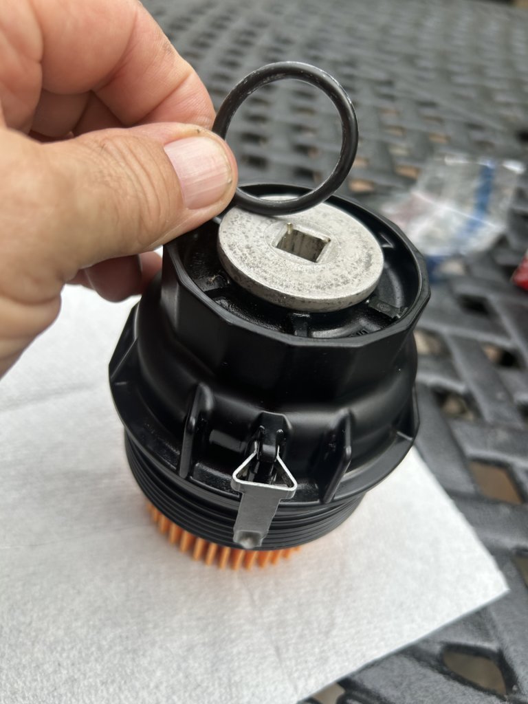

    Greetings all, I’m changing my engine oil and filter this evening on my 2022 T4R.
    Regarding the plastic oil filter cap with the drain plug on it- I have not been changing out that small black rubber O-Ring on that drain plug when I do my oil changes. Is this something I should be doing? I don’t want the O-Ring that’s been on there for my previous 4 oil changes to go bad and start leaking.
    Let me further explain- I AM NOT removing that drain plug from the plastic cap at all when I remove the cap. I just unscrew the filter cap as a whole and lower it- the oil that’s trapped up there just drops in to my big drain pan on the floor. Then I just clean up the cap, put the new large O-Ring on the cap by the threads, and reinstall. So I’m just worried about whether I should be replacing that small O-Ring from time to time just so it doesn’t go bad / deteriorate, and start leaking. Right now, so far, I’ve seen no sign of leakage at that point.
    Thanks for any advice.

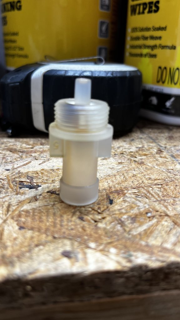

    Not sure why you wouldn't remove it and drain the oil out of the filter. Much less mess. IF you use the MotivX drain tool. The cheapo ones that come with the filters are worthless. But, if you choose to never drain the filter and remove that plug, there's no reason to change the o-ring. Good gawd, that must be an awful mess, but to each their own.

    Most dealer techs don't bother with the filter housing drain either, which means that O-ring doesn't get changed in 90% of 5th gens. If the O-ring isn't disturbed, it doesn't need to be changed. There are similar oil system O-rings elsewhere in the engine that potentially last the life of the engine if they aren't disturbed.

    My 2-cents, if it ain't leaking leave it alone.
    When/if you start to see leakage, (probably won't be much initially), THEN you can go ahead and put a new one in.

    I do exactly like you do during my oil changes.
    In the last few years, I have not touched that O ring and I don't intend to . Just crossed 200k.
    No leaks, no explosion, no engine turning into a ball of fire.

    I only removed the drain plug part for the first couple oil changes. Now I just put a socket extension in square hole and remove the entire filter housing. I haven’t had any issues yet.

    Like most other people said, I wouldn't even worry about that o-ring - it's a non-issue if you never remove the drain bolt.

    That O-ring does not need to be changed for at least 10 years if the drain plug is not touched. Even the large O-ring is good for at least 5 oil changes before it needs attention (as long there is no dirt contamination). Since the O-ring is included with the filter change it out at your leisure.

    every filter comes with the small cap o ring and filter housing o ring. I change both at every oil change

    You could probably go a long time without touching it since it’s not even the primary seal.
    That thing you gotta open up with the plastic tool has to leak first before the screw and o-ring enter the picture.
    I’ve done changes both draining the filter housing and not, haven’t really decided which I prefer yet.
