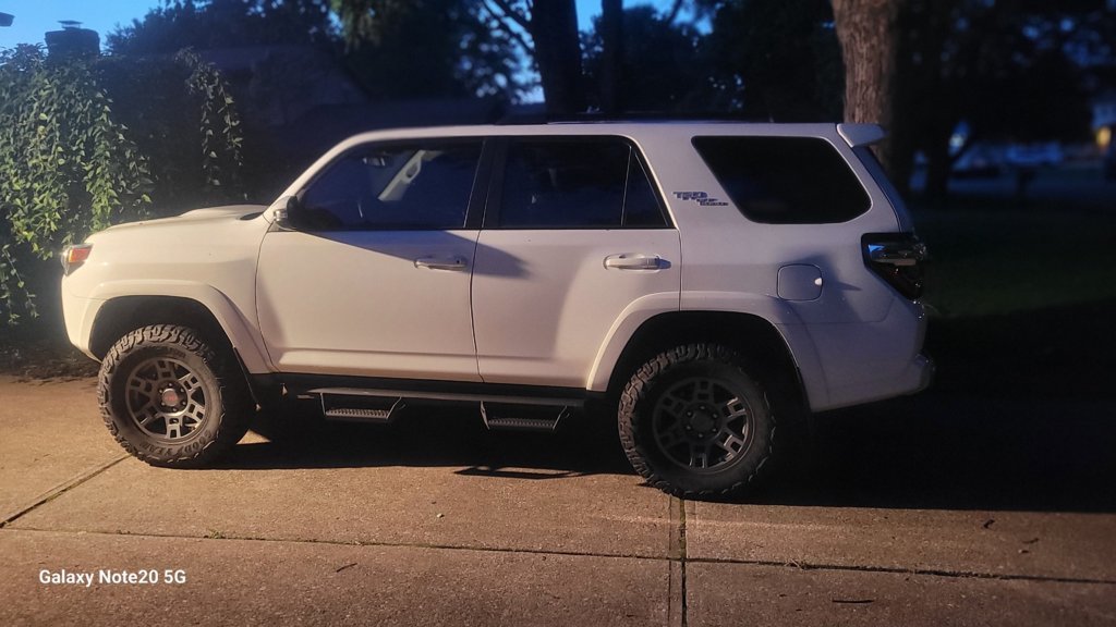

    I have a 2019 ORP. I ended up going with the Eibach Pro Truck stage 2. The coilovers spring clip is threaded so it can be adjusted height wise much easier (you dont have to disassemble the whole coilover to adjust height). Made a huge improvement in daily driving & in light off roading situations. Virtually eliminated the dreaded dangerous nose dive. Tows my boat more comfortably too.

    Got any pics ?
  17. Jun 19, 2025 at 6:35 PM
    Run4ever
    Run4ever New Member
    Jul 27, 2024
    #41849
    10
    White 2019 ORP
    Not a great one. Its almost dark in ohio! Lol
    It looks like all the other slightly lifted/leveled 4runners

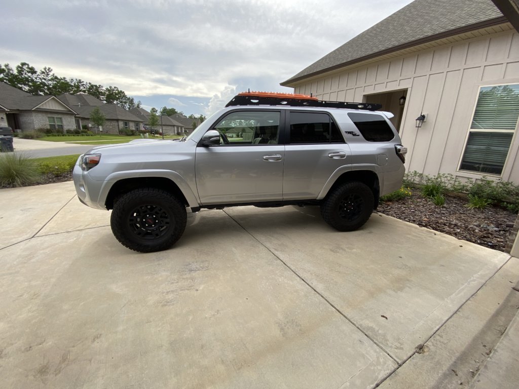

  20. Jun 20, 2025 at 12:07 PM
    tacomaccountant
    tacomaccountant New Member
    May 9, 2024
    #40334
    26
    Josh
    Florida
    2021 TRD ORP

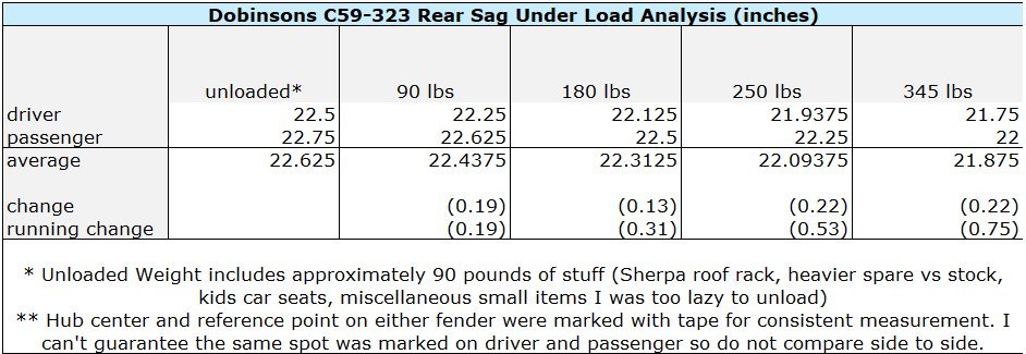

    I have a dobinsons IMS kit with C59-300 springs up front and 599s in the rear. I also have stock UCAs. This is how the vehicle is currently sitting on 275s. I honestly need to adjust the front down some because I wound up with a 2.5” lift up front rather than the 2 I had hoped for. Still… I have about .5” of rake left. As to weight loaded in the back, I did an experiment with these by loading plates into the back. I did this test with 323s before deciding to swap them for 599s to get a little rake back. As you can see, even “standard load” springs like the 323s, 599s, and 505s can take a fair amount of weight without massive sagging.
