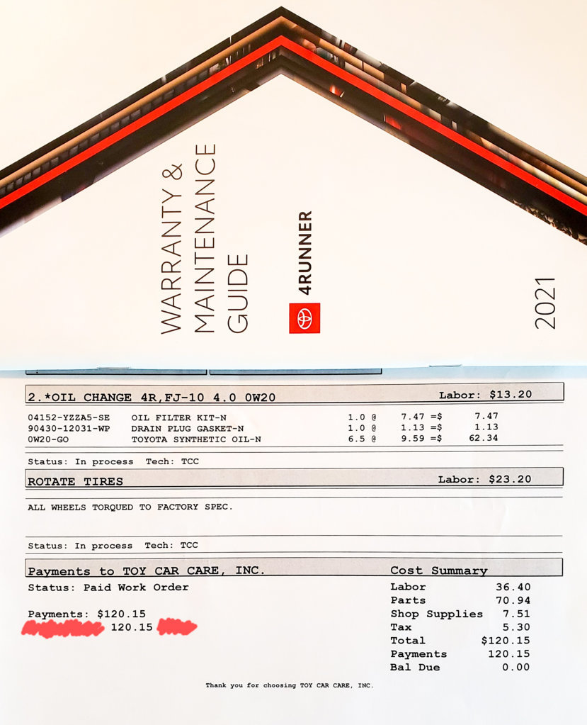

    Me personally don't like the mess, effort and trouble of oil changes and recycling.
    Here in Denver I go to Toyota/Lexus independent shop. From what I see from the front desk and per the bill they use Toyota Synthetic Oil 0w20. (I see those black Toyota bottles in the back / stores along with many other red&white boxes of toyota parts.)
    • cost for oil - 62.34
    • drain plug gasket - 1.13
    • oil filter kit - 7.47
    • labor - 13.20
    To me personally would like to spend $84.14 at a shop vs my effort and time.
    ***The Toyota dealership that I used to go for service charge about the same amount. $120-125 for oil change + tire rotation.

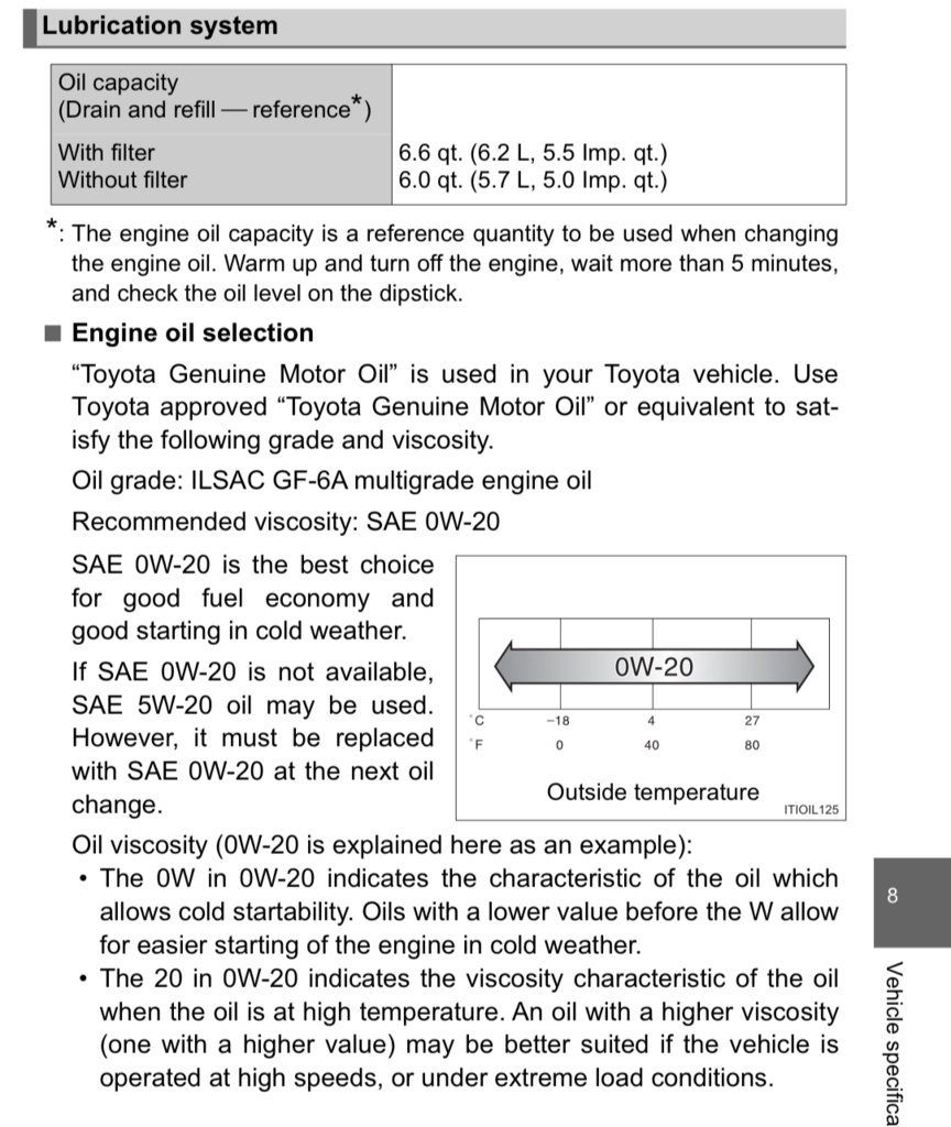

    It's in the owners manual.
    This. Synthetic 0w-20. Any brand that is recognized. That's all.

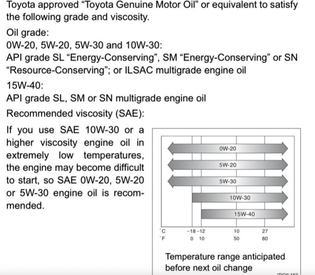

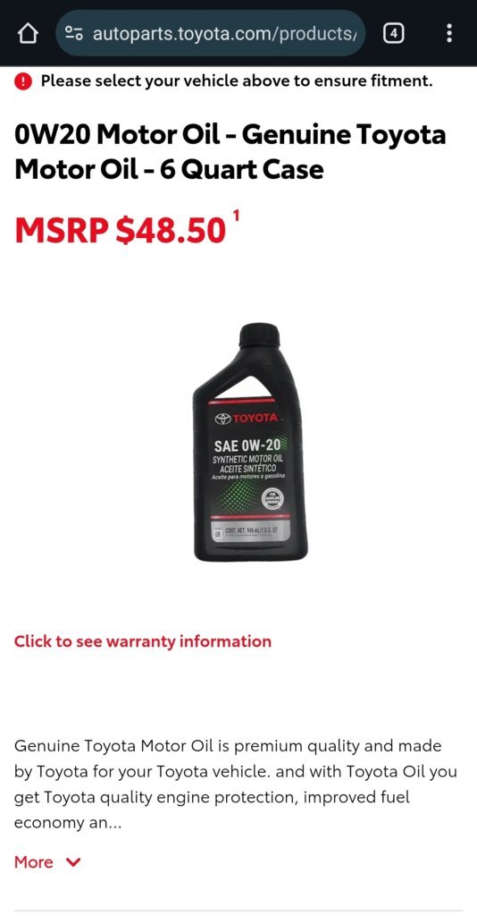

    May be upchange for Toyota oil might be how they make money? I'm not sure.
    (Used the maintenance book to cover personal info)
    (This the price I see for Toyota oil search by my zip code on Toyota parts.)
