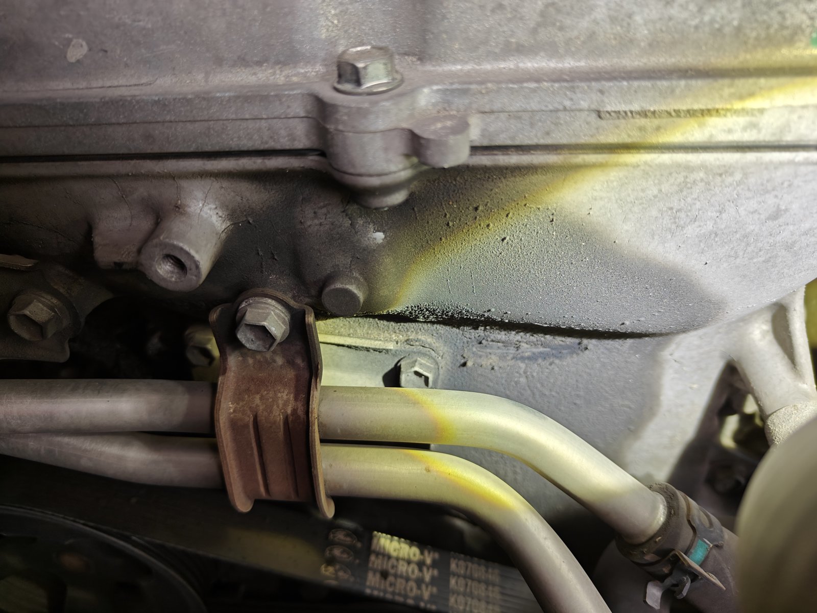

    I was replacing my power steering fluid when I saw this oil leak. By the looks of it, it's been leaking for a while since there is a lot of grime with it.
    I have read that it might be something as simple and cheap as timing tensioner gasket or very expensive/laborous as timing chain cover. But I am not too sure.
    Any idea or leads on this.
    Thanks.

  2. Mar 29, 2024 at 7:51 AM
    3,221
    Unable to determine from the pictures.

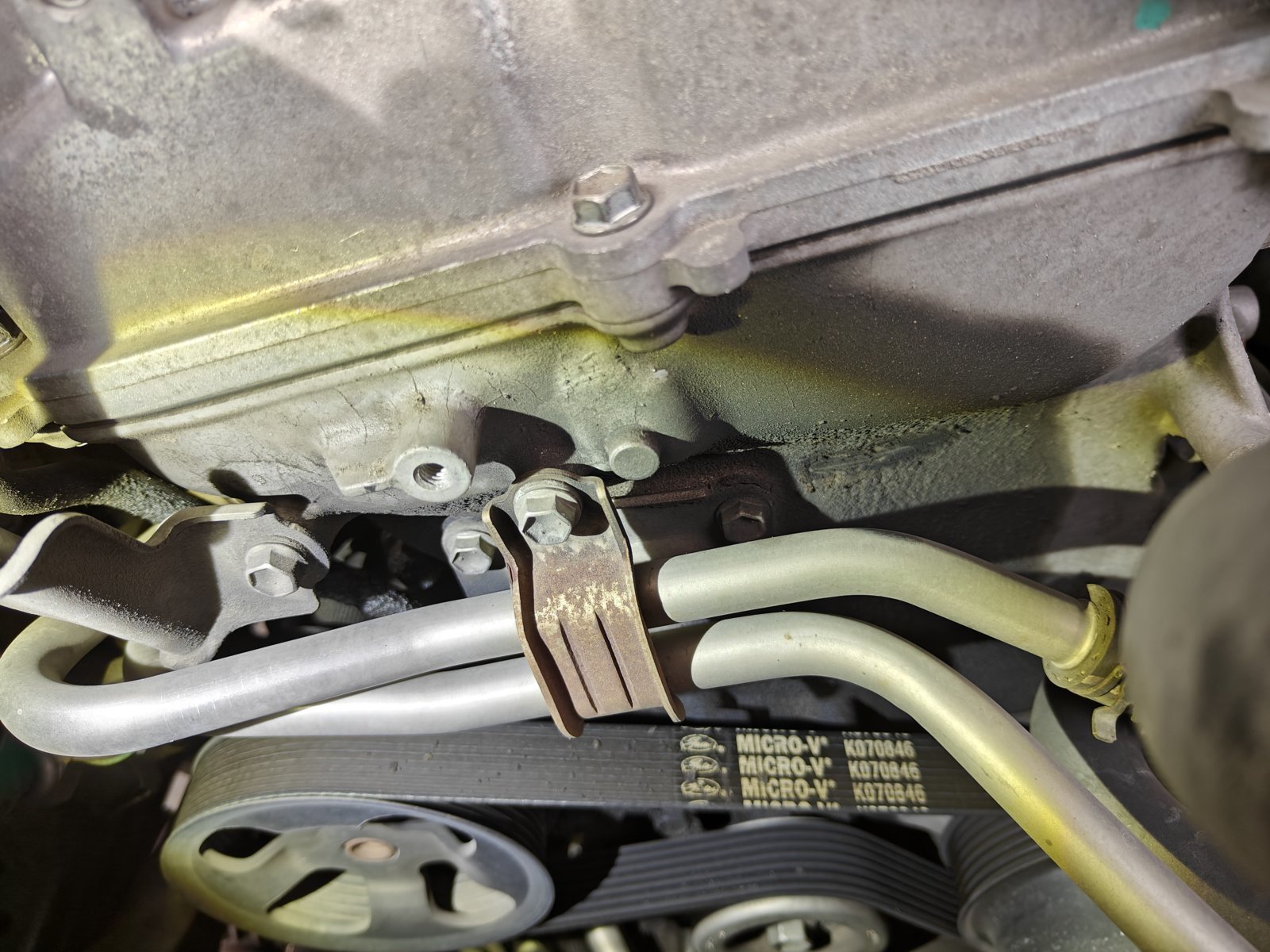

    I ll try clicking some better pictures

    Are you sure it's not coolant?
  5. Mar 29, 2024 at 8:00 AM
    7,111
    I imagine he's referring to the oily/grimy area behind the bends in those two metal lines...

    Uploaded some better pictures. Does not appear to be coolant. My coolant level looks alright. I was under the impression coolant leak leaves a whitish residue. Can't be power steering fluid. I just replaced it and this is covered in grime.

    Is that rocker box to head or head to block?
  9. Mar 29, 2024 at 8:34 AM
    3,221
    There’s a small plate on the front passenger side of engine behind the PS pump and I remember reading a post or video that said it’s a common leak. Might be worth a closer look.

    That's what I am hoping it is. It's the time tensioner gasket.
    I am going to clean the area and see what there.

    Spray some degreaser, wash it all off, monitor. It's slow seep. If it comes back, the gasket is $15 and it's not a hard job-see video I posted above.

    Wash it off and watch it.

    Just ordered the gasket. Going to wash it off and see what's happening there.
