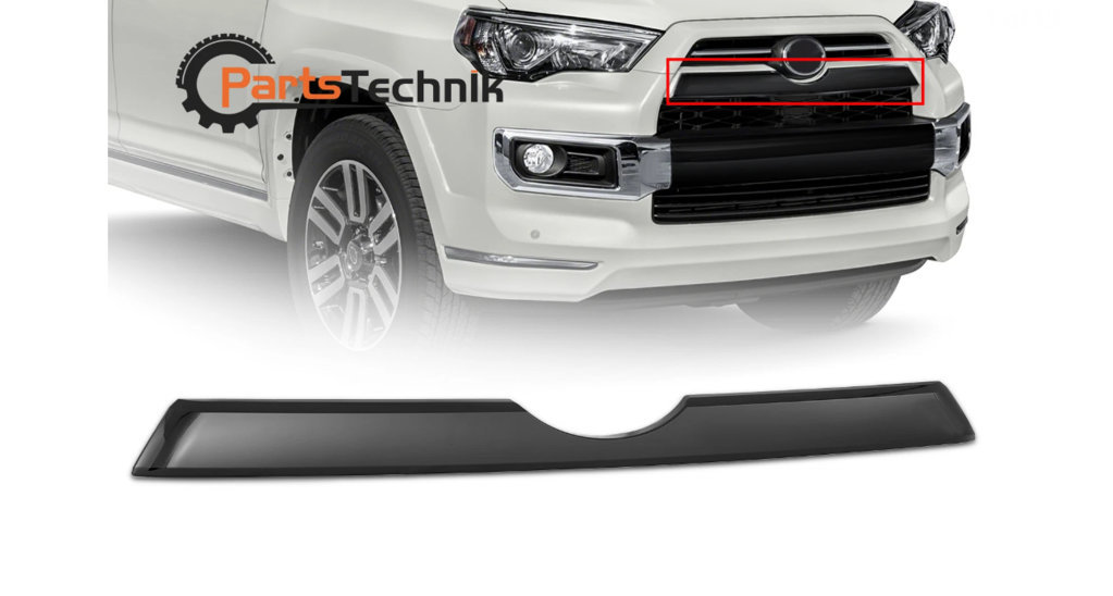

    I have a 2016 limited as part of getting rid of the front chrome pieces I picked up replacement black trim piece the one they fire right below the Toyota emblem. However the below piece that’s in the photo I cannot figure out how to get the chrome one off the bumper.
    Do I really need to drop the bumper to remove the old piece? Is there trick to removing these? I almost contemplated cutting the old one and breaking it off and installing the new but now sure what it looks like behind and if I’ll do damage to the fastening mechanism for the new.
    Any help is appreciated!

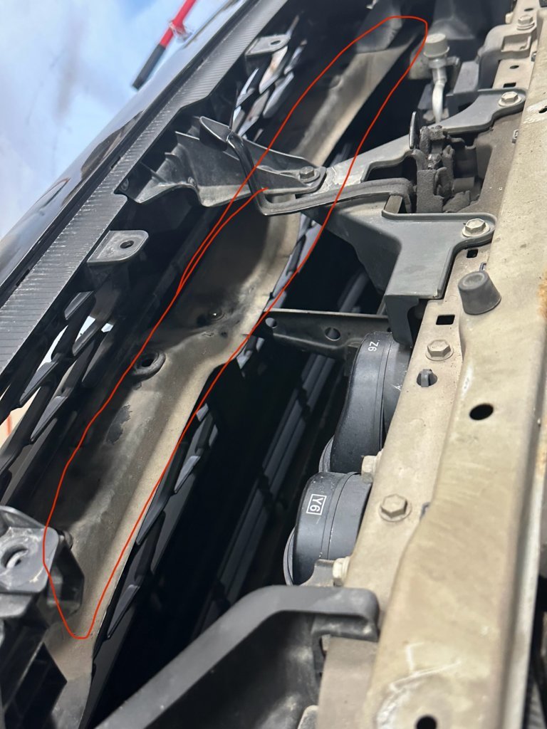

    Yes I removed that already but can’t see up under there as I can feel the clip but can’t move it, it seems to be those white type

    I’ll try the mirror - I have a mechanics mirror. I can feel the clip but can’t seem to apply enough pressure to get it to slide due to the angle I’m working…

    This metal part is what makes me not be able to see the clips.. the clips are below it tucked at the ends..

    Understand. Then it’s time to remove the front bumper cover or get the black overlays.
