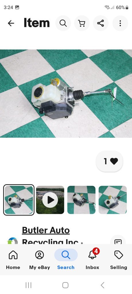

    Nope.. this is the electric 2013 the electric boosters acummulator and master cylinder are all in a assembly. If it was tge old style booster I'd have already replaced the master..those I can do. That's also why they want 1800 for the whole assembly or 800 just for tge master but is a mess to disassemble. They also sell the plunger itself that goes into the master from the pedal toyota 44 . This is what it looks like...insaneScreenshot_20250517_152457_eBay.jpg Screenshot_20250517_152457_eBay.jpg

  20. May 17, 2025 at 6:19 PM

    None
    I wish...I know how to do those..mine is that monstrosity in the photos.

    None
    This is a 2013 not vacuum booster that you are talking about. See pics above. It's two motors and master is in the center. It's electronic booster not the old round booster of the past. If that was the case I could do it.

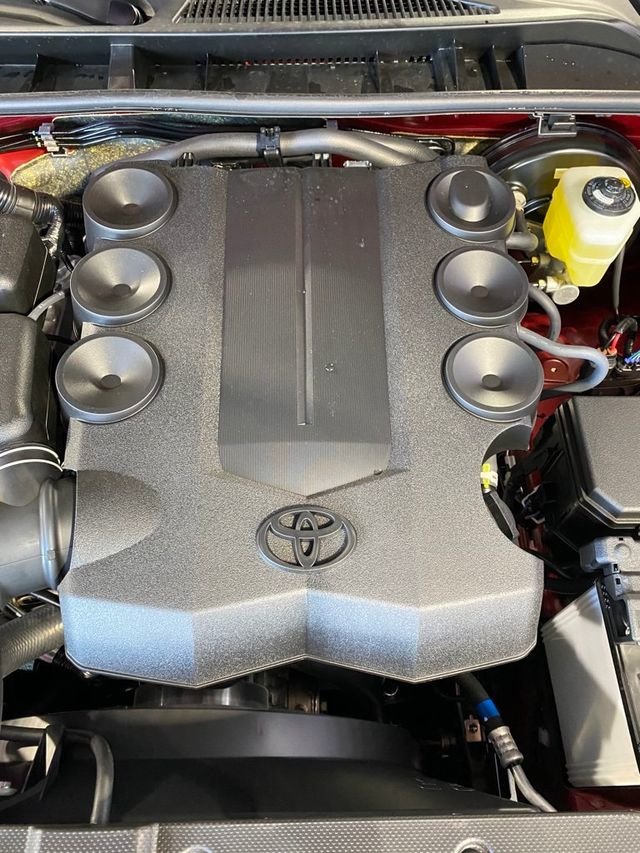

  23. May 17, 2025 at 7:17 PM
    TrueTexas
    TrueTexas New Member
    Jun 1, 2021
    #21753
    528
    The Woodlands, TX
    Ahhh. My bad. I thought you were saying it looked like the pic that @McSpazatron posted.
    I see your pics now. Haven't dealt with that kind before.
