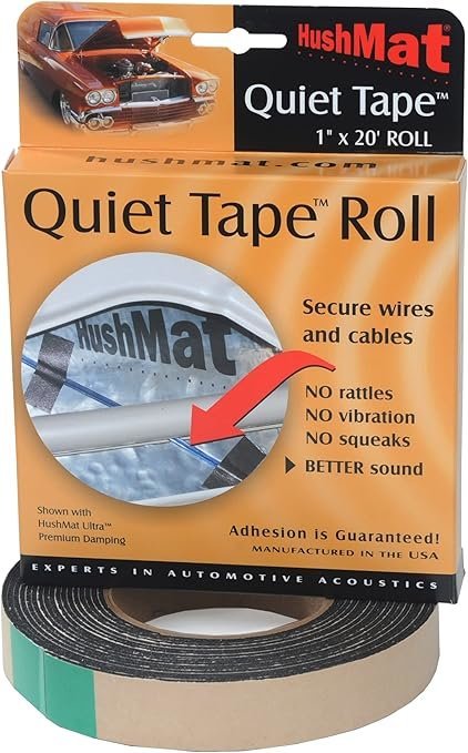

    Reviving a dead thread with an update. I had a mouse eat up my cabin air filter and pull off some of my foam weather stripping sound deadening I had used on the cowl. So I figured I would take it off and use something even better. I ended up using Hush Mat tape. The stuff has a great adhesive and one roll did pretty much everything (20 ft). I put this on every spot the Velcro was put on in previous posts and more. I tucked it in on the windshield tabs on the cowl with a pair of scissors, cutting it just before it would show as the rubber trim lay upon the windshield. Next I cut it in half in long strips and put it where the windshield would rest in the base flat part of the V channel with those tabs. I put about two pieces slightly overlapping on the lower section and on the three metal large tabs below the windshield on the 4runner itself. Basically get some and go to town anywhere you think it could make contact. I put the cowl on and went for a drive in the cold 40's out. The windshield was quiet, save for a small sticking tick sound, like putting the back of your finger nail on the windshield and sliding it up and down with pressure. I checked everything and was resigned I would have a slight sound still in the cold. The next morning I was pulling into the parking lot at work and the sun shone in just the right spot to show something I had missed this whole time. There was a small black wire pinned to the upper black portion of the windshield/A pillar/headliner. I used a trim tool to push it back in and under and two days now. Dead quiet. It seems the wire was pushed on the glass and as things shifted you would get that last sound. Hopefully This helps anyone who may need to do this. Also don't forget to do the lower portion where it sits on the fire wall and I recommend using two stainless steel bolts/washers/locking washer with a butterfly nut in place of those horribly loose plastic push retainers.
