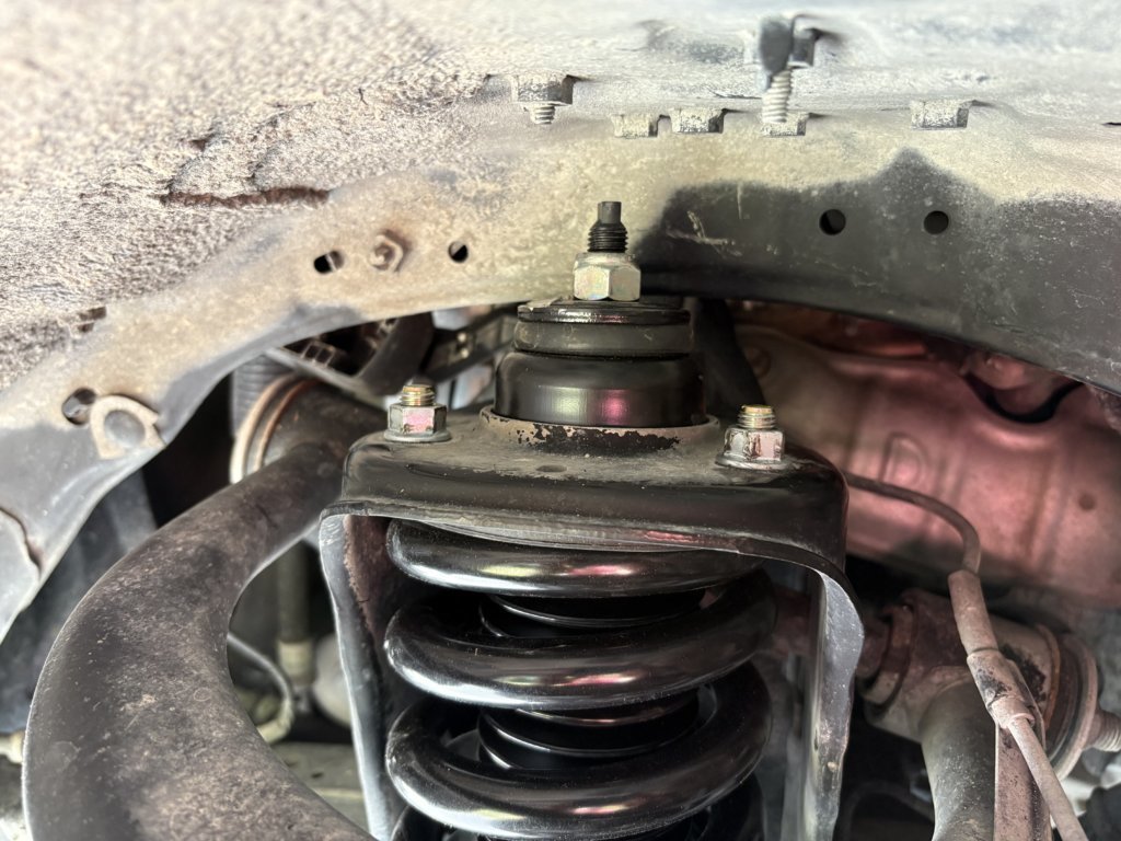

    Do have any pics of the front struts in place top and bottom where the coil sits? Maybe we can see something is off

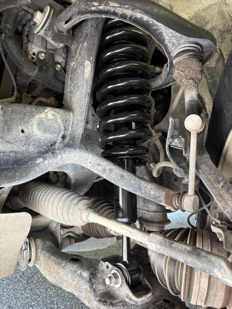

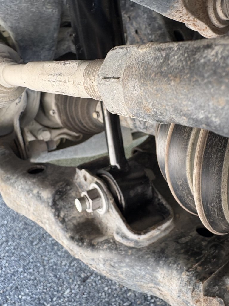

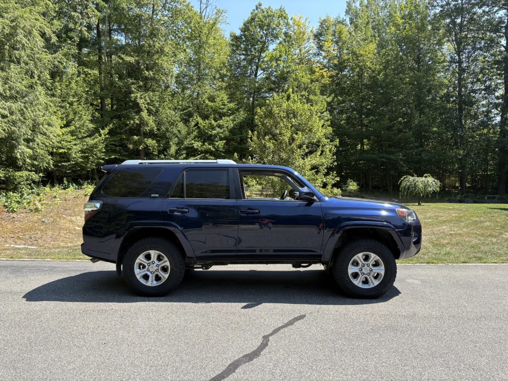

    Took a while to post these. Been trying to use my late summer Saturdays wisely......smoking ribs, swimming and having a few cold ones :)
    Uploading some photos of the struts, but they're not that informative, at least from what I can see.
    I have checked to be sure the spring ends are in the correct locations of the bottom plates and they look fine.

    Hate to say it but that's worse than a 3rd Gen rear spring sag...can you post up some pics of the rear suspension?

    that front is not stock replacement height coil/strut set up. Looks like they gave you lift springs. Can you see if there’s a part number on the coil? This is what my 2022 look like new (under 300 miles) with stock front suspension and factory 265/70/17 before I did the lift and bigger tires.
    you have much more of a gap from top of tire to wheel well lip

    6,382
    The rear ride height is perfectly stock, maybe a bit higher than stock. You can see it because of the trailing arm angle. That angle is right where it’s supposed to be for a stock setup, just a little bit more angle than parallel to the frame. In fact, most stock SR5s I’ve seem have trailing arms completely parallel to the frame.
    The only reason the rear looks too low, is because the front is way too high. I agree with the OPs concerns, the new coils made the front ride height way too high.

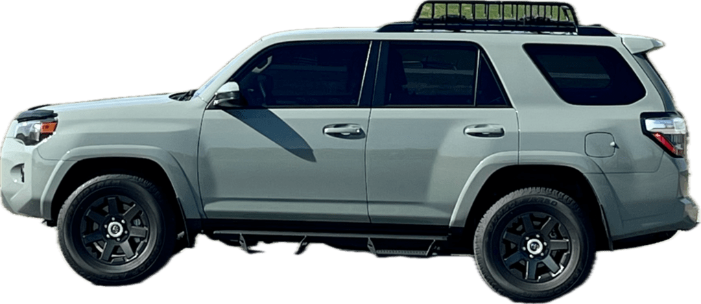

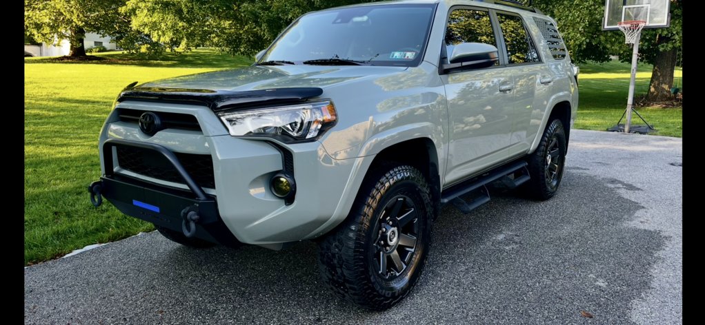

    well I believe they did because I sent you a picture of my stock 2022 trail special edition when it was brand new and yours is significantly higher
    here’s what it looks like lifted. Which is in more in line with what you have going on right now

    I don’t buy their explanation, even brand new like in the picture I showed you, my 2022 was not as high as yours.
    i’ll let others weigh in on this
