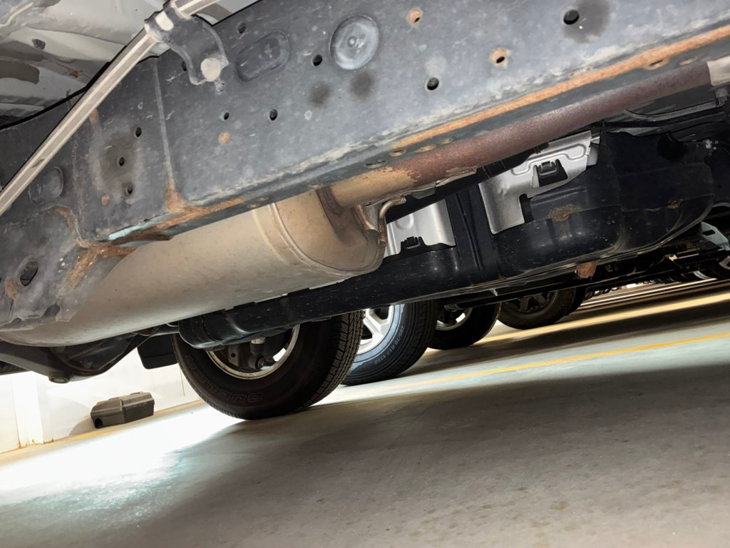

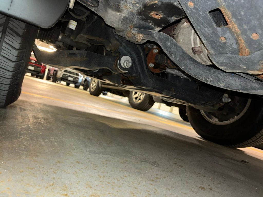

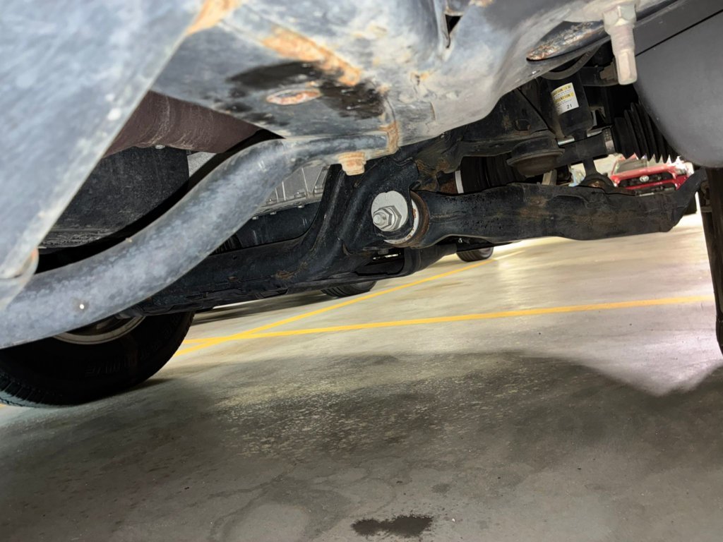

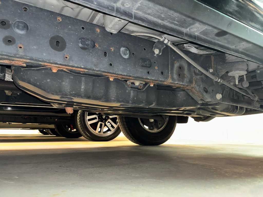

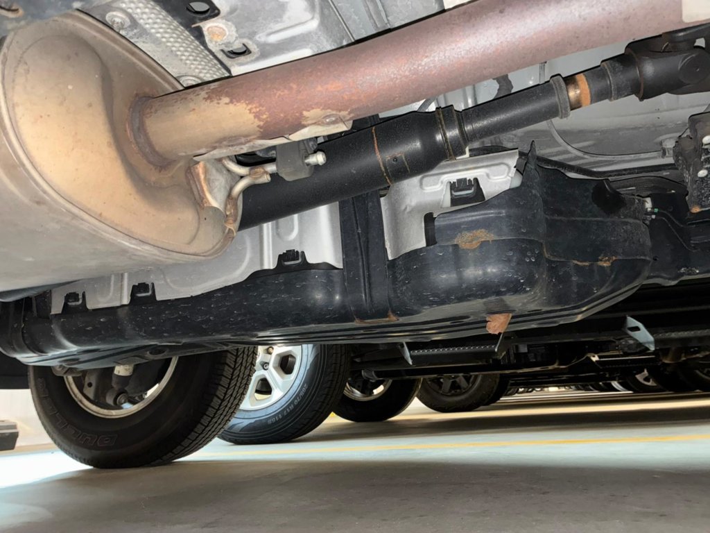

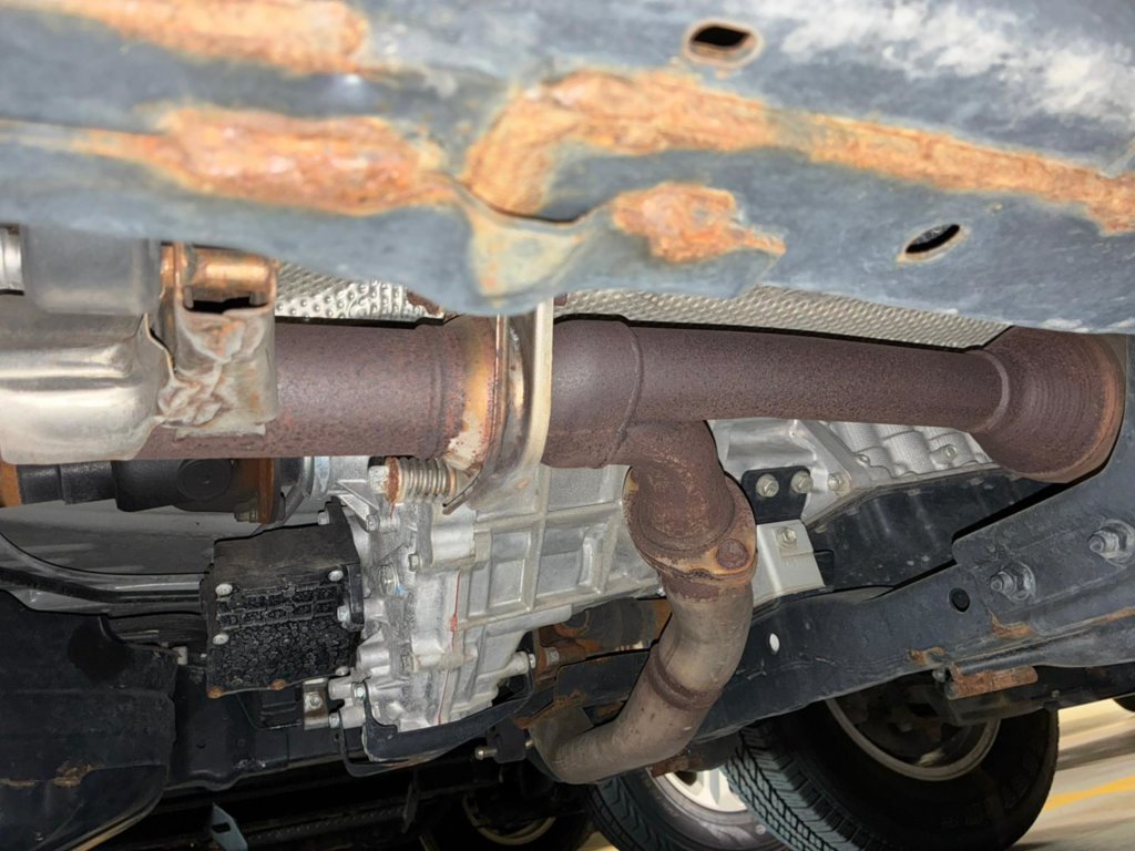

    Hi All, I'm in the market to purchase a 4Runner, and after many weeks of research I was about to purchase this 2022 SR5, until I looked at the frame and saw the corrosion. Can you folks please help me figure out if this is easy to treat and prevent further corrosion?

    Welcome. Not the worst I've seen pics of. Should be an easy treat.

    It's not beyond help, but will need attention to keep it from degrading any further. Where do you live? The urgency depends on the environment.

    Thanks for the input! I live in Boston area and commute to New Hampshire on a regular basis through winter and fall. The road often is treated with salt! What concerns me is to purchase this and figure out it would cost too much to fix the corrosion and prevent it from progressing!

    Welcome from Wisconsin! The rust you're showing is very treatable, take care of it now before it's too late.

    You don't even own the vehicle yet? If you're considering buy it, have the seller treat it for you before purchase. If they're unwilling, it's then a bargaining chip on price. If you're driving in the NE in the winters, you're going to have to maintain the frame on a yearly basis. Get used to it.

    For salt belt vehicle that has not been treated it's about right for it's age. Would it dissuade me? Nope. Would I use it to knock $500-$1000 off the asking price-yep. Then I would fluid film or similar coat it as soon as I bought it.

    Also consider rust inside the frame rails that is not visible. You can borrow a fiber optic inspection camera with a pencil diameter cable that self illuminates and you see the pic on a screen. Usually you can take photos too.
    I got one on Amazon that does a good job for my several uses, mostly looking inside walls thru small hole I drill. Also looking into 1950 shower manifold at valve seats. Some users look into combustion chamber thru spark plug hole.
    You could easily see into frame rails for hidden rust on those frame weld areas you see rust on outside

    Looks fine. Find some 2015 4Runners in your area for an idea of what a rusty frame looks like :laugh:
    Just take it for yearly rustproofing before each winter. Fluid Film, Woolwax, NH Oil, Krown, whatever. Avoid the rubberized shit from Ziebart, etc., those would be a death sentence.

    How many miles, how does it drive. Depending on those questions, I’d buy, treat with surface shield. Wool wax or fluid film would be good too, but Id start with surface shield before the first winter, then fluid film or wool wax in the spring. Then evey fall treat it. There are a good group of folks from the New England area that frequent Tacoma world, who would be a great help.

    I noticed your post and imo, patience always pays off. I would not buy anything that rusty. I would patiently look for a better one, and treat it with rustproof chemicals every year. It is a must. Especially if you live in a "salty environment". If the owner of that vehicle did not bother with rust prevention, what else has he omitted?

    No big deal. I would say that's "normal" after having owned a 5th Gen since 2015; it will look like that if you live in the rust belt and don't coat it regularly. I prefer the gooey oil spray and do mine once a year.
