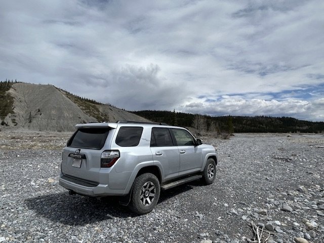

    3,607

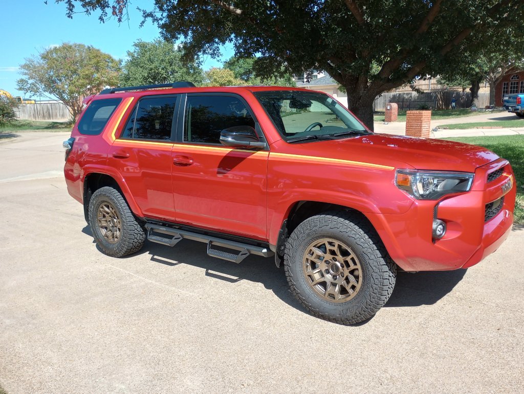

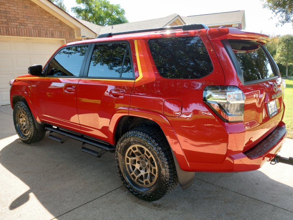

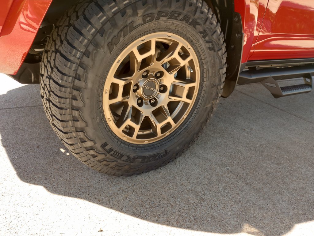

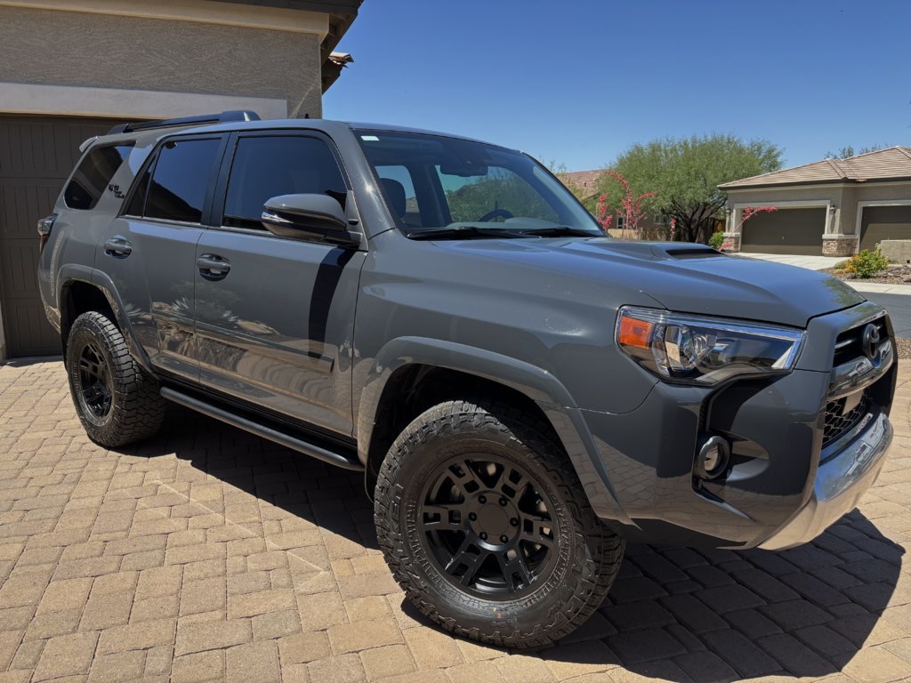

    You want pictures? Here you go: I stayed with the stock size.

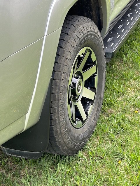

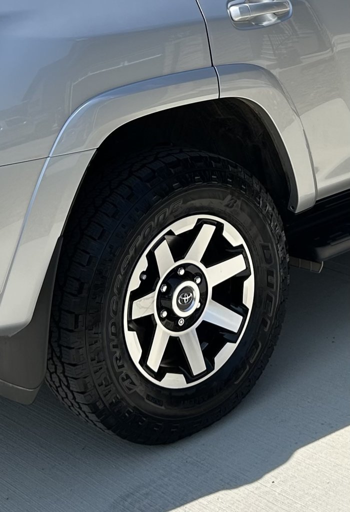

    I provided a couple detailed posts about tires you might (or might not) find interesting. In short, I landed on the new Bridgestone Dueler A/T Ascent tire because it very effectively handles both paved and off-road conditions. The Ascents are just OK in snow so I wouldn't suggest running them all winter unless temperatures and conditions are moderate. They're fine during shoulder seasons where I roll but Blizzaks are needed for most of the winter.

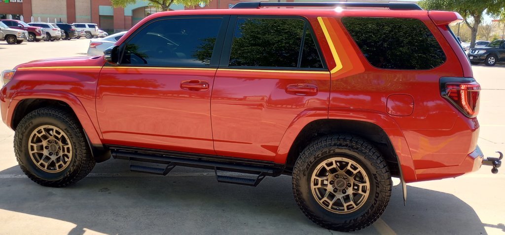

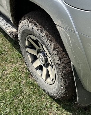

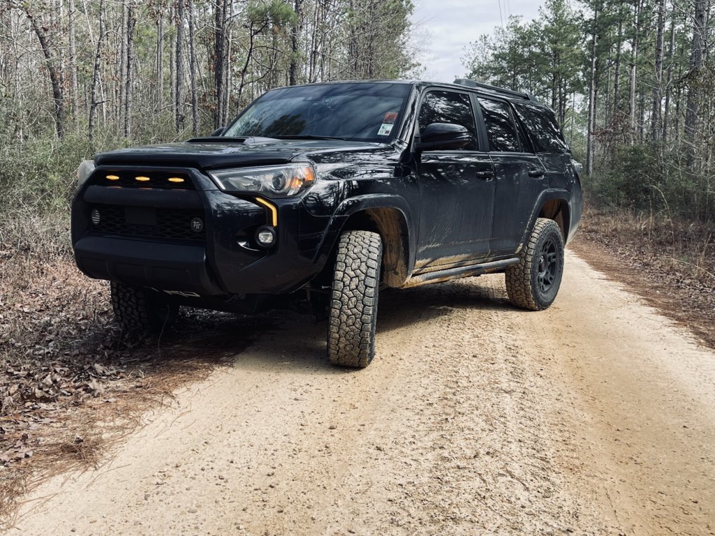

    I used to run stock sized BFG AT KO2’s, but changed to stock sized TOYO Open Country ATIII’s. Really liking them!
    roooo, ChessGuy and Captain Spalding like this.

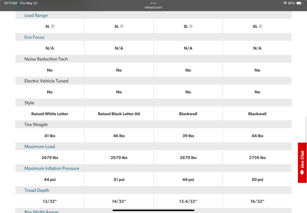

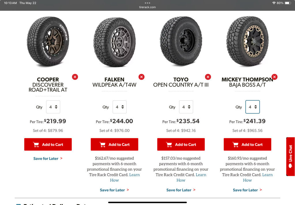

    I'm in the same boat here, looking at 265/70/17's - AT design. My list, leaning towards the Baja Boss's as the 4Runner is my fun car. The Cooper's are the sensible choice it seems, but if I was to go on a local offroad ride around Southern Ohio/Kentucky I would need something that clears mud well:

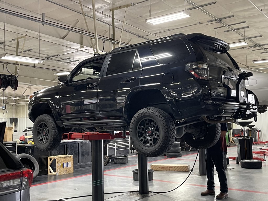

    Just completed this same journey myself and landed on Falken AT4W in 265/70/17 on FN FX Pro wheels (17x8 with 0mm offset).

    Good Year Duratrac RT's in stock size, fantastic tire in all conditions and with Kevlar. And borderline Mud tire without the noise and poor traction in normal conditions.

    Gulo may I ask how the road noise is on pavement with the Bridgestone A/T as compared to the stock?
    I have the Standard Bridgestone Stock tires now (not AT) on my 2024. Your tires alone make the 4R look more aggressive. I only drive my 4R in summer so winter driving would not be an issue

    Road noise in the city and on highways with the Dueler A/T Ascents is barely noticeable.

    I plan on some really long drives, so not sure Mud terrains are ideal for those trips? I guess I would think they'd be terrible on wet roads, which we have a lot here in Southern Ohio, we get more rain that Portland, but it comes down much heavier!
    Trying to split that difference of good road use, and yet decent on mild trails. My guess is any of the tires I'm looking at will be fine, may be suffering from self caused analysis / paralysis :)

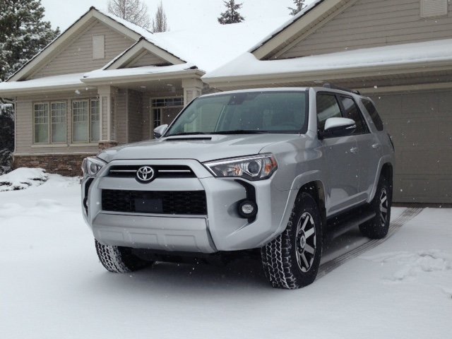

    This looks like the vehicles we saw all over the place when we visited Iceland. Talked to one woman who had a simply massive Ford Excursion kitted out with giant tires like this and she said it was for driving on the glacier.

    Ordered some Open Country AT3's today (SL). My stock Dualer HT's are all at the wear marks, not so great in the rains we've been having. I'll give the Toyos a go for now, see how they do - seem like a good fit for my needs, liked the fact they are a bit lighter weight too.
    Thanks for sharing your post/photos, appreciate the insight. Nice looking 4runner!

    I’m liking them more than my previous BFG’s.
    I’m running LT265/70R17 Load Range: C
