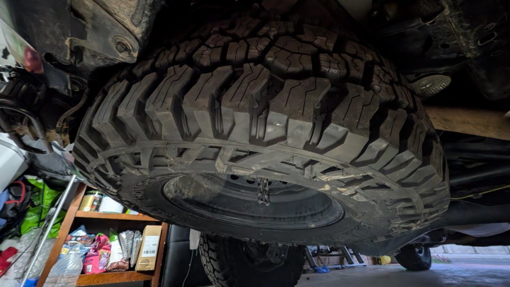

    So I have a 2021 TRD PRO and am in the process of getting a Wescott Designs lift kit installed (just shy of 2") with Mickey Thompson AT Baja Boss tire 285/70/17 (32.71", 11.22" height, 7.85" sidewall).
    The shop (mostly a jeep shop) is telling me the spare will not fit in the undermount location. The stock size of tire was a Nitto Grappler 265/70/17 (I originally listed it as 275).
    I have TWO questions:
    1.) For anyone here have experience with fitting a 33" in the undermount position, should my new tire fit?
    I was not planning on getting a rear bumper to carry a spare, but may have to. The problem with a rear mount bumper and the spare tire hanging in the back, is the possibility that the tire and my trailer tongue box will bump, and limit my turning radius.
    2.) Does anyone have experience with trailers with a rear bumper with a spare tire situation that could offer some advice? TIA!

  7. Jun 13, 2025 at 2:58 PM
    CibolaLichen
    CibolaLichen [OP] New Member
    Dec 16, 2023
    #37311
    19
    New Mexico
    2021 4Runner TRD PRO
    Working on it...
    So as it turns out, even with the tire aired down, the 33" Mickey Thompson tire would not fit due to the hitch receiver.
    I am definitely in the market for a rear bumper now!! I need to find a hitch mount spare tire holder as a temporary solution while I shop for a rear bumper.
    Thank you all.

    Okay I am definitely going to investigate. I read about someone doing that in another thread. As soon as I get my vehicle back from the shop...
    I appreciate you Airdam!
  10. Jun 13, 2025 at 9:35 PM
    CibolaLichen
    Dec 16, 2023
    #37311
    19
    New Mexico
    Working on it...
    So you were correct! Except it was NOT interfering with my hitch receiver AT ALL. I got it back today (hubby had to pick it up for me) and I got under there and checked myself. It fits. What the hell...
