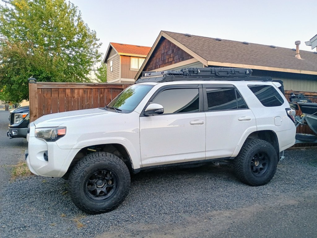

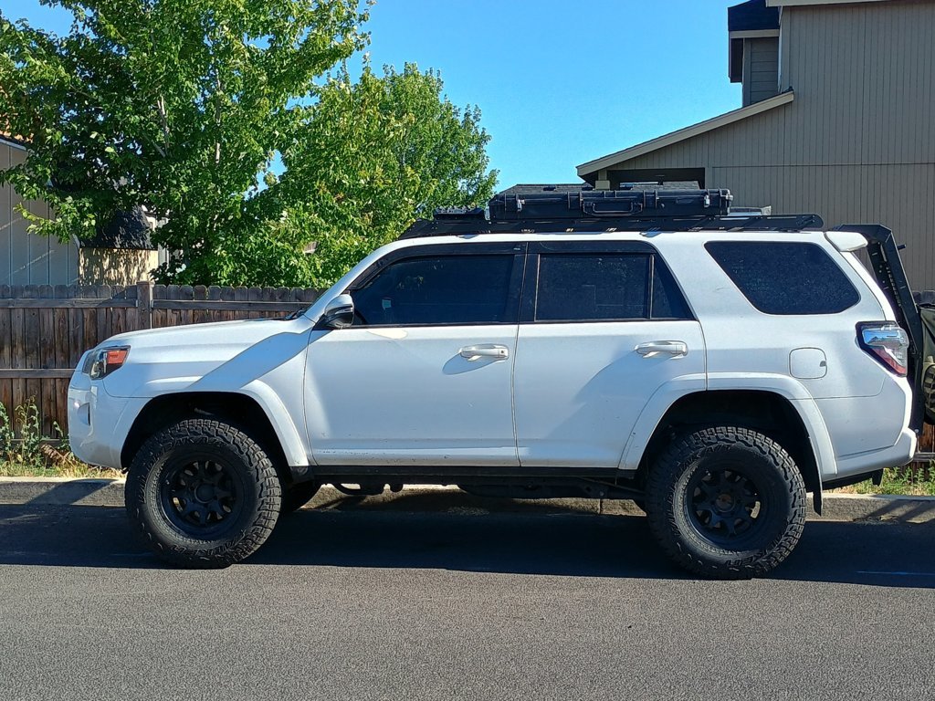

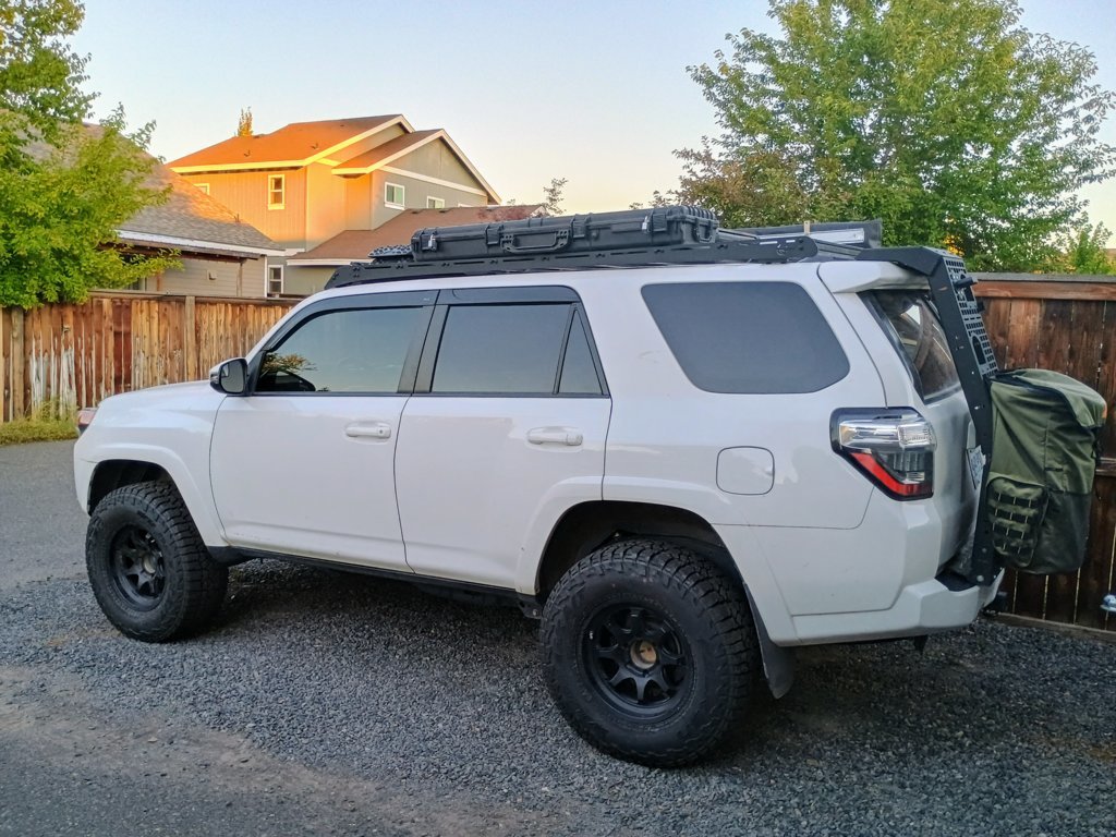

    Got a tad too level / squatty for me in the rear towing my boat or camper, which I do one or the other weekly. Previously Dobinsons 300 front and 599 rear. Bumped the rear up to a 505 and now have about 1.5" of rake. I like rake much more than level or rear squat.
    Tossed on some 285/70-17 Wildpeak AT3s today as well. -18 mm offset wheels. Love the stance and look.

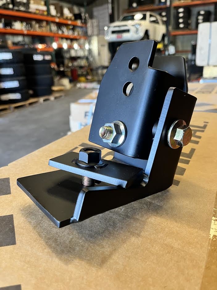

    I did a BMC and bumper trim as well. No rubbing. I will be welding on a panhard correction bracket shortly as the axle is slightly offset to the passenger side and bar is not level as expected.
    Coming along!

    I think you may have that backwards. The weld on kit is 1 piece. The KDSS is multiple bolted together and over 2x the cost. And I like welding :)
    https://eimkeith.com/products/03-4th-5th-gen-4runner-panhard-correction-kit-pck®?srsltid=AfmBOorBe2CP3v6Aap6O933xtSEyFG9Uf_ZYxKlXK7qiLcWA8GWTUaZg
