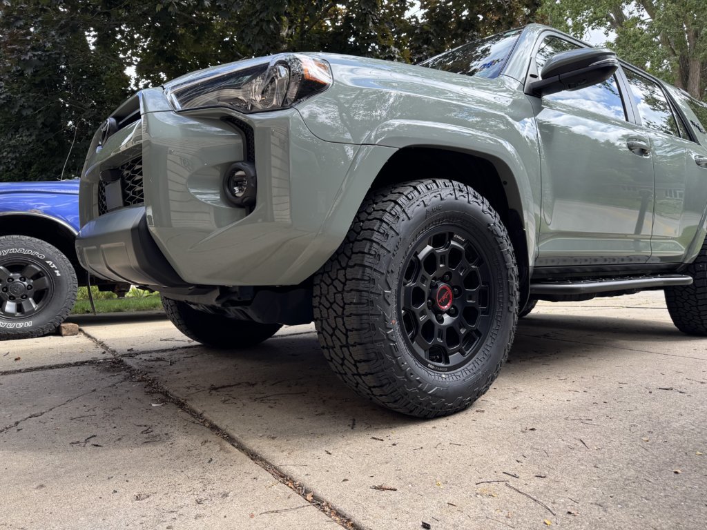

    Hey everyone!
    I saw a post of someone installing the new Tundra BBS Forged wheels on a 5th Gen 4Runner. Does anyone know if this is a direct swap without any modifications? Picture below for reference.

    Here is a close up pic.

    Hubs on our internet disappointing Tundras are 95.1mm vs 5th gen 106.1mm center bore. I assume they used adapters
  4. Jun 4, 2024 at 10:34 AM
    wax poetic
    wax poetic Raking like a mofo
    Mar 28, 2023
    #32027
    638
    21 Super White TRD OR
    The other thing is that they are 18's I believe, so you'd lose a little sidewall if you care about that.

    You mean spacers? The caliper looks very close to the rim, so I'm not sure if the person used spacers.

    Has to be spacers unless user had center bore widened.

    Most definitely has spacers. Tundra offset is like +50 or more.

    BBS are 47.5mm

    I think @siblu was referring to hub centric spacers. They're used in applications where the diameter of the truck's hub is smaller than the diameter of the rim you're looking to mount.

    So the tundra trd pro wheels are +47.5mm and the 4runner trd pro are +4. You'll definitely need 1.25"+ wheel spacers. They are nice wheels though.
