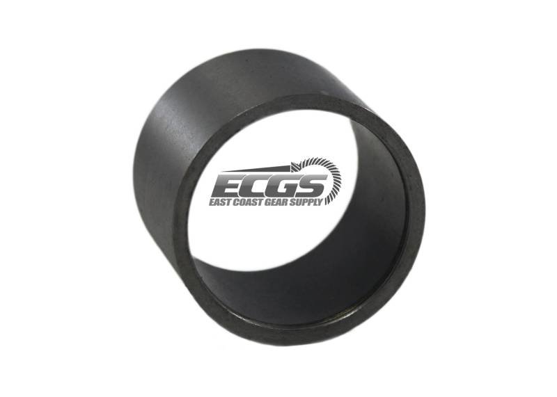

    As others will point out, if it is your needle bearing the only permanent fix is to replace it with an ECGS bushing. And as Dillusion said, next time you feel it put it in 4H and see if it goes away.

    If you already got the diff replaced for the bearing sound, that will give you an idea of how long the next one will last, assuming toyota changes it out again for you. But in reality, they could put a new bearing in and it could still make the sound immediately.
    If you ask me, it’s not worth the hassle. Change it out for a ECGS bushing. Or do like me and keep your 4runner dirty, let your tires get loud, and enjoy the womp womp womp lol.

    I have done it both on the taco and the 4R. I can tell a big difference on the taco and there are no vibration issues, but at 60mph on the 4R I still have a little play, the only way this play goes is by constantly rotating the tires and doing the road force balancing thing. I say the moment we start lifting our vehicles, we just create too many different angles and gaps so things will shift eventually. ECGS bushing is a good product I think.
