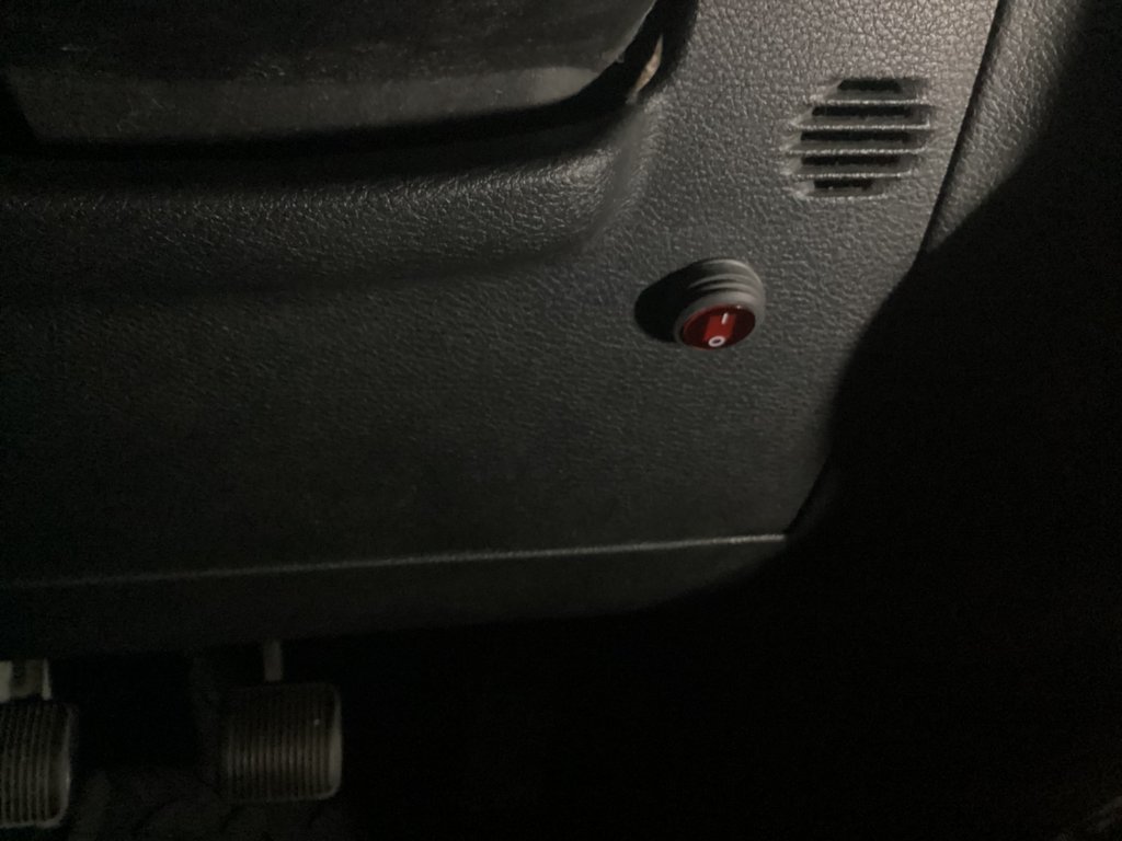

    Does anyone know what this button is / does?
  2. Aug 24, 2025 at 8:02 PM
    Inyo Runner
    Inyo Runner New Member
    Oct 24, 2024
    #43547
    39
    2024 trd off road premium
    Ejector seat

  3. Aug 24, 2025 at 8:03 PM
    Inyo Runner
    Oct 24, 2024
    #43547
    39
    Looks like for auxiliary lighting like driving lights
  4. Aug 24, 2025 at 8:07 PM
    2Toys
    2Toys Imperial Star Cruiser
    Jul 6, 2020
    #15337
    1,807
    Gordon
    2019 4Runner TRDORP
    That does not look like a factory installation. When switched on, does anything turn on? Like maybe grill lights, or ditch lights? Is there a compressor mounted under the hood for airing up the tires when four-wheeling?

  8. Aug 24, 2025 at 9:03 PM
    Thacrow
    Thacrow New Member
    May 30, 2021
    #21719
    1,888
    2021 ORP
    Speed holes
    Usually a self destruct, when it's in that location. I think that arms it and the blow up button is somewhere else.
  9. Aug 24, 2025 at 9:33 PM
    Texoma-Brad
    Texoma-Brad OK Yota
    May 18, 2022
    #27109
    374
    Brad
    Texoma USA
    Not a factory button. Agree with above Follow the wires to see.

  12. Aug 24, 2025 at 10:00 PM
    6,288
    And he could have clocked it to 12 o’clock, but that was too much work. ;)
    Seriously though, it could be a kill switch. What it kills is anybody’s guess, I wouldn’t touch it.
    Ok, Seriously seriously, @Caedmon, check the fuse box under the dash by the parking brake to see if it has a piggy back fuse tap in one of the slots. If it does, it’s probably wired to a relay under the hood. Look under the hood for a relay somewhere that looks out of place, then follow those wires to the aftermarket accessory it’s powering. However, it could be the accessory was removed already.

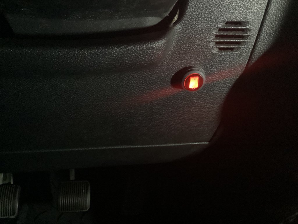

    Caedmon
    Caedmon [OP] New Member
    Sunday
    #48680
    2018 4runner
    SR5 Premium
    LOL.
    Thanks everyone.
    I've toggled it a few times.
    No gremlins, bombs, or covenant elite. Nothing noticeable happens.
    The Carfax report DOES show nitrogen in tires, but I have no idea how that works.
    Nothing in the carfax report tells me what might have happened.
    I will try to follow the wiring the best I can.
    I will post my results.
  19. Aug 25, 2025 at 4:53 AM
    4RunRap556
    4RunRap556 New Member
    Aug 19, 2025
    #48594
    9
    Way up in New England
    2020 4r sr5 silver
    None yet
    Tires just have nitrogen in them. Supposed to not fluctuate like air.
    they may have removed whatever was attached to it. So now its a free toggle switch for whatever lol

  21. Aug 25, 2025 at 6:21 AM
    1,409
    That's what I was going to say. Toggle the thing and try to start the vehicle and see. If it doesn't then it is wired into the fuse box system.
  22. Aug 25, 2025 at 6:30 AM
    Curlystooge
    Curlystooge Member
    Feb 10, 2022
    #25595
    260
    Flyover
    2022 limited in magnetic grey
    As Inyo noted, usually auxiliary light. Cheap lights come with a wiring harness with a button that looks like that. It usually lights up when powered on. Yours may not be connected any longer. I guess I don’t give an F about my wrangler.IMG_0269.jpg IMG_0268.jpg
