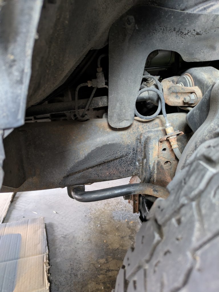

    So I think I mentioned earlier but in doing my homework I manually curated data from every N60 auction back to Jan 1 2024 and read the entire comments sections on maybe half of those. One thing that gets to me is "corrosion is noted on the undercarriage". When they say this they're referring to surface rust. Obviously most trucks have Class 1 surface rust underneath and that's not a problem, but this "corrosion" thing is called out kind of haphazardly. Some trucks with surface rust underneath get labeled with it, some don't.
    Now if it was up to me I would wire wheel and paint underneath the truck. But I asked all over the internet and uniformly people said "no, that's shady". So what to do? I'd like to remove the surface rust but keep the original paint for protection.

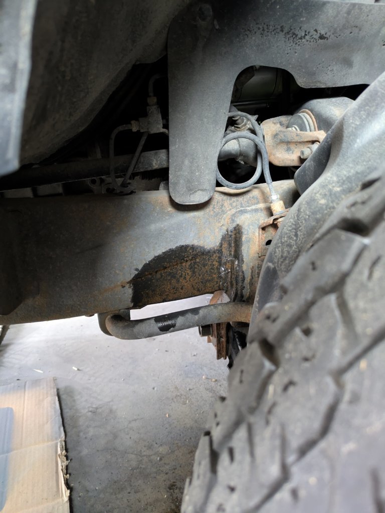

    I purchased this product called evaporust maybe a month ago. Taking a quick break from taping and final steps before primer, I just tried it out with the aid of a Dremel wire wheel and I'll be damned if it doesn't take surface rust right off without touching the paint. Now the question is, is the wire wheel necessary or would that 3800psi pressure washer I got blast the stuff off? A wire wheel on a larger tool feels like it'll take the paint off. I may need to find an in between solution.
    After initial spritzing with evaporust
    Waiting a few minutes then lightly scrubbing with Dremel wire wheel. Not 100% but I'd say pretty damn good!
    For the record, should I give the full undercarriage the evaporust treatment I will also be including before pictures as the internet seems so touchy about that
