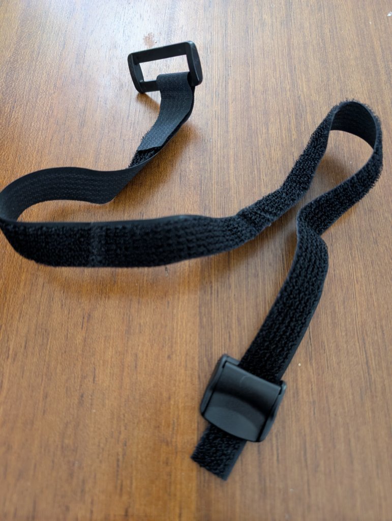

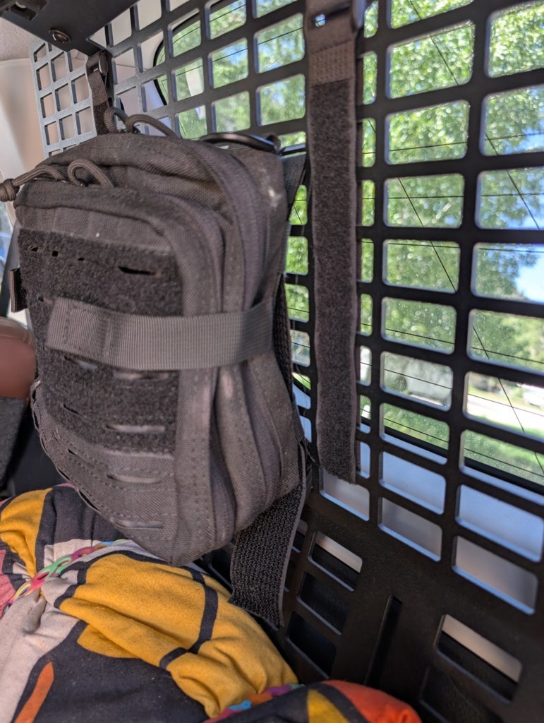

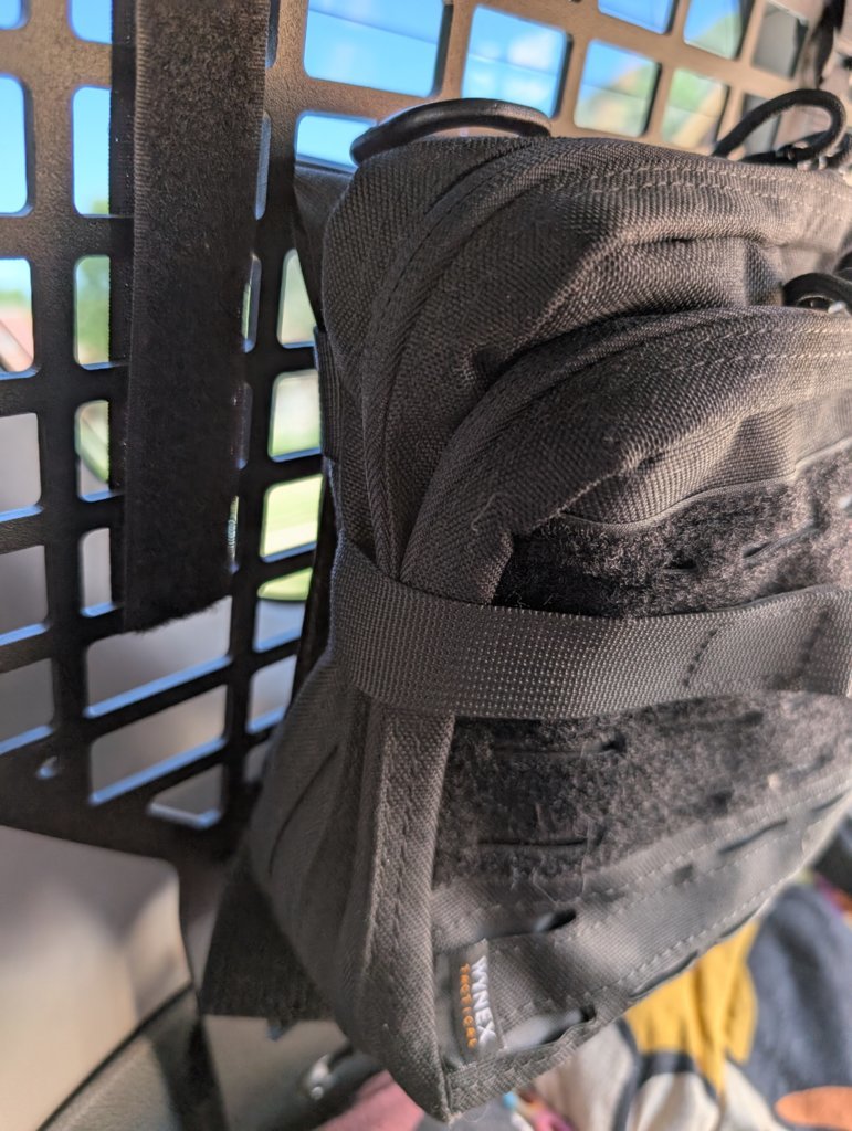

    To further my frustration with molle panels, I've come up with a decent solution that minimizes the time to attach and remove stuff from your panel.
    Parts list:
    Velcro and clip (clips come with Velcro)
    Slide buckle or cam lock buckle thing

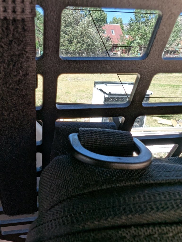

    You take the Velcro and run it through the clip. Attach Velcro to itself. Slide this through whatever you want to attach. The clip now can just slide through the molle hole and acts as the top end. The Velcro extension sticking out of the bottom of whatever you are attaching just has to go in and out of two molle holes below. You then run the Velcro through the buckle (which I only show in the close up with the bag), pull it tight and attach back on itself. I tuck it up under the bag and the part that sticks out is my quick release removal.
    It's very possible my description is terrible. I'll just vouch for this being a super quick install and removal. Stays tight with the self attaching Velcro. I wanted the 2" clasp similar to the photo however it was gigantic.

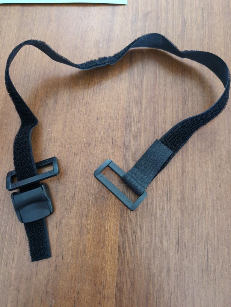

    Alt method. Second photo showing a clip at the top and bottom: Use the smaller cam lock buckle as shown in the photo and use a 2" clip to create tension before clasping.

    I hope it makes sense. I did a terrible job of capturing how the clasp works. The cam lock is probably the best method for ease of use but I didn't like having a separate clip bobbing around. The 2 inch slide buckle works really well because it doesn't slide back through the hole and kinda holds itself as you run the velcro through it. I think the key is the cool velcro that is both hooks/loops. That really helps.
    One thing I didnt mention. On the bottom of whatever you are strapping, you do need to go in and then out of two molle panel holes. This may be obvious, but just wanted to mention it.

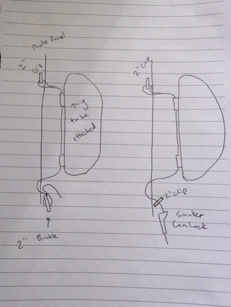

    Drawing for clarity.

    Thank you for the drawing. The two inch clip at the top. How is that secured to the Molle or is it that the 2 inch cant "pull through" the molle
