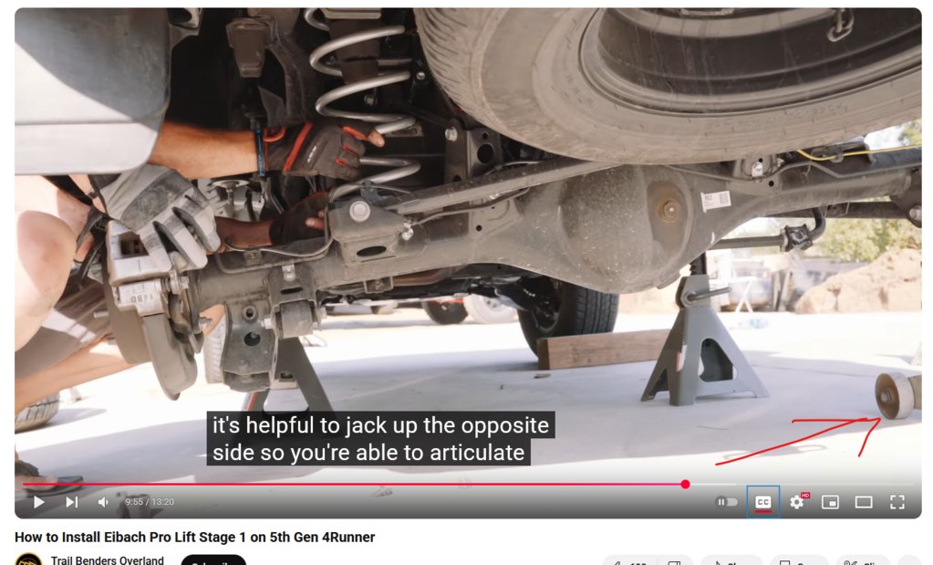

    Me and my buddy installed pre-assembled coil overs on one of my 4runners, rear shocks and springs. With that experience I would definitely let a shop with a real lift do the install with alignment. Especially lifting one side of the rear axles to get in the springs on the other side was a little risky job just with jack stands to my eyes.

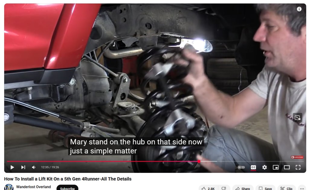

    Not my pic but this is how we did. For me who is doing it for the first time felt risky. Don't want to do it again.

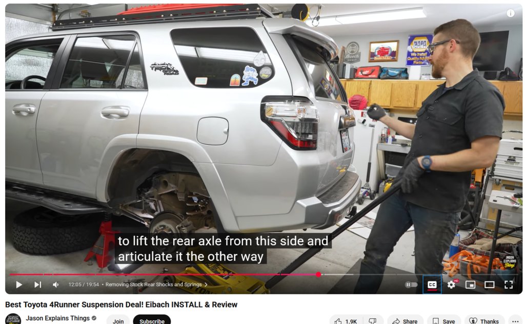

    Really weird way to install springs.

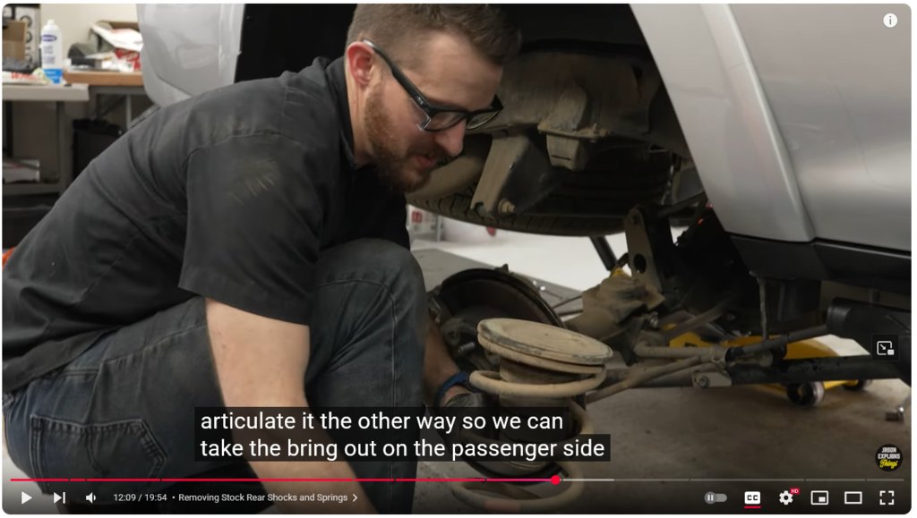

    Nope, Not weird at all. See below;
    1) This video shows the way me and my friend installed the springs. Lift the axle from one side
    2) And another video using the same method I used. So not weird at all. :p:D

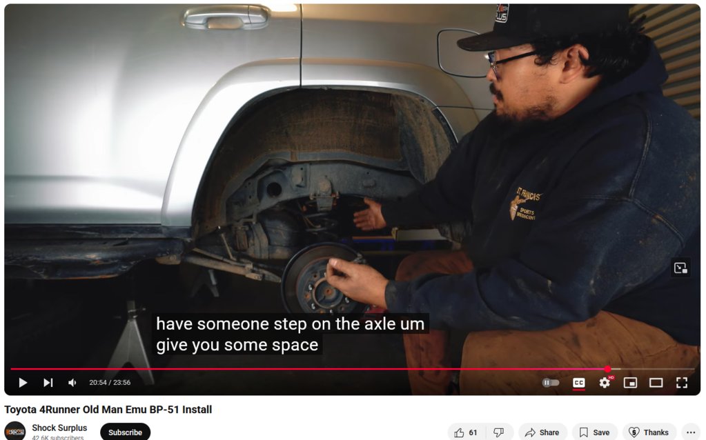

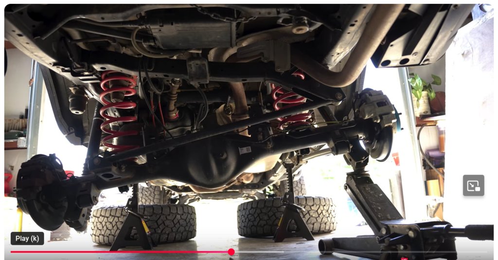

    3) It was much easier than this method;

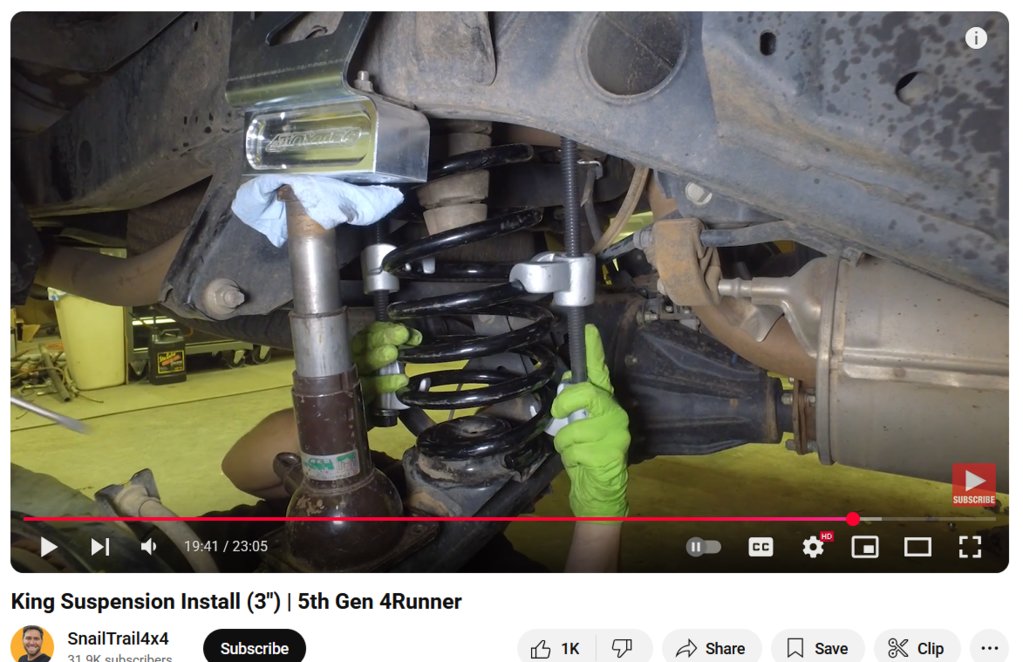

    4) In this video he says he asked his wife to stand on the hub. Also to note I don't have spring compressors like in both these videos use.
    5) Even this video says have some one step on the axle. I try this and I did not feel safe. Then went with the jacking up one side of the axle method showed in my previous reply.

  22. Sep 5, 2025 at 7:31 PM
    3,456
    ^Those Youtubers did it to "save time". Just loosen the bolts connecting the four links to the axle, the axle will drop free. The higher-end suspension kits involve upgraded link arms, so it never comes up as an issue.
