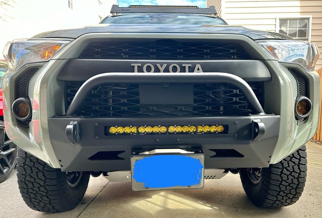

    I have the Victory 4x4 Blitz in aluminum for weight. I think this one and one from Greenlane are the only ones in aluminum. Pretty happy with it. Did modify the opening for the light bar and grill over the light bar. If you look at pics of the bumper of Victory’s website you will see their logo in the middle and blocking the middle of the light bar. To allow all the light through, I cut out the portion of bumper behind logo so bottom edge of opening is one continuous level edge and had a local shop laser cut a new grill piece without the logo. You can see in the pic now the middle of light bar is no longer blocked.
    JimBo58[OP] and TrailSpecial22 like this.
