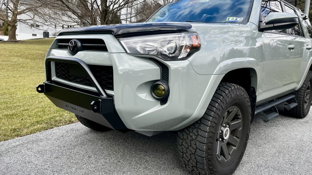

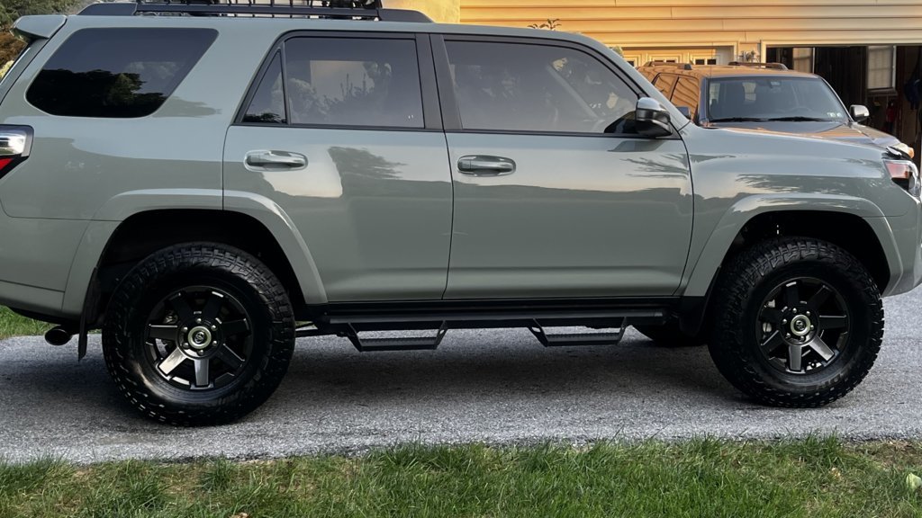

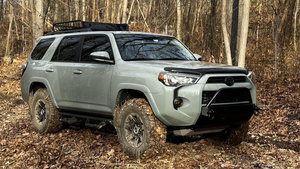

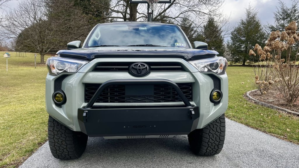

    I ride in 2 locations, the Rocky Mountains north of Boise, Idaho; and the Owyhee desert of Idaho and Oregon, to the south of Boise. I'm not a rock crawler either, and my fully stock 2024 TRD ORP could handle the mountain roads just fine with newly installed stock size KO2 tires. I did not encounter a situation where I wished that I had a lift. However, in the Owyhee desert, that was not the case at all. I was hitting rocks often, and dented the crap out of my stock skid plate, so I built my ORP to handle the Owyhee desert roads.
    With that said, here is a photo of mine with stock size KO2. I have a 2.7" lift in front, and 1" in the rear. I've since upgraded to 285s and if you're interested in pics of that, check my profile. Like someone mentioned above, sometimes you end up with a higher lift than planned, my plan was 2.5. lol I also have KDSS.

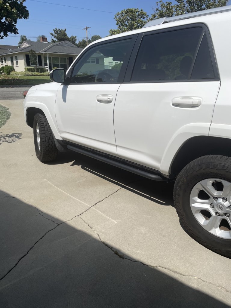

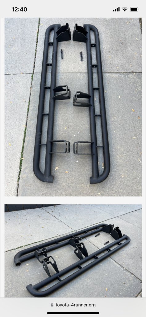

    Regarding rock rails I found OEM take offs for good price thru classified on this site. Seem plenty strong for my needs. Round tube 1/8" wall, brackets 1/4" thick steel. I like they are up and tucked under for rocker panel protection, my legs do not contact them getting out/in. They bolt into existing frame threaded holes.
