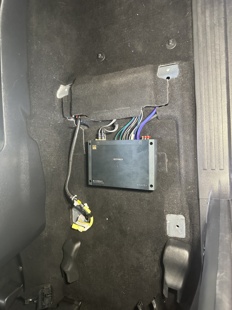

    Time for the big stereo upgrade.
    Keeping the factory head unit so going to add an amplifier under the passenger seat, a sub in the back (using the OEM JBL enclosure), and new speakers all around.

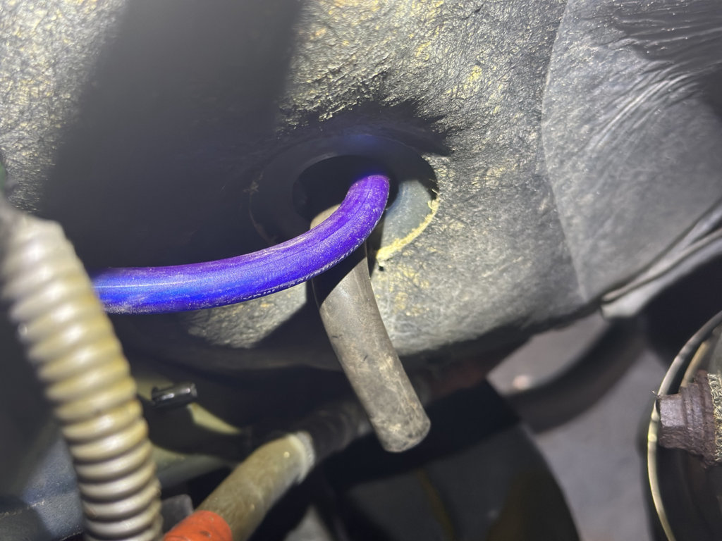

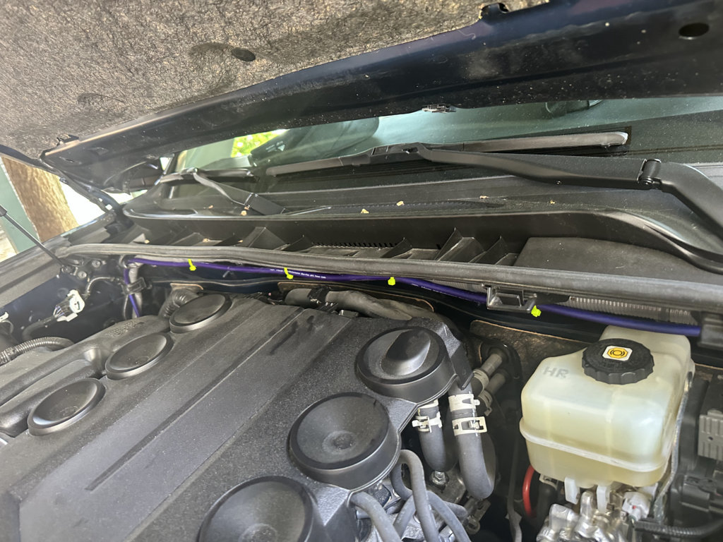

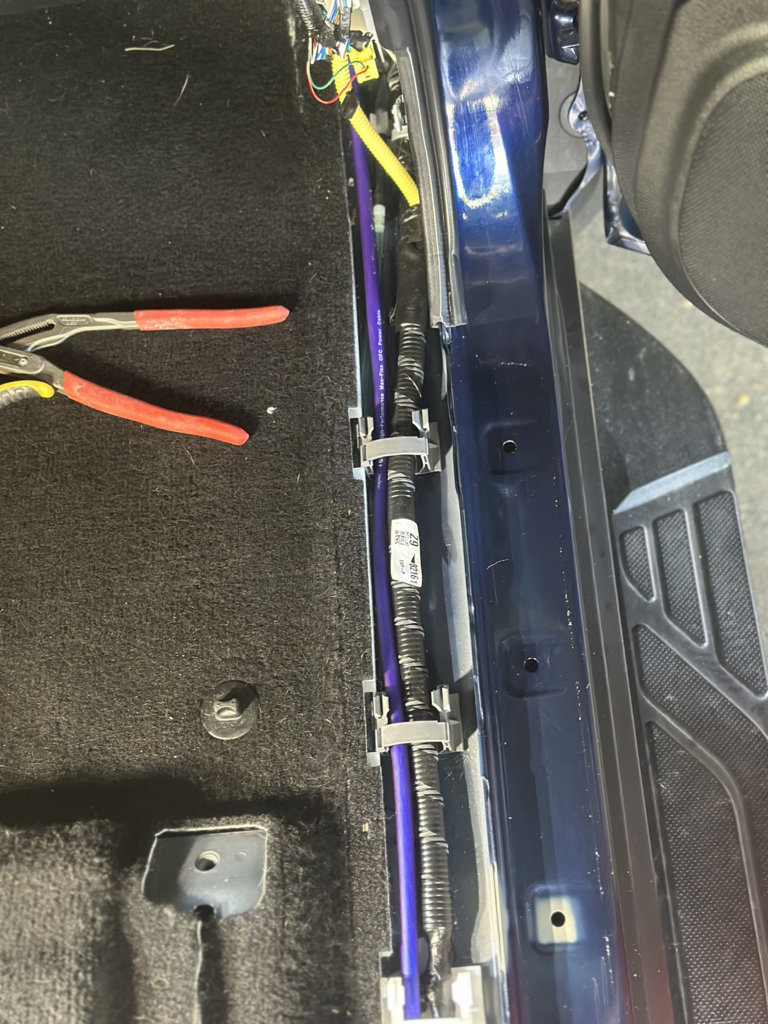

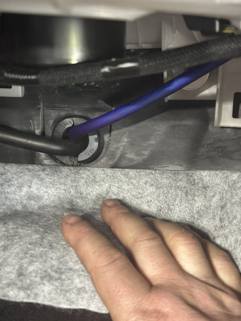

    First ran the 4 gauge wire from the battery and mounted the fuse right on the sidewall next to the fusebox. Ran the wire along some factory wiring over to the passenger side.
    Down the passenger side along more wiring and through the firewall where a hose pope through, looks like a drain/drip line.

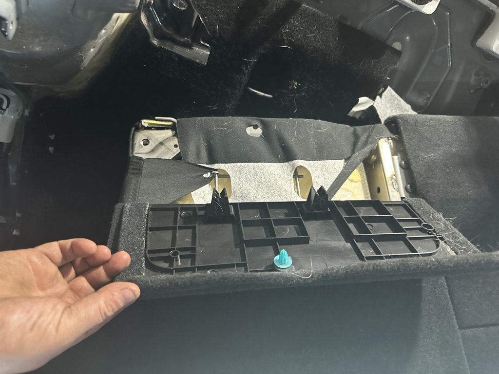

    Pull the carpet back in the passenger footwell and its a real easy grab.
    Gotta pop off a couple black trim pieces to get this far but its easy stuff.

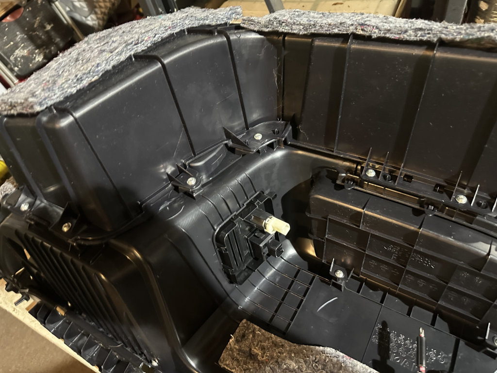

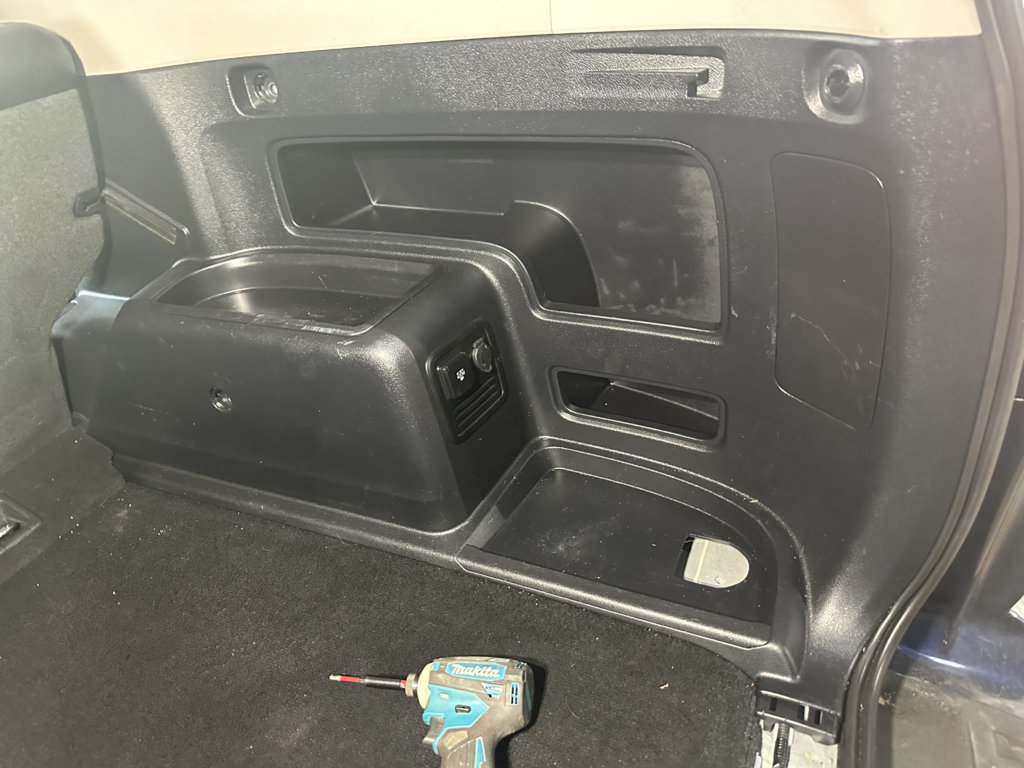

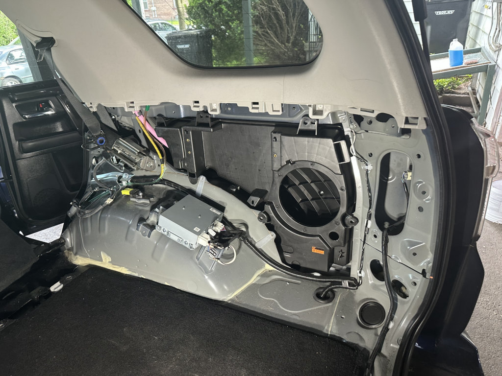

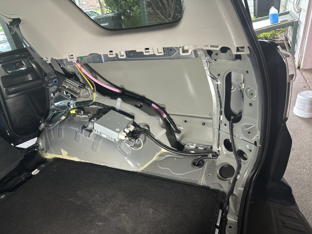

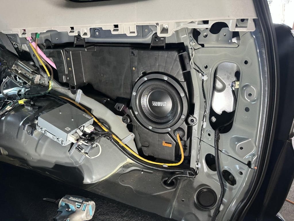

    The sub enclosure was a little bit more of a task:

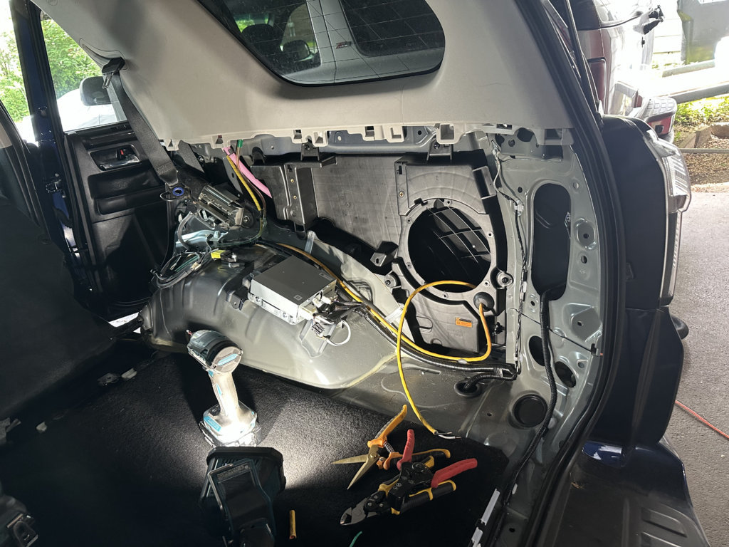

    Trim comes off, carpet gets pulled back, you gotta take out bolts and screws, the eye-bolts, remove the seat belt bottom mount, pull the back seat recline lever out and disconnect those wires.
    You gotta take out the back seat. That was annoying, but, turns out its just 3 bolts so was easy. This little hatch on the back of the passenger side rear seat give you access to the last bolt.
    Turns out it was easy after all.
    Finally got the panel off.
    Dry fit the sub enclosure. Goes in like a glove.
    Lets run the sub wire.
    That little rubber plug was for the factory sub and has the wires molded into it. Cut that off and drilled a hole for my sub wire. Don't judge my sub wire =)

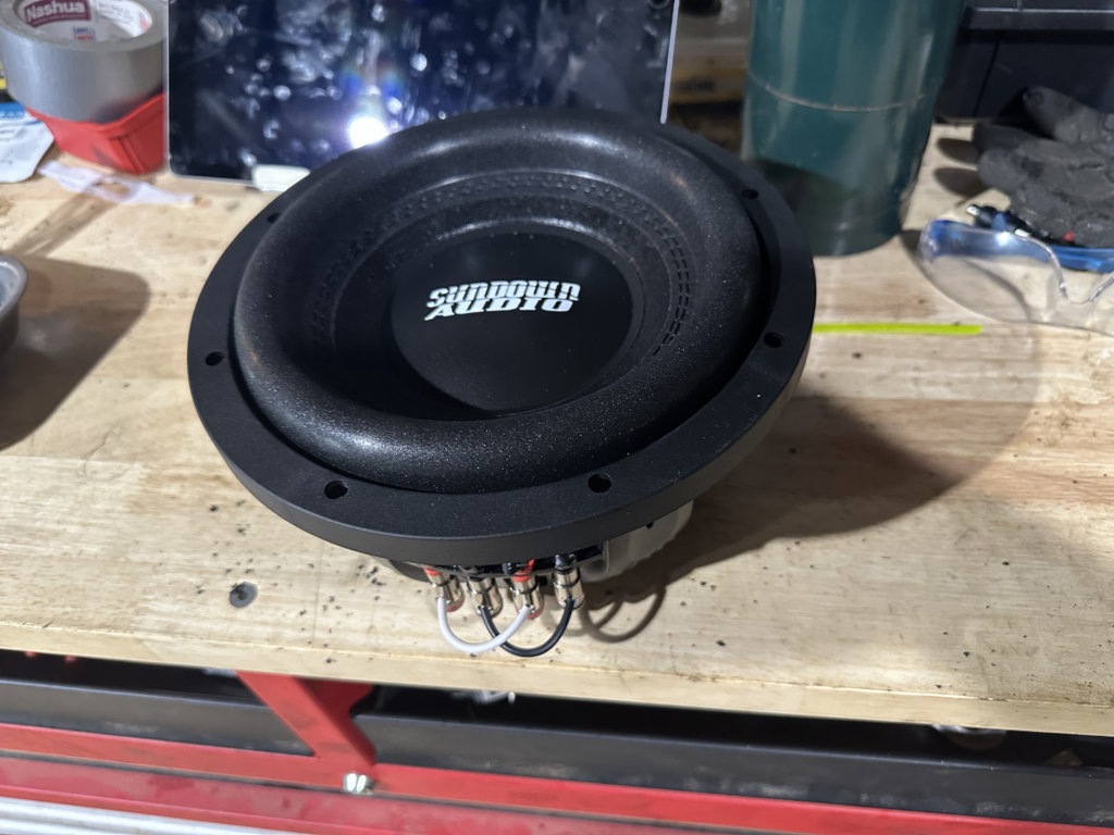

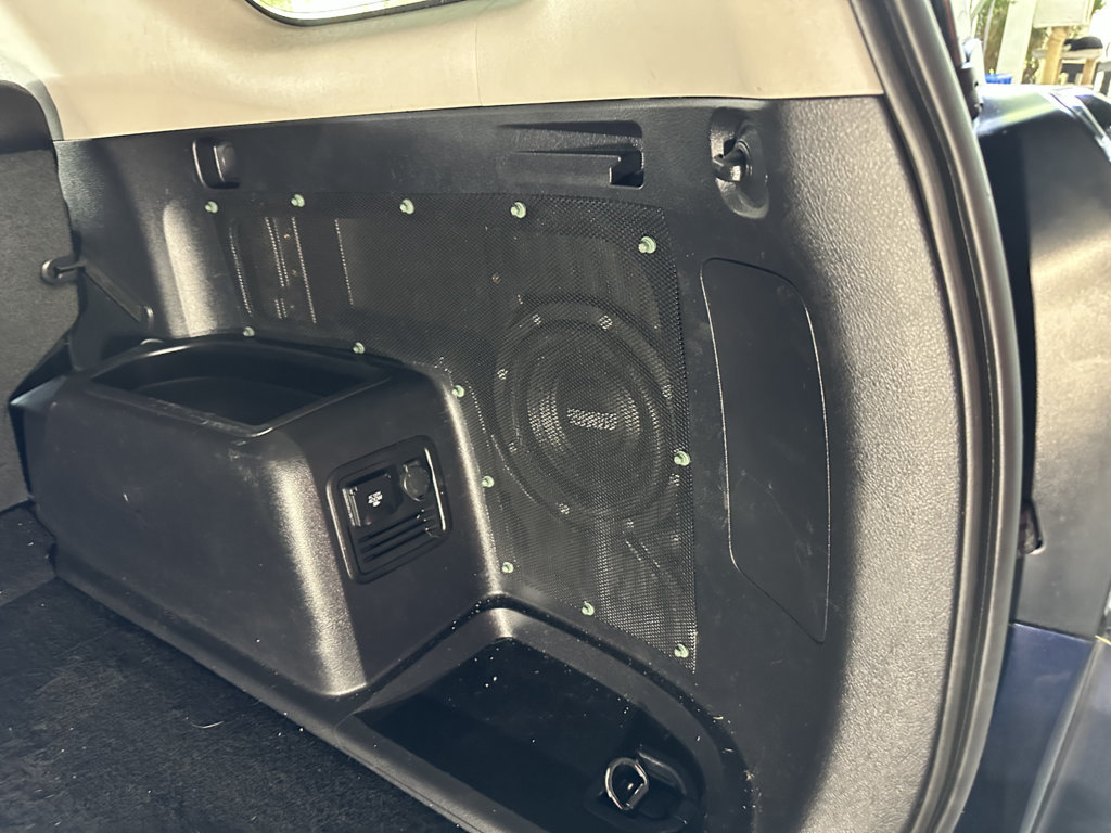

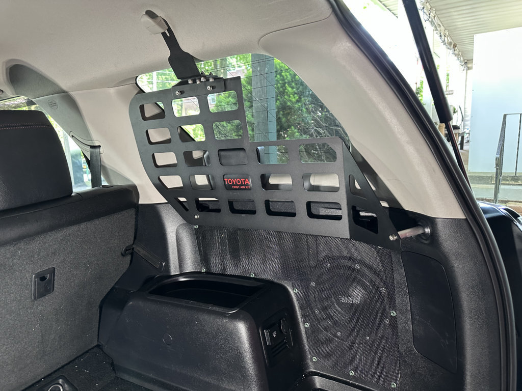

    The sub:
    Sundown DVC 4 Ohms so I can wire at 2 ohms.
    Wired and installed.

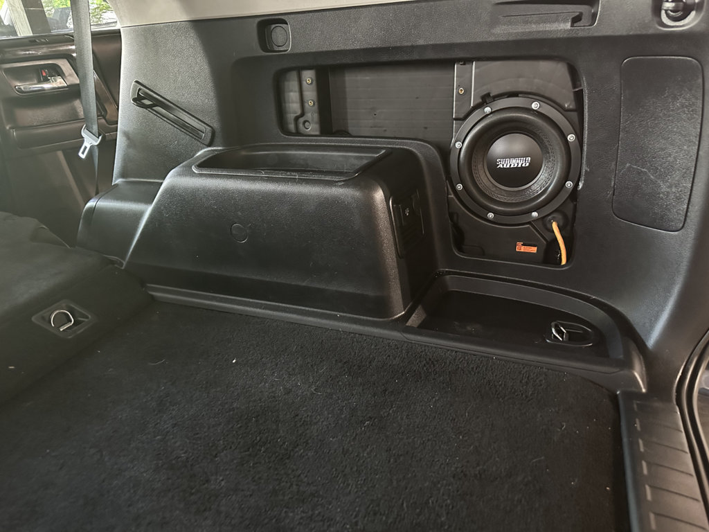

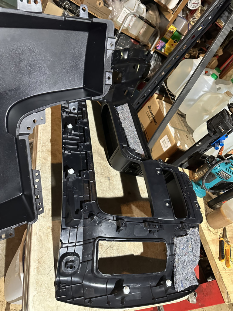

    Gotta pull all the cubby pockets from the panel. I heard there were plastic rivets but mine had easy to remove screws for everything.

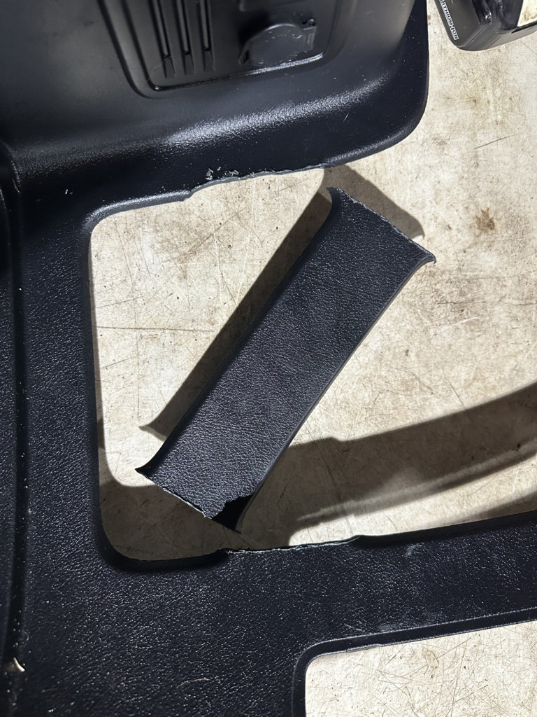

    With that out of the way went to put the panel back in and the bastard is touched the sub. I didn't want to cut the factory panel... but it was too late now...
    Broke my heart.
    But it went in and fit nicely now.
    Gonna get some aluminum mesh to cover the whole section.

    Yeah original speaker wiring, except for the sub which I had to run. I got the TacoTunes harnesses that divert the wires from the head unit. So head unit to my amp, and my amp to the factory wires back behind the head unit.
