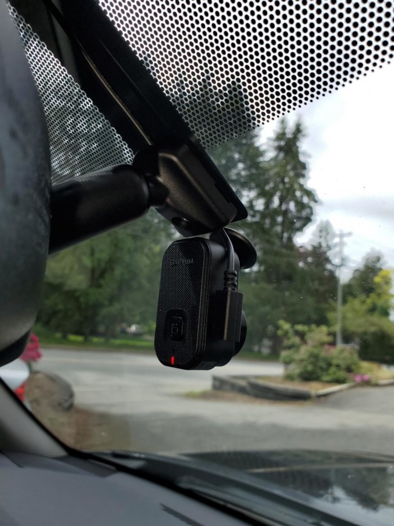

    I can tell you for the front, a Dongar adapter that taps into the auto dimming mirror is the way.

    The adapter mentioned does not provide power 24/7. It only powers the dashcam(s) when the vehicle is running. The upside of it is, it's short, easy to install and you can tuck it away relatively easy. Runnning a cable for 24/7 power (for parking mode), you have to snake a power cable through the head liner, down the A pillar and under the dash. Then you have to tap into a fuse.

    I went hard wired and did what was mentioned above to get 24/7 power in regards to shaking/bumping movement activation. Took around 35 minutes to remove and feed wires down to the fuse box. About 1.5 years with zero issues as of today.
